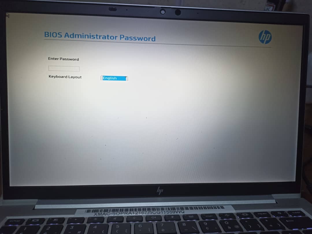

need unlock 835 g7
  • mesdova
    • Oct 2015
    • 24
    • algeria
    need unlock 835 g7
    need unlock 835 g7

    Re: need unlock 835 g7
    Originally posted by mesdova
    need unlock 835 g7
    are you sure you read it properly ?
    read again and then send
      need unlock 835 g7
      if you read it properly then post 2nd chip bin file
        That file's ok. It's EC file, can unlock with it.
          bios main 835 g7
              bios main 835 g7
              try...
              I don't provide help for people using CH341A and a clip.
                no work
                    hp 835 g7 and 855 g7 AMD rezen 5
                    problem is saved I found the solution thank you very much to this group badcaps
