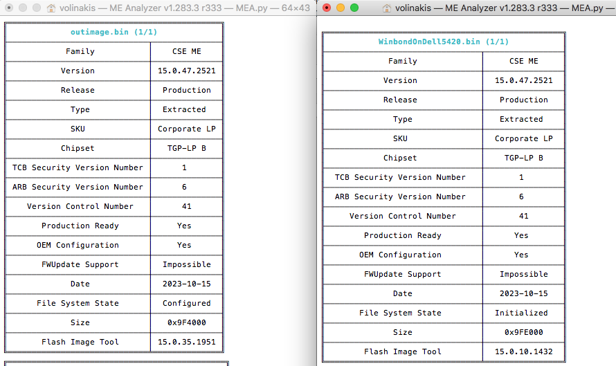

        Hello everyone.
        I finally managed to extract the BIOS dump from the Winbond chip.
        I analyzed the dump with the latest version of ME Analyzer generated from the Python sources and this is the result:
        ║ ME Analyzer v1.307.0 r348 ║
        ║ 2024.07.03-WinbondOnDell5420.bin (1/1) ║
        ║ Family │ CSE ME ║
        ║ Version │ 15.0.47.2521 ║
        ║ Release │ Production ║
        ║ Type │ Extracted ║
        ║ SKU │ Corporate LP ║
        ║ Chipset │ TGP-LP B ║
        ║ TCB Security Version Number │ 1 ║
        ║ ARB Security Version Number │ 6 ║
        ║ Version Control Number │ 41 ║
        ║ Production Ready │ Yes ║
        ║ OEM Configuration │ Yes ║
        ║ FWUpdate Support │ Impossible ║
        ║ Date │ 2023-10-15 ║
        ║ File System State │ Initialized ║
        ║ Size │ 0x9FE000 ║
        ║ Flash Image Tool │ 15.0.10.1432 ║
        I was now trying to clean the ME region, but I couldn't find a production corporate RGN version with that specific version in the Winraid firmware repositories (as suggested by the Clean Dumped Intel Engine (CS)ME guide).
        I only found a file online named "CSME 15.0.47.2521 Prod Cor LP TGP-LP B.bin" which I don't know if it's suitable for cleaning the ME region.
        Can anyone give me some suggestions?
        Anyway, I am attaching the dump.
        Thanks, everyone.

              you have to use right version of FIT. Try this bios file:

                      Great, the new file works perfectly.
                      Service tag added at the first system initialization and then remained stored forever :-)
                      I no longer have the orange light when I press the power button, but a perfectly functioning laptop!

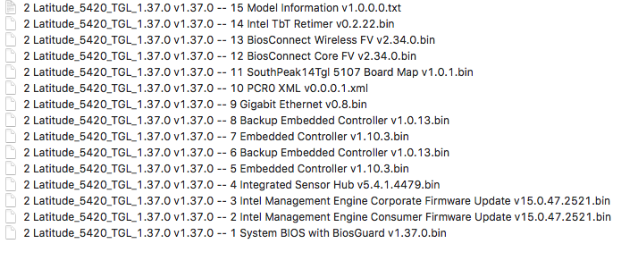

                      I just wanted to ask you for a clarification regarding when I couldn't open the file, for which you said I should have used the appropriate version for that BIOS.
                      I used 15.0.35.1951 which, looking at your screenshots, is exactly what you used to reconstruct my BIOS.
                      The original BIOS was built with 15.0.10.1432 which I couldn't find online.
                      Did you perhaps use 15.0.10.1432 (if so, could you post it here so I can download it) and then completed the preparation with 15.0.35.1951?
                      Or did you manually modify something in the original file so that it would then be readable by 15.0.35.1951?
                      Thanks so much again, volinakis .

                        I don't remember, I think I rebuilt bios from scratch. I don't have 15.0.10 ver. Lowest I have is 15.0.21.1549
