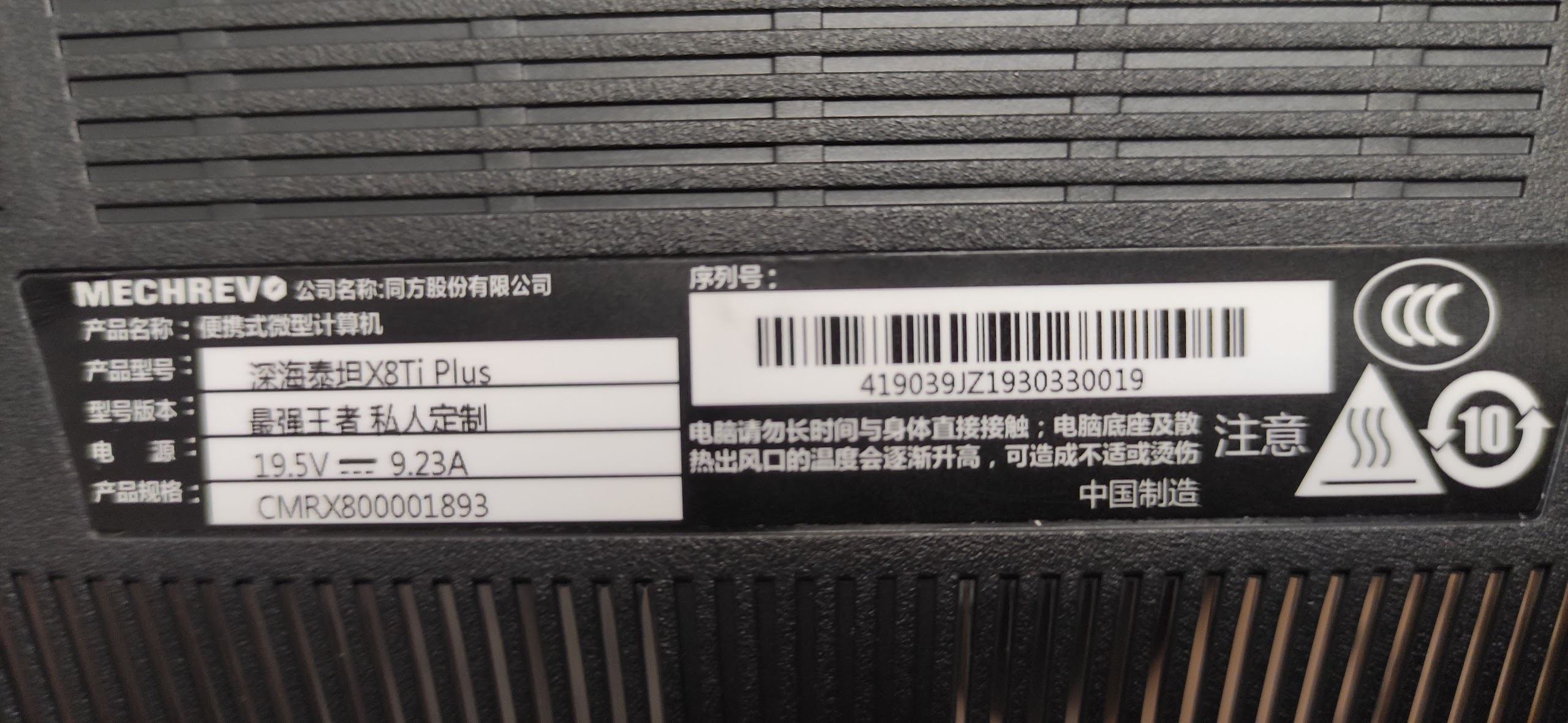

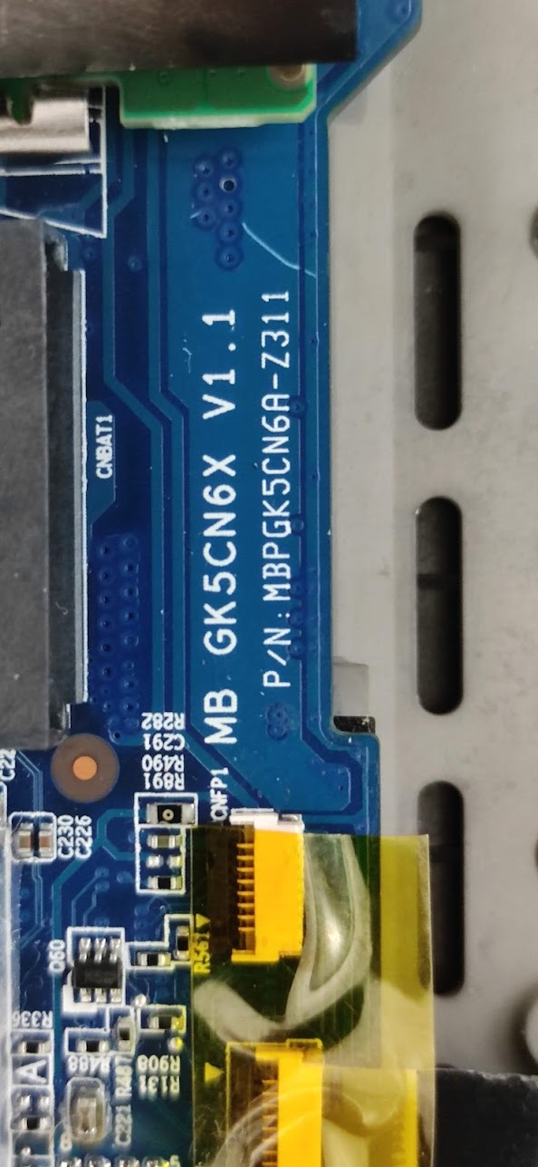

                    Hi all!! Thanks in advance for you support. I'm repairing these laptop, first it didn't boot but at least the RGB keyboard light up and some leds also. I make a bakup of the EC and the BIOS, to try another bios, but now it dont do anyhing, any led, with backup bios & ec neither... ;-( Is for that reason, i searrch an EC and BIOs good fles to reprogram it by the Ch341a programmer.
                    Mechrevo Laptop
                    Model X8Ti Plus
                    MB GK5CN6X v.1.1
                    GTX 1060 and I7 8750H
                    Thanks!!!

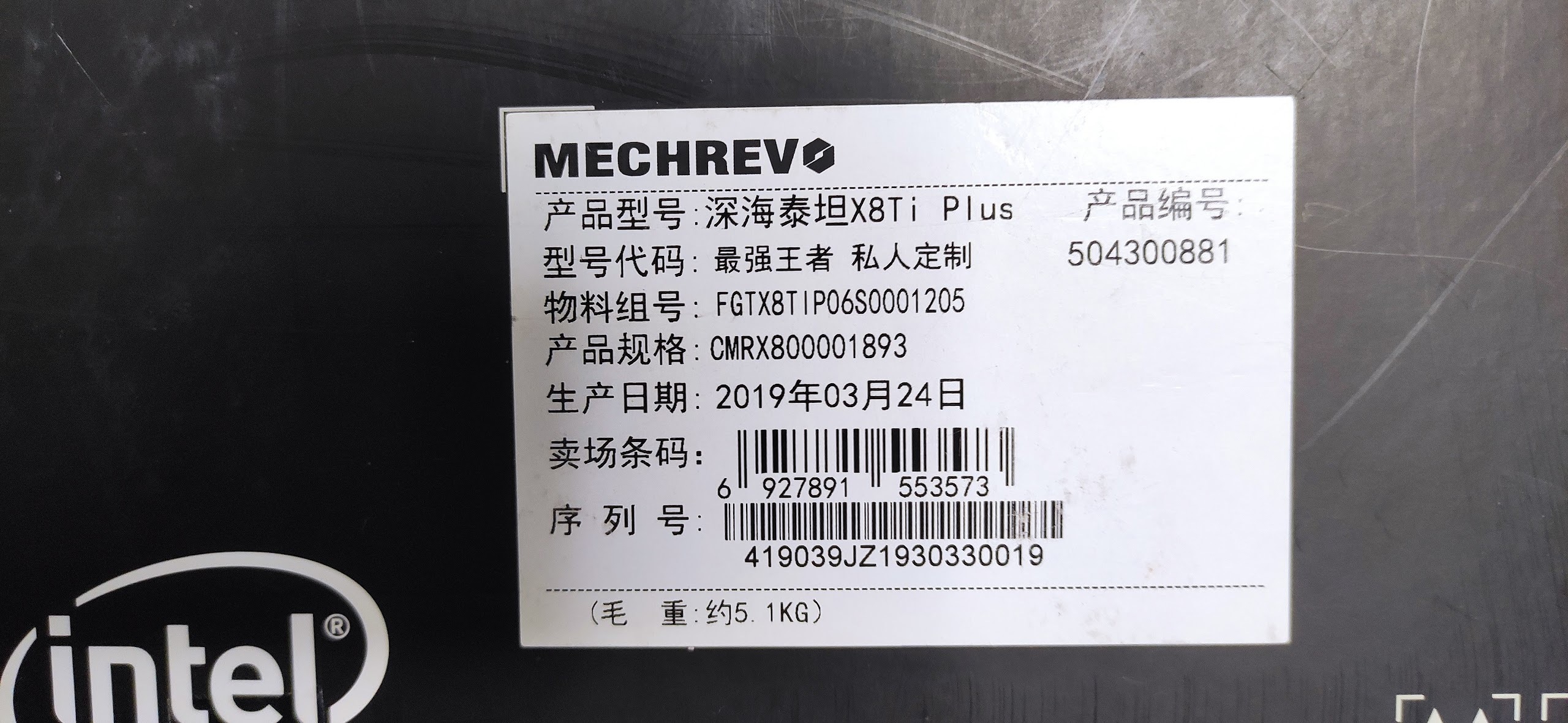

                    Thanks SMDFlea I upload my bios & ec backup and the serial number into the chasis is 419039JZ1930330019. I upload also the photos of the MB, the serials on the chasis and the box of the laptop.

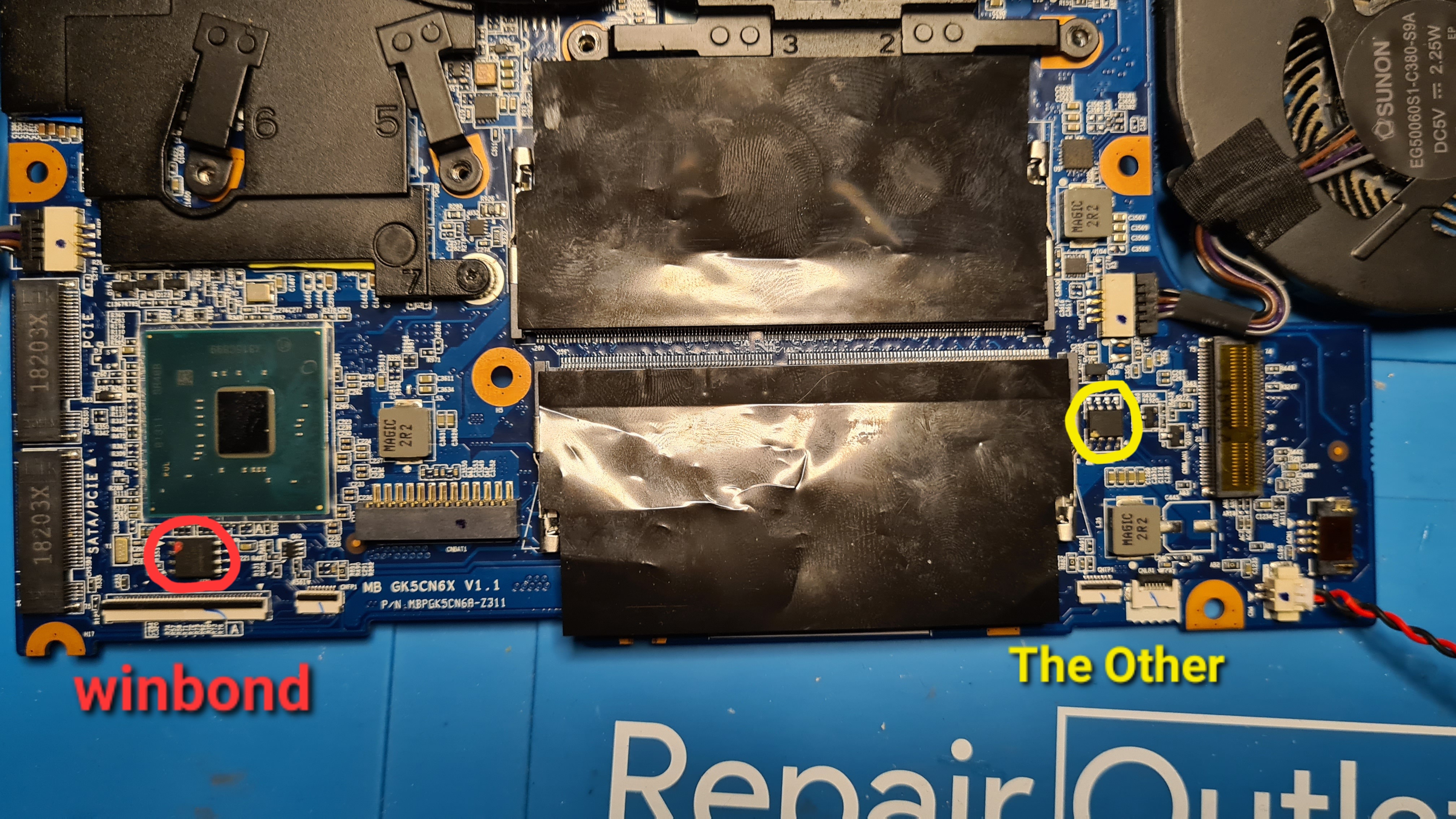

                              Hi all, I hope everyone is well! 😉 I've not been on fir a while, but I've started doing some repairs in my spare time again and I'm looking to refresh my knowledge of bios and flashing etc. When I used to do it there was one bios chip, and that was it, but now there are multiple chips on the boards, and I've no idea why, or what the difference between them is?? 😵‍💫 so if anyone could give a brief refresher I'd really appreciate it! 🙏 🥹
                              Anyway, I have a gaming laptop GK5CN6ZGK, PC Specialist, which wont power on, light comes on then back off again! Ive done all the normal checks, reset bios, reseated ram, tried different ram, checked board under microscope for burnt/discoloured components etc, I've had multimeter on it and it seems all power rails are present and as yet I've found no shorts? I've disconnected everything from the mobo, including the power button board, leaving just the fans plugged in, then powered it up by shorting the pins on power board connecter, same thing happened, so I'm a bit stumped tbh, I know it could be a cpu, or gpu issue, as its quite common in gaming laptops, but as I said, I can't find any shorts. I've also tried 3 different power supplies, so it's not that either! I'm thinking ots either Chipstead, super IO, or bios, so I'm gonna do the easiest first and flash the bios, and cross my fingers, toes and bum cheeks! 😁 anyway, as you can see in the pics, there is 2 potential bios chips on this board, which I'm guessing both probably are, but I've no idea about these new bios setups, as stated above, so any help would really be appreciated guts, as I'm really stumped now!

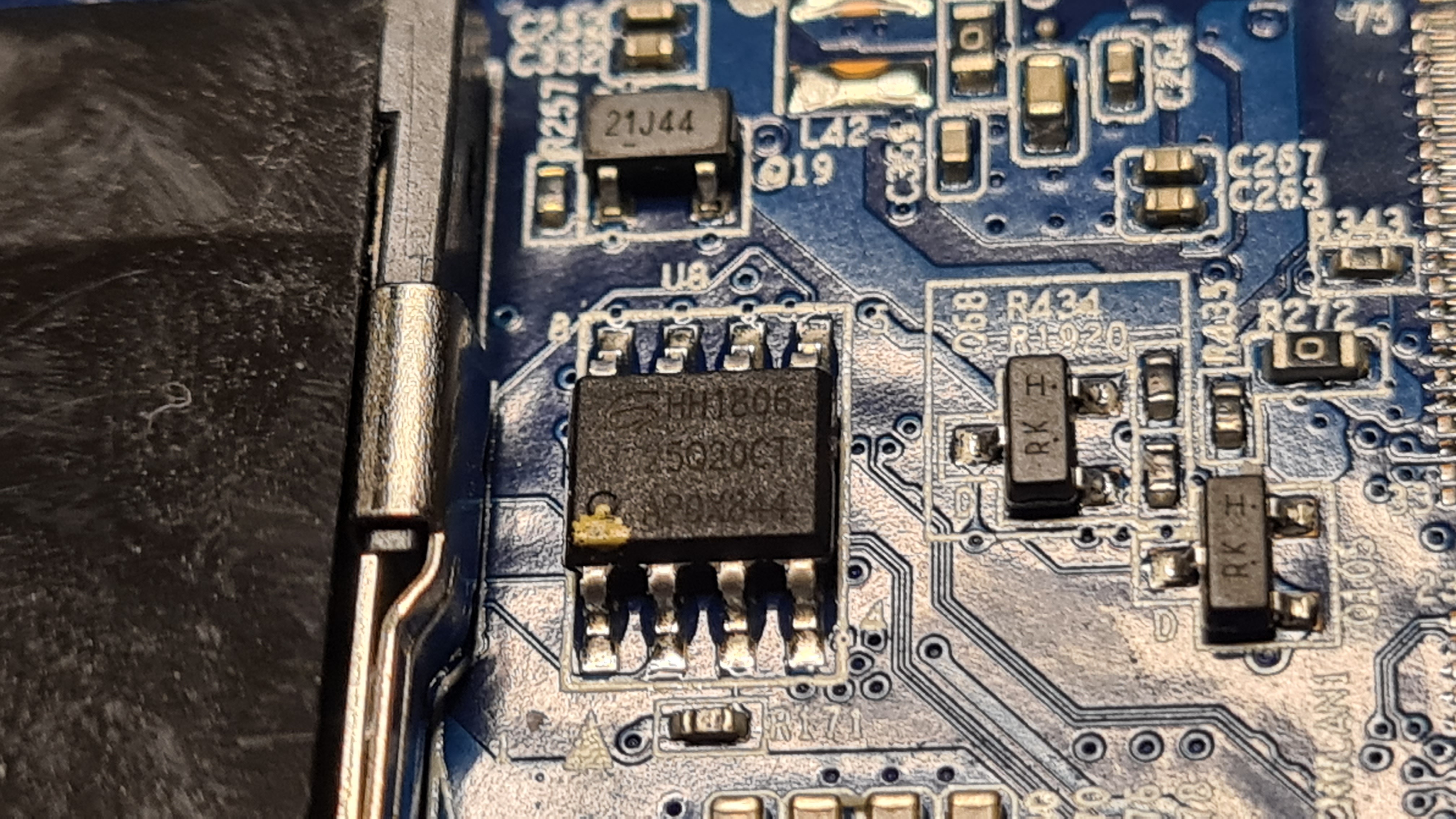

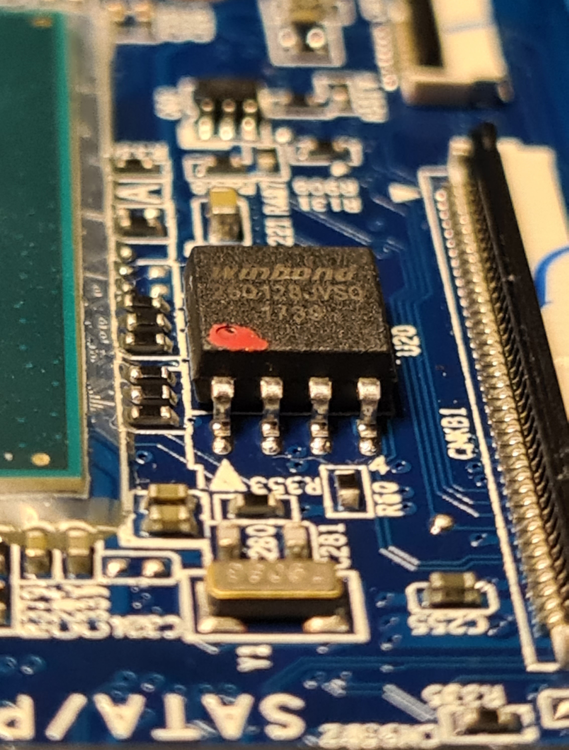

                                Hi Woody78 The winbond is the BIOS chip and the other is the EC BIOS chip. The first is about 16Mb bios, and the EC is only 256KB.I'm looking for these bios. I recommend you, first of all, made a backup of these bios with Ch341a Programmer for example. After that, you can try with the file in post #4.

                                    They are diferent bios. One (the 16mb) is the main bios, and the another, is the "bios" of the EC / KBC.
