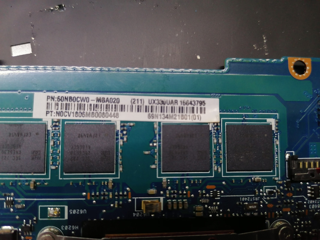

    Laptop has no display tried checking th chip select pin 1 of bios has no good reading on oscillo.
    Hope someone can provid Ill atttached my bin also..

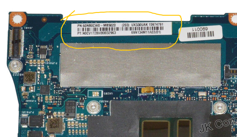

    Find all the stickers and QR codes on the main board to identify the exact device model.

      Re: BIOS for Asus UX330UAR REV 2.1
      PN: 60NB0CW0-MBA020
      BACK COVR : X330U
      No serials
        This should be fine, backup and try.
        I don't provide help for people using CH341A and a clip.
          Same problem sir.. Hope someone can check the bios if it's bad?

            are you sure there`s no barcode sticker
              It have sir
                  The bios at post #4 by daniel is ok,its an F1 Asus service bios ,look for other problems
                    Thanks sir Ill just post a other thread..
