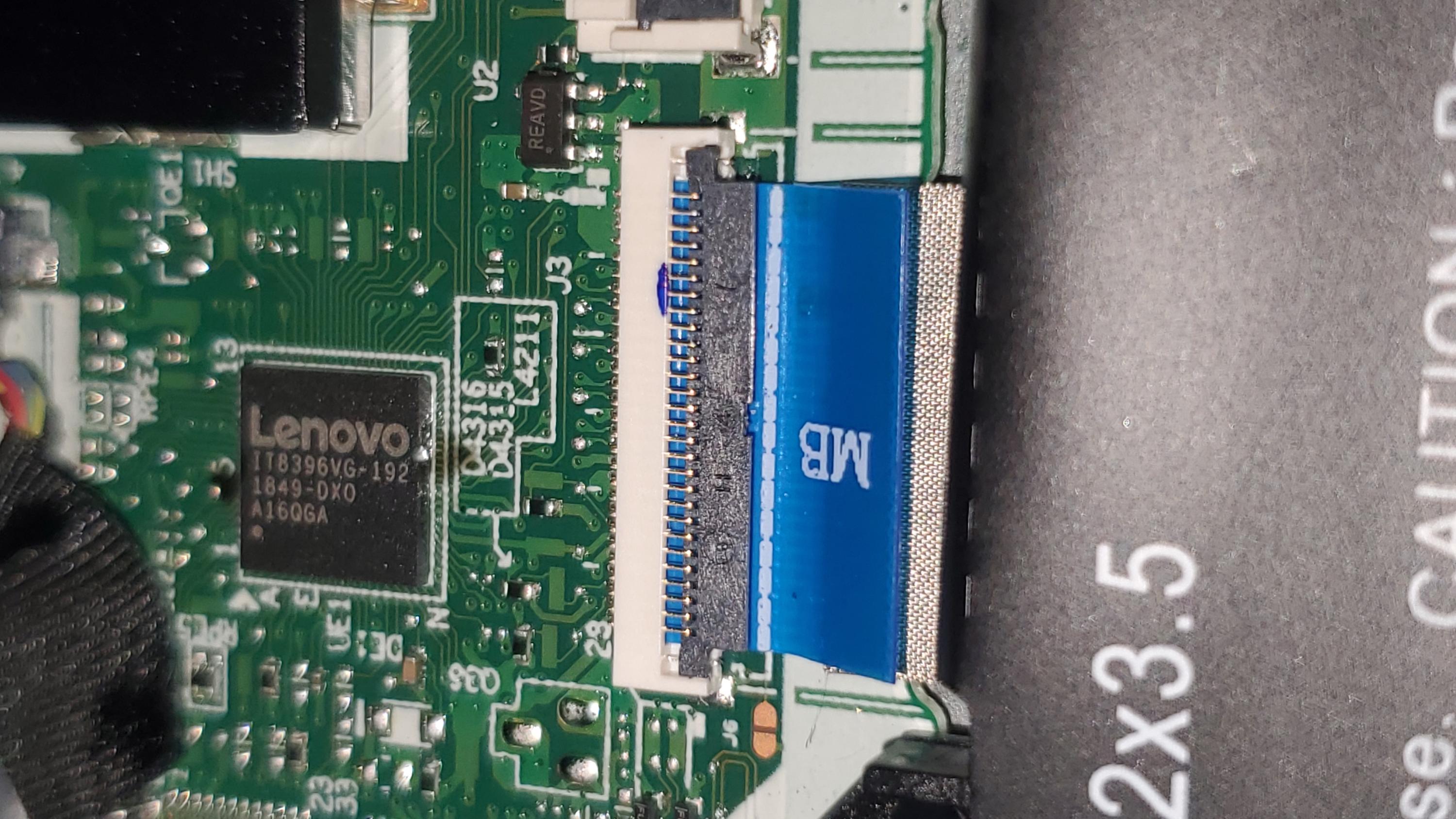

    Hi, my Lenovo Flex 6 14 ARR turned off suddenly and it won't turn back on.
    Mobo: EYG11-ES433-ES434-EYG21 NM-B781 Rev 1.0
    BIOS: w25q64fwsiq
    -No display. No backlight
    -CPU Fan spins for a 10 seconds then stops.
    -Power LED stays on and CPU fan starts spinning again while the CPU gets hotter
    -I have to hold the power button down to shut it off.
    I tried a dump but it didn't work.
    Air 14ARR EYG11-ES433-ES434-EYG21 NM-B781 Rev 1.0.BIN
    I tried a similar model dumps from here. Lenovo 530 14 ARR with the same board but it didn't work.
    I'm using
    ch314a black with volt mod.

    Try this one. Virgin BIOS extracted from Lenovo official BIOS update program. Same version as your old one. If it doesn't work, it's less likely a firmware issue but some hardware failure.

      Thats the 1st BIOS I tried. Extracted from 8mcn58ww.exe, same symptoms. I also bought a new battery and replaced the RAM.

        Thanks. I tried it but still no display.
        Does anyone have a working dump?
          Not a bios issue.
          I don't provide help for people using CH341A and a clip.

            You guys are right! I found the issue. A blown EC IT8396! Next problem is looking where to buy it.
