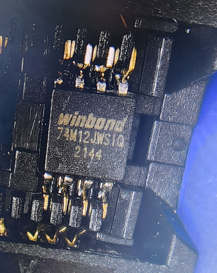

                  i am dealing with 74M12JWSIQ which doesnt get detected.
                  IC not responding
                  Current programmer: CH341 Black
                  LC56-14A SVT
                  203021-1
                  Suspecting faulty ROM. Any recommendations as replacement?
                  Would Any 1.8V 120 Flash size would work?
                  XM25QH128A I have here seems to be 3.3V
                    IC not responding
                    It doesn`t get detected because you are doing something wrong or the chip is not in the support list. Don`t assume it`s a fault ROM just because you can`t read it. Choose a different chip that is in the list for example W25Q128JW (1.8V) and try reading it again. If you`re using a clip or pogo adapter it`s not the most reliable way, desoldering the chip and putting it in or on an adapter is the best way.

                      Thanks SMDflea
                      I should have specified that this is with the ic desoldered and placed on a SOP socket on 25xx side
                      I have tried with the clip initially, but hasn't detected it. Unless that clip damaged the chip somehow. :/
                      Where the XM25QH128A IC on that socket reads fine, but gives me this error when programming XM25QH128A with GJCN27WW.bin or W25Q128FW_dump.bin from another but same board numbers.
                      Code:
                      22:40:05
                      Programming memory(verifying)... Main Memory
                      Verification error on address: 0x00000000, Device: 0x00, Buffer: 0x02
                      Execution time: 00:00:00.032
                      Seems there is no W25Q128JW on the CH341 Black list. Has anyone come across new list updates? My NeoProgrammer 2.2.0 Chiplist is from 29/09/2021

                        Originally posted by ZixuTech
                        Thanks SMDflea
                        Code:
                        22:40:05
                        You can add new chip support to NeoProgrammer https://www.badcaps.net/forum/troubl...41a-programmer
                        Attached is ASProgrammer 2.1.2 ,it has pretty good XMC support.
                        Attached is my NeoProgrammer chiplist ,the 25Q128JW is supported.

                          Thanks for this SMDFlea
                          Unfortunately neither NEoProgrammer with your updated chiplist nor AsProgrammer detects this IC
                            try to read it as 25Q128JW .Are you using a 1.8V adapter ? ,if so and it won`t read the chip may be bad.

                              #296
                              Thanks SMDFlea, managed to flash it.
