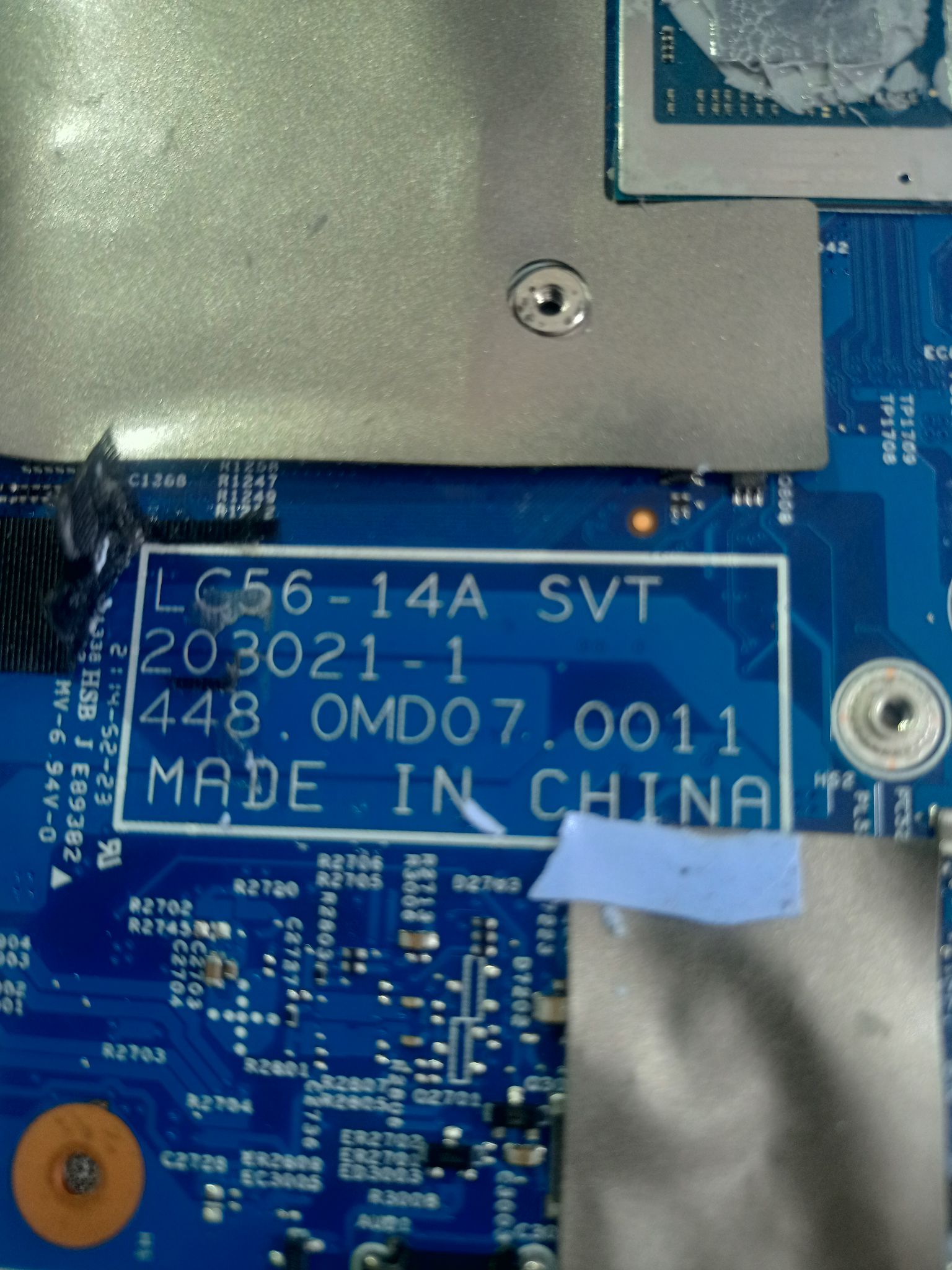

    motherboard code : LC56-14A SVT 203021-1 448.0MD08.0011
    sn: R9122SNY
    Bios password...
