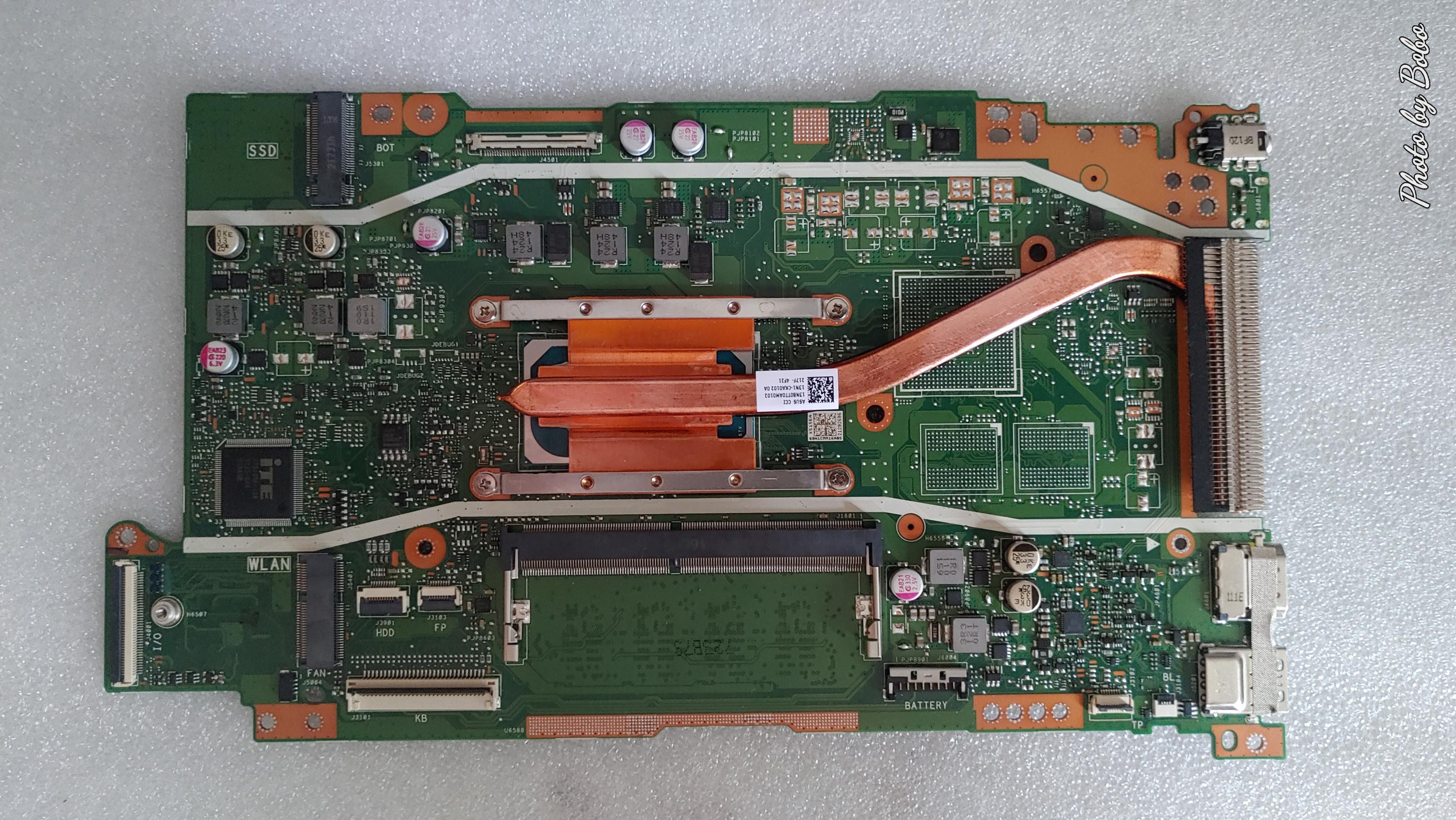

    Hello .
    Please, I need BIOS for ASUS X515EA.
    So, I test X415EA but not work keyboard.
    If I extract for ITE block from my old BIOS to X415EA all work fine.
    But after update BIOS same problem, becouse ITE chip update every all start up and X415EA have another binary code for ITE .
    If I don't update BIOS all work fine.
    Thanks for your help.

    Post a picture of the white/green barcode sticker,or white square QR code on the motherboard. The QR code,if there is one could be under the wifi card,under a sticker or heatsink.

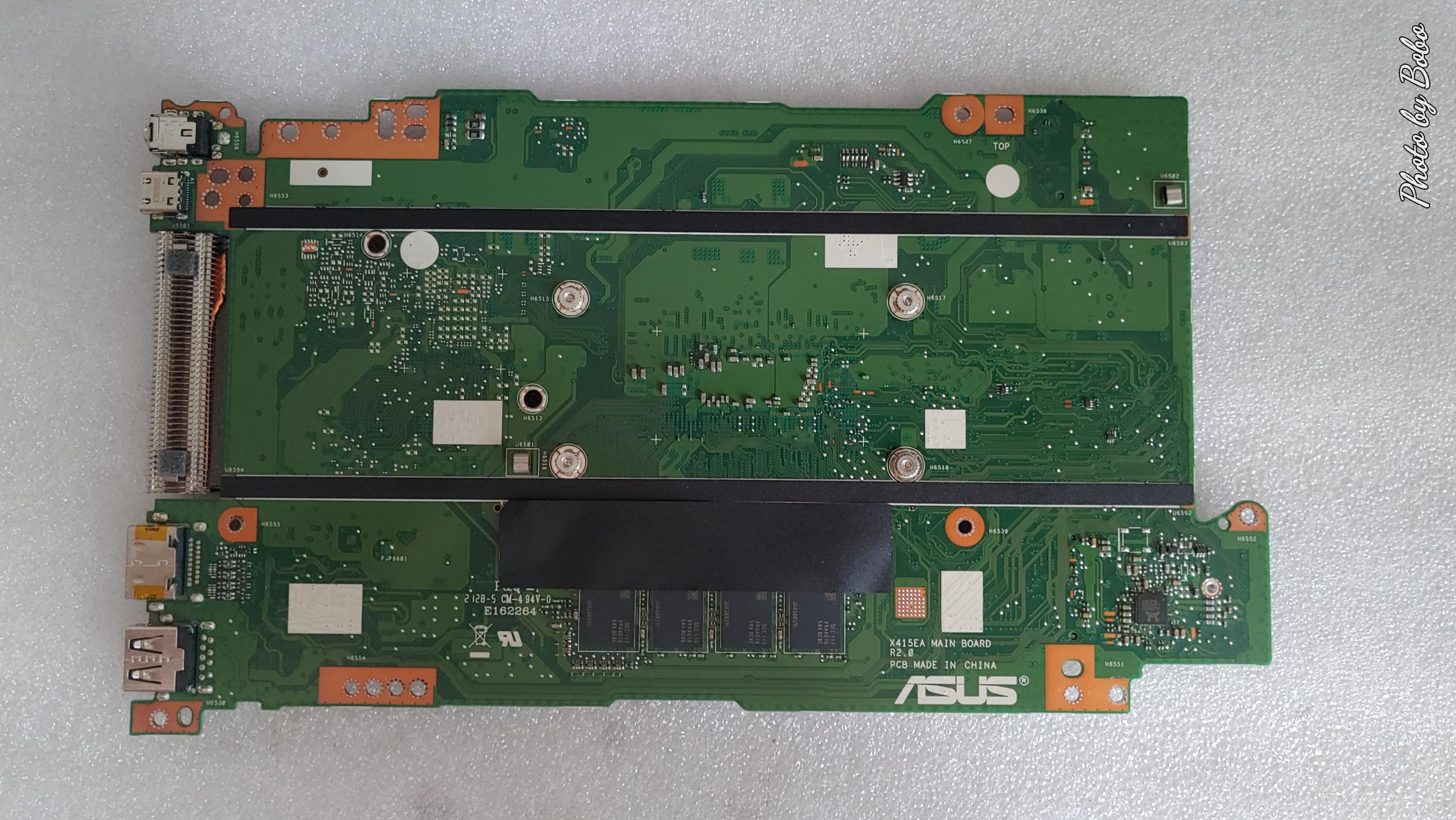

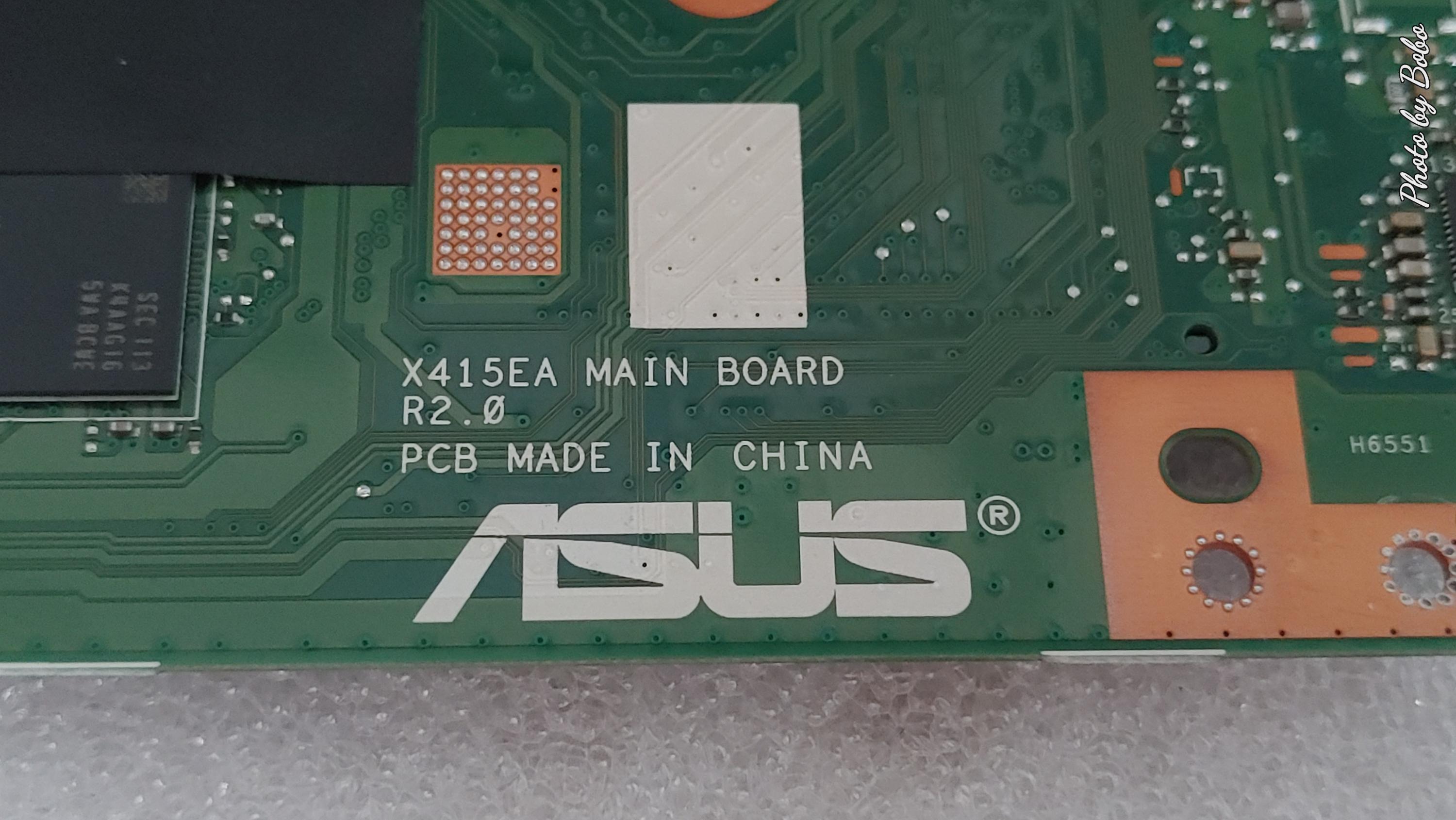

      Re: BIOS for Asus X515EA
      Photos has been added.
          System power on normal, but not work advanced menu, Boot menu and any change in BIOS.
          After restore factory BIOS from USB all work fine.
          I am enclosing a fully functional BIOS ver 307.
          Thank you so much.

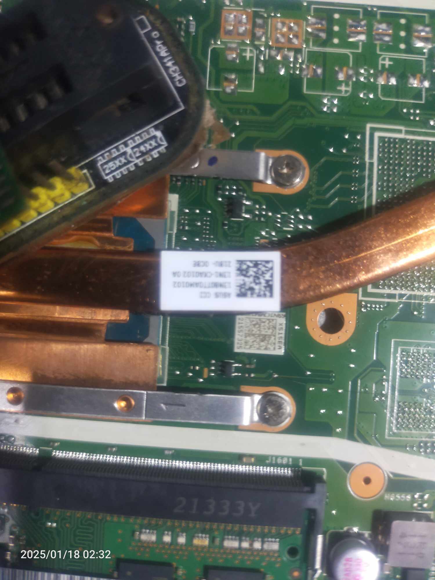

            Hi
            Asus x515ja-br3853w powers on only some times. or after a long press on power button
            MODEL: X515JA-BR3853W
            SERIAL: NAN0CX04467743F
            MOTHERBOARD: X415JA R4.2
            can you please help with clean me or any other idea ?
            attached bios

            Hi
            Sorry and thank you. i have added the requested details. can any on please help with this ?
              SMDFlea commented
              Editing a comment
              Can you find a QR code on the motherboard ,like the 2nd picture at post 1. Not the one on the heatsink, only on the board.

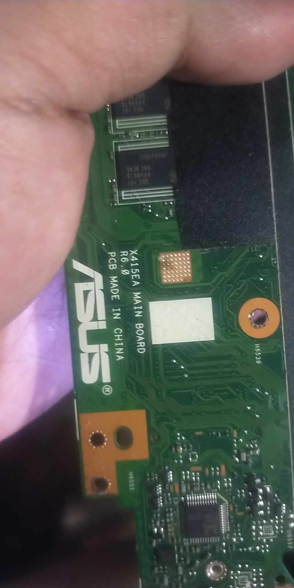

                please help me unlock my bios
                MODEL X515EA-BQ868T
                BOARD: x415ea REV 6.0
                SN:MAN0CV04449708
                nvme ssd lock.. i cant install os
                • hoaca388
                  Badcaps
                  • Jan 2022
                  • 11815
                  MODEL X515EA-BQ868T
                  SN:MAN0CV04449708
                  Unlocked.
