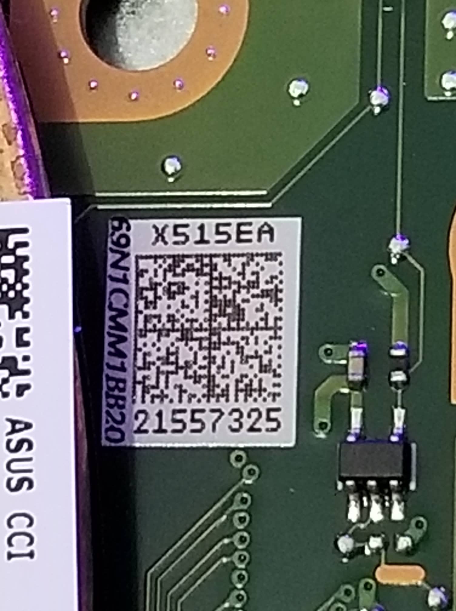

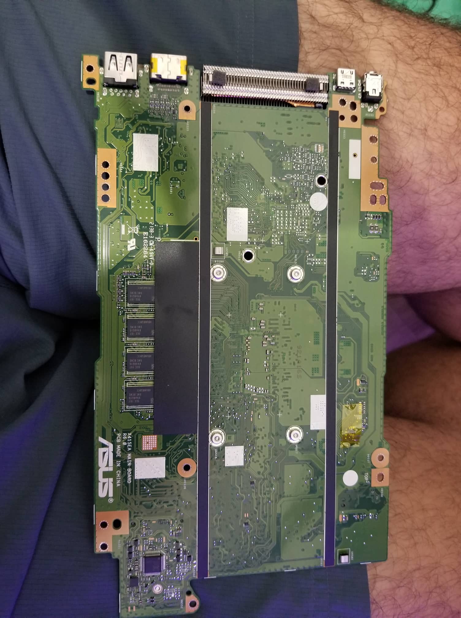

    Hi, Please help me with my laptop, I have this ASUS X515 that has BIOS password. I try to flash with BIOS X415EA Rev 2.0 but the keyboard wont work.
    Then I try to flash with X515EA , the keyboard works but SSD wont detect
    Is there any correct bios file for my unit? The Model is Asus X515EA on the sticker and X415EA R6.0 printed on the motherboard.. please see the attached image
    The attached Bios bin was the original BIOS but has a Password..
    Thank you

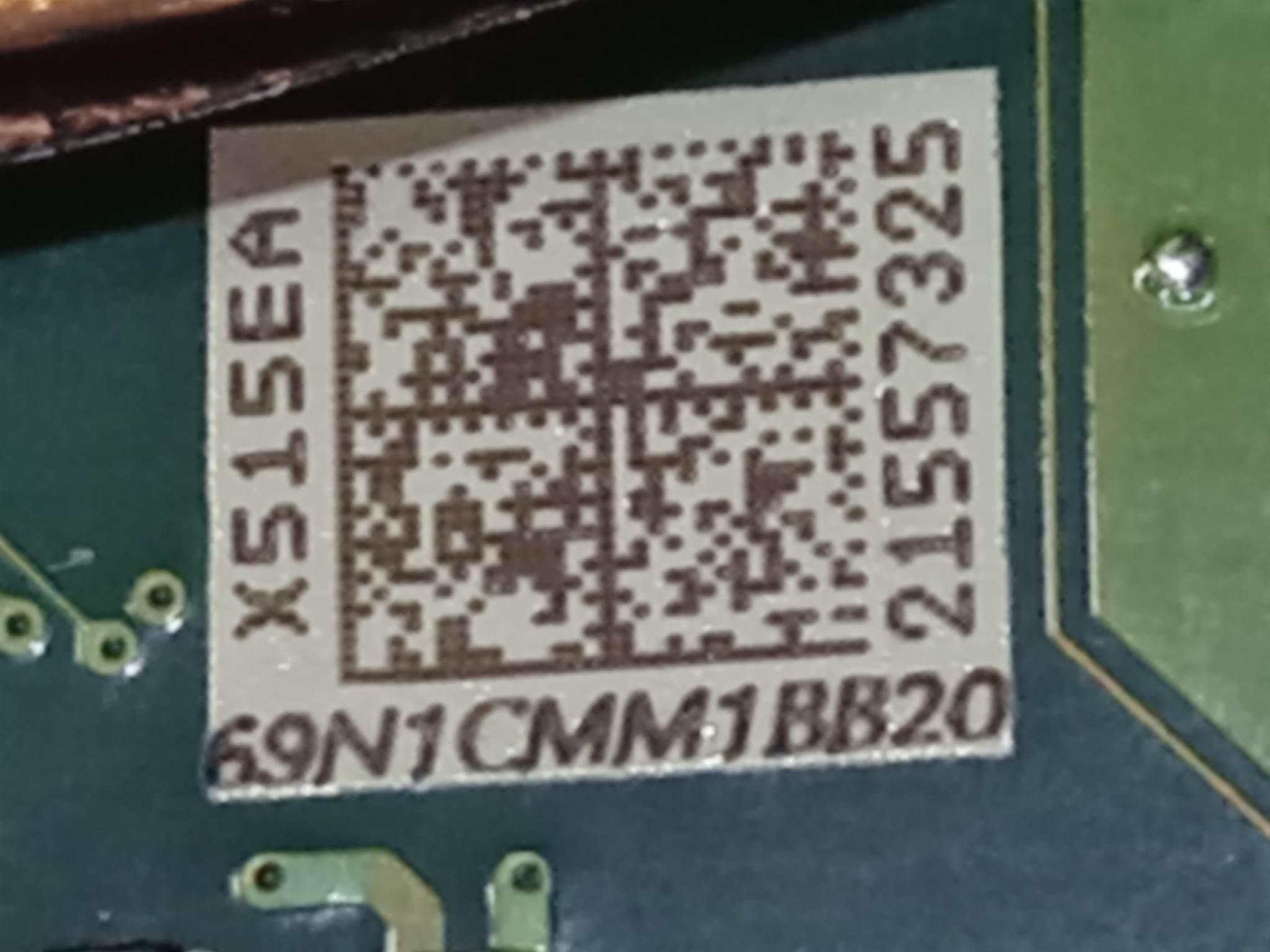

          The part number on the QR code is X515EA ,thats the bios version you need .

            sheeesh.. this one works.... Thanks Man ...
