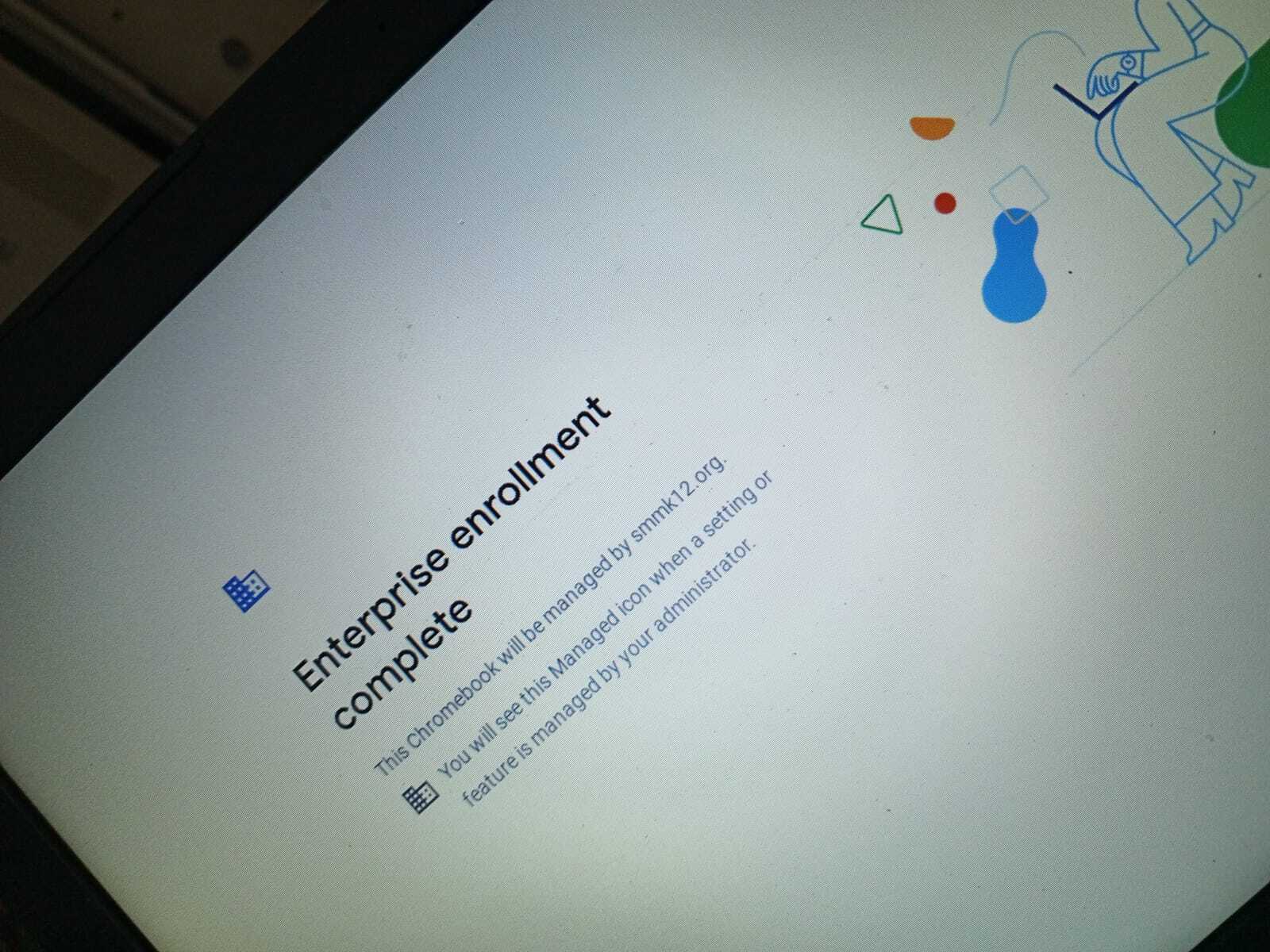

        • Arsalan455
          • Oct 2019
          • 57
          • Pakistan
          Hello guys
          I have Hp chromebook 14 g5
          DAOOG1MB6CO Rev:C
          S/N 5CD9356V1T
          Plz remove enterprise edition ​
          • osman68i
            • May 2015
            • 342
            • The Netherlands
            Originally posted by Arsalan455
            Hello guys
            DAOOG1MB6CO Rev:C
            S/N 5CD9356V1T
            Changed you SN to XXXXXXXX
            after flash install clean chrome os with usb
            • LatinMcG
              • Jun 2015
              • 73
              • USA/Puerto Rico
              have to boot linux and wipe disk so it does not return on boot.
