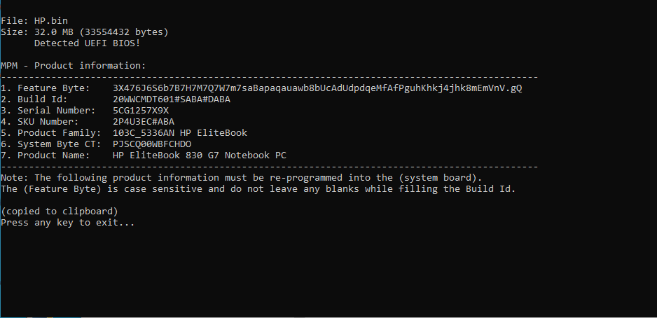

      Re: hp dmi data tool
      Originally posted by hoaca388
      Product Name : HP EliteBook 840 G6
      Serial Number : 5CG0241W5B
      SKU : 8QH76EC#ABU
      BuildID : 19WWCFCT601#SABU#DABU
      FeatureByte : 3X476J6b7B7H7M7Q7W7m7s9AaEapaqauawbUbhcAdUdpdqfAfP fXhKhhhkjhk8.qF
      System Board CT Number : HWHN00WBDUAY7
      I WANT TO GET THAT INFORMATION

          I know you want to find Build-ID and Feature bytes but I don't have a method yet.

            i know you want to find build-id and feature bytes but i don't have a method yet.
            yes bro

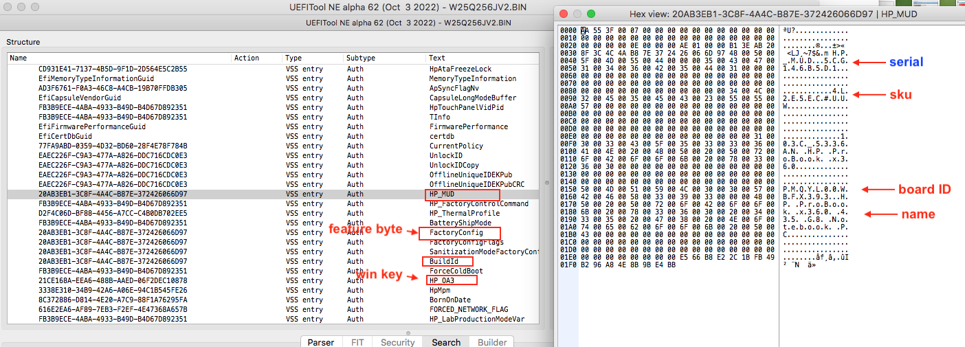

              With a hex editor search for these as unicode
              MUD , BuildId , factoryConfig
              You can search for the serial with UEFITool as well, everything is in the VSS2 store under the same multiple GUID ID ,such as 20AB3EB1-3C8F-4A4C-B87E-372426066D97. With UEFITool you can search by GUID as well.

                like this

                  Try to search on UEFITool and you will find all information.
                  Serial, Board CT number, Product Name in HP_MUD
                  BuildID in BuildId
                  FeatureByte in FactoryConfig

                      how to find. can you help me ?

                        open bios dump with UEFITool and search for text "HP_MUD" (no quotes). You'll find it in VSS2 store, view as hex and you'll have there serial, sku, board ID and name of machine.
                        in FactoryConfig you'll find feature byte, in BuiltID you'll have ... let me think ... right! build ID and in HP_OA3 you'll have win key.
                        other way: if your laptop is working and don't have bios dump use Bios Config Utility and in cmd type: biosconfigutility -get:1.txt. you'll find 1.txt. in BCU folder (usually in Program Files(x86)) and you'll see all data there.
                        3rd way: there is a label on bottom cover ...

                          I want to show the same thing

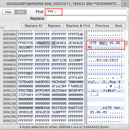

                                How to find version bios with UEFITool ? can you help me ?
                                thanks!
                                  thanks!
                                  BVDT https://www.badcaps.net/forum/showpo...51&postcount=2

                                    Some Elitebook, probook bios can't find the solution, can you help me check it?

                                      really? Or you can hit Esc at boot and then F1...

                                        yes ! i want find frome file bin.
