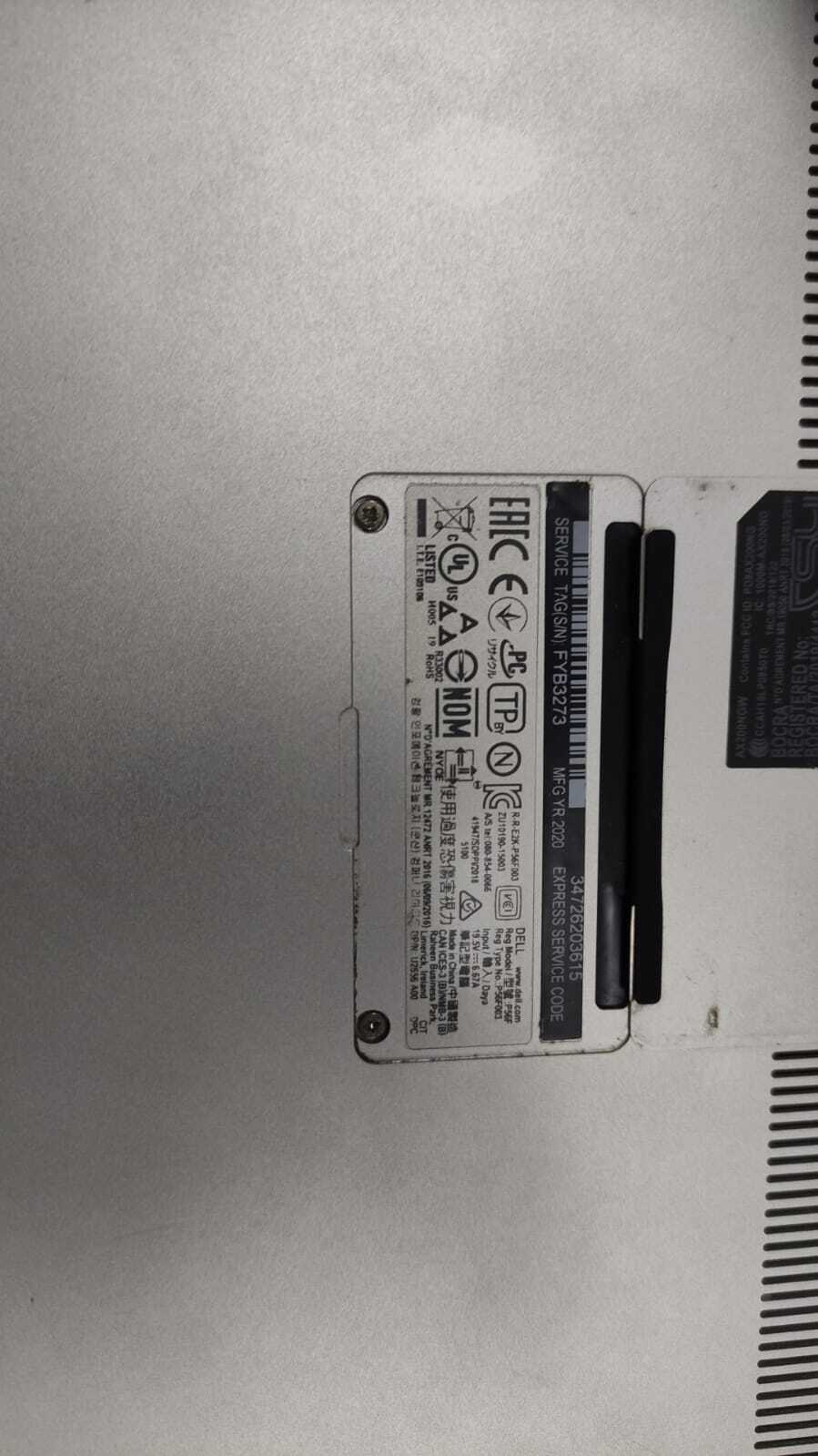

                                      Hi need help with my bios dump for my dell xps.. It cant detect audio hArdware and i think its a bios issue pls can u help
                                      My dell
                                      ST FYB3273
