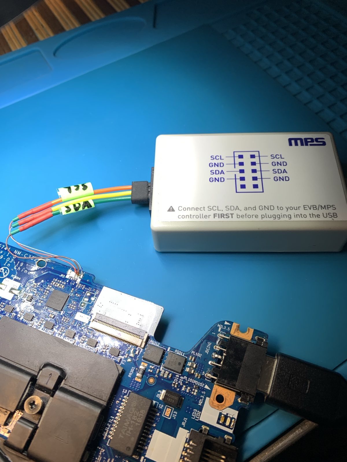

    Yes, it must be programmed otherwise it will not work.
    This programmer can be used EVKT-USBI2C-02.

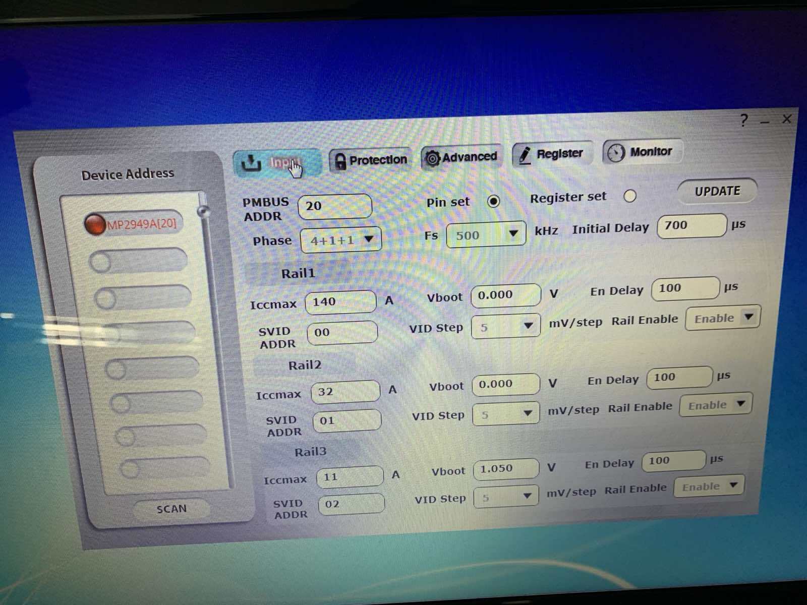

                Hi bros, anyone here succesfully programmed MP2949A firmware in NM-C361 or know where to get dump for try?

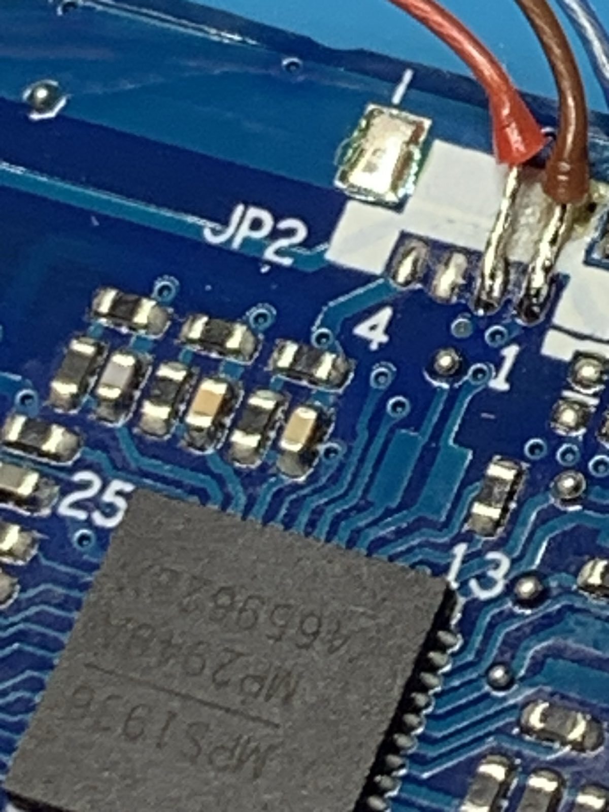

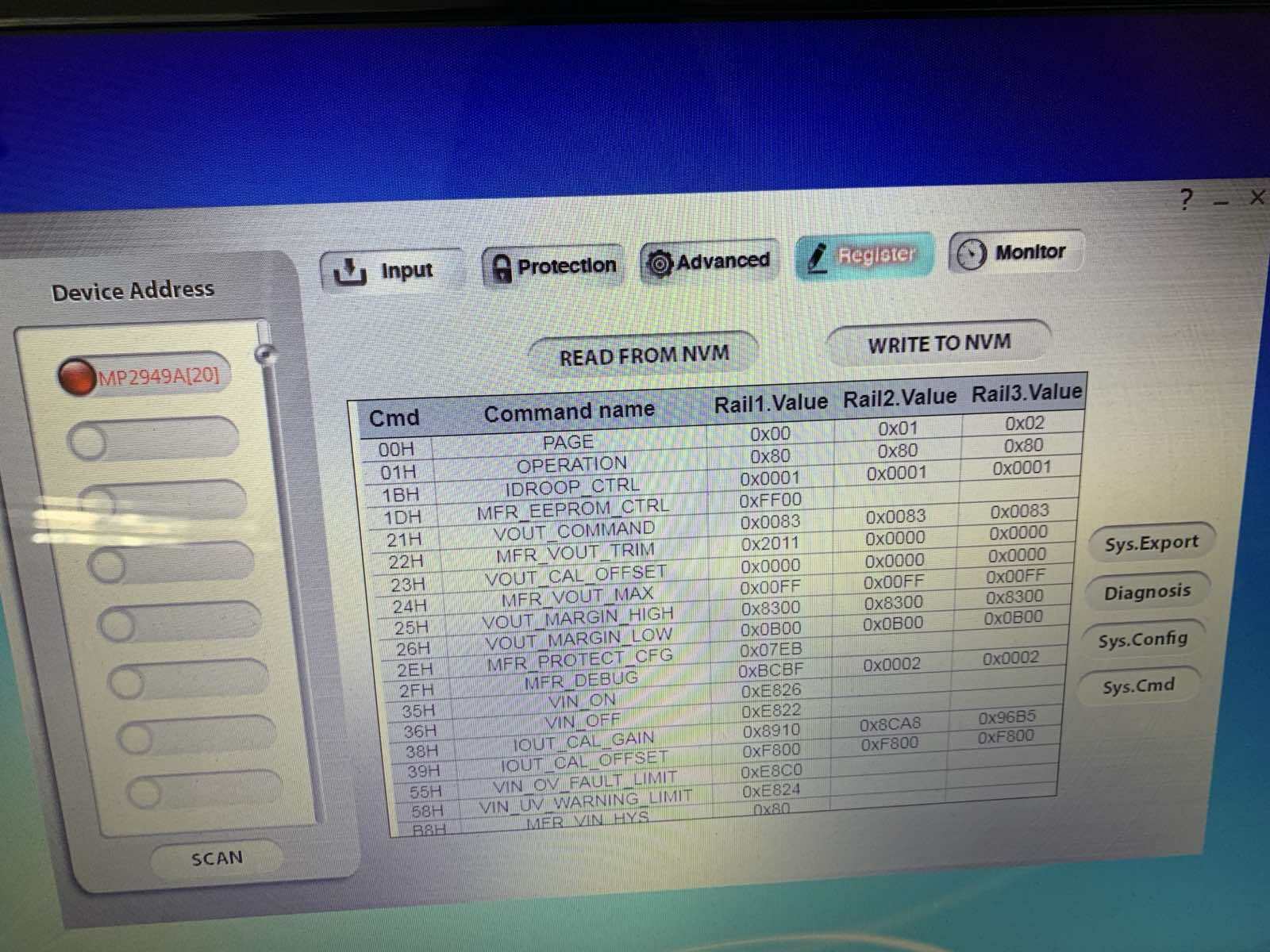

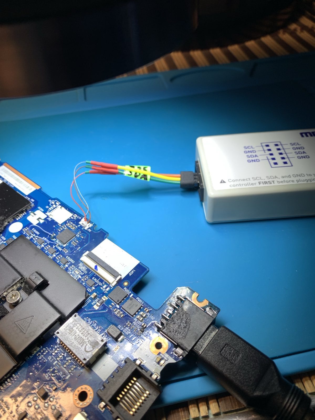

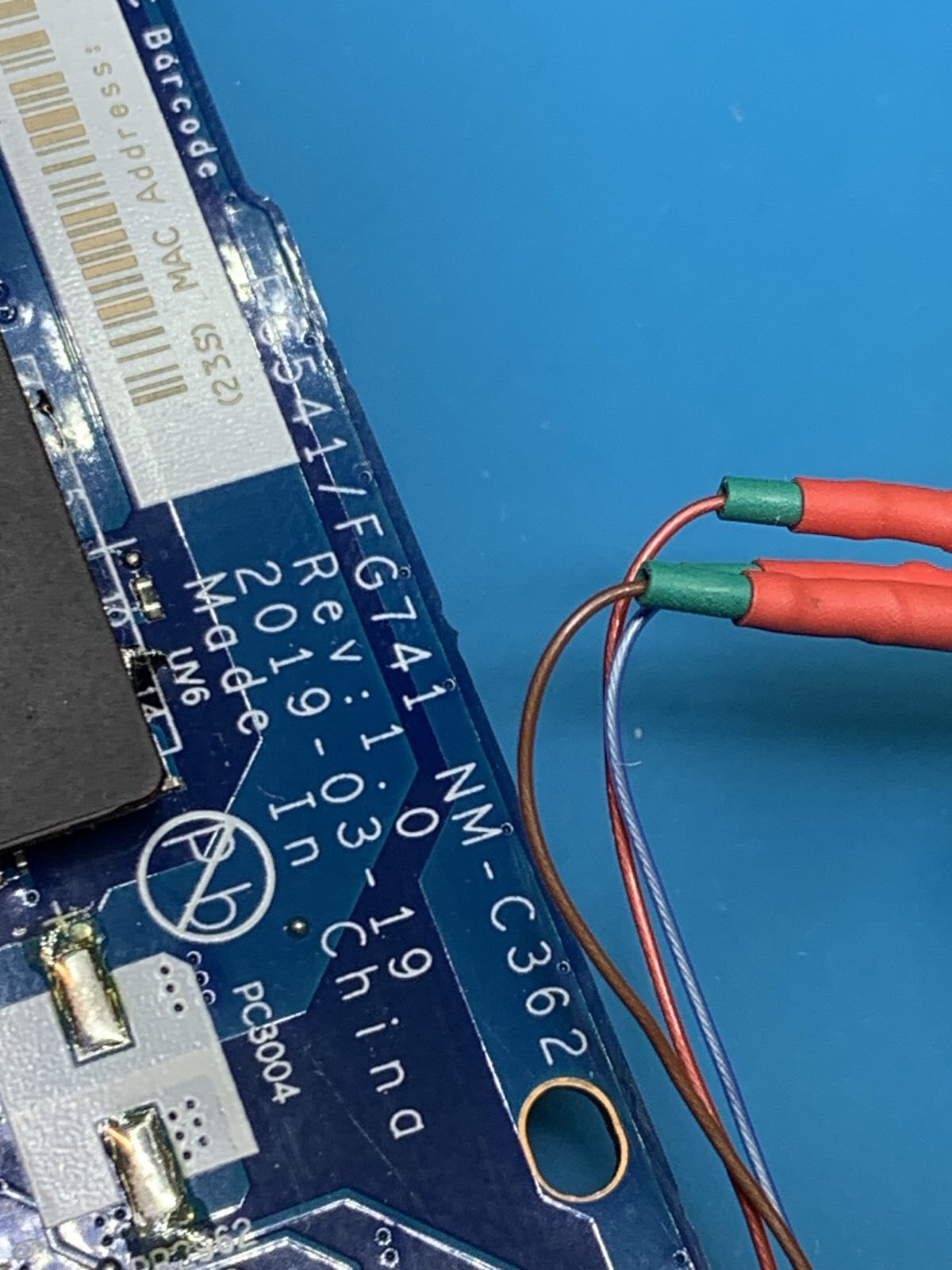

                  Hi, I finally succesfully programed MP2949A on Lenovo L340 using SVOD 4.

                    MP2949A FIRMWARE attachment, motherboard FG541_FG741_NM-C362_REV1_0

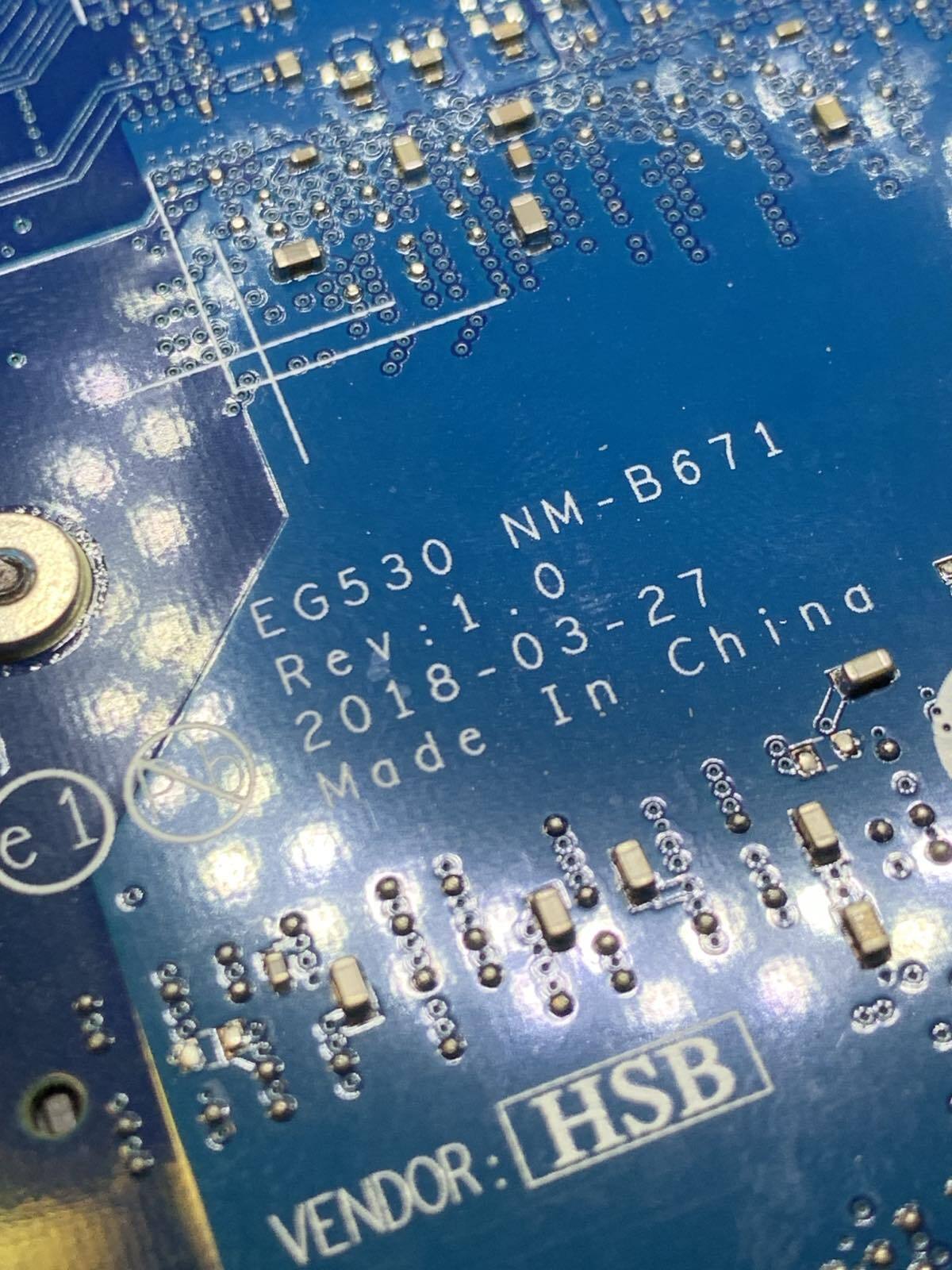

                            MP2949A FIRMWARE attachment,motherboard EG530_NM-B671_REV_1_0.rar
                            • andreynew1
                              • Jul 2021
                              • 19
                              • Ukraine
                                        how do you connect that?? you have instruction to do that??
