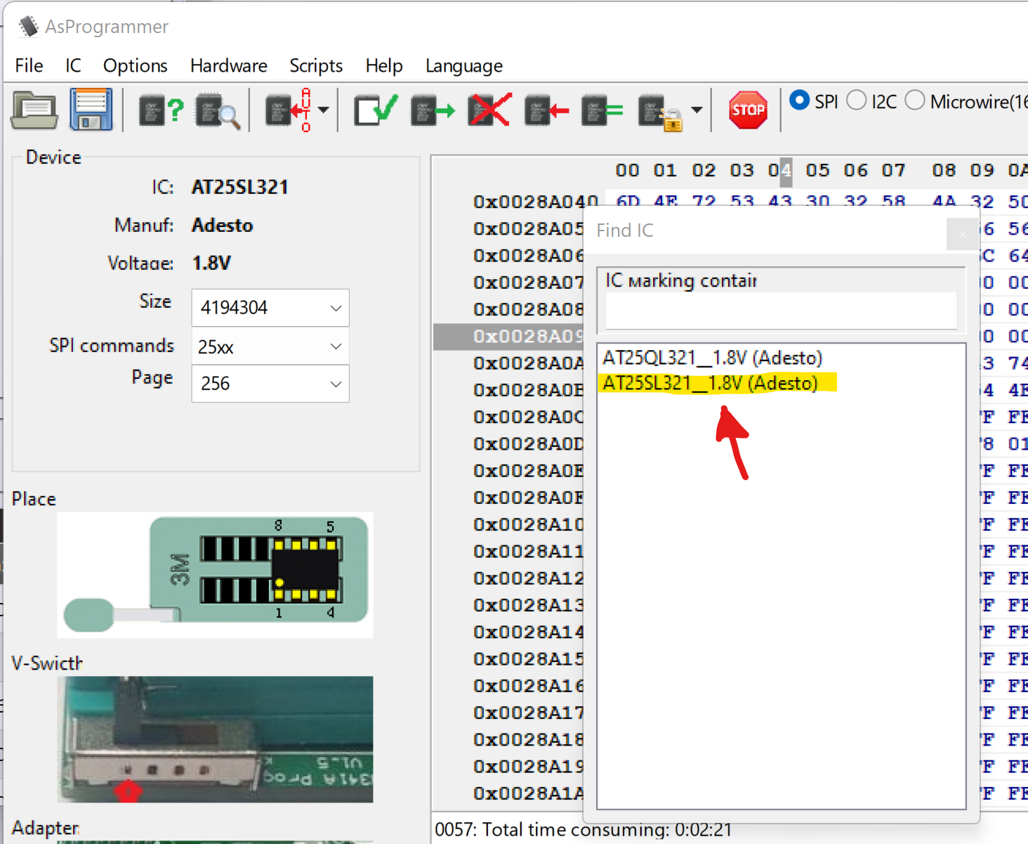

              none of the link programs support at25SL i need asprogrammer with at25sl support
              Try this version for AT25SL321

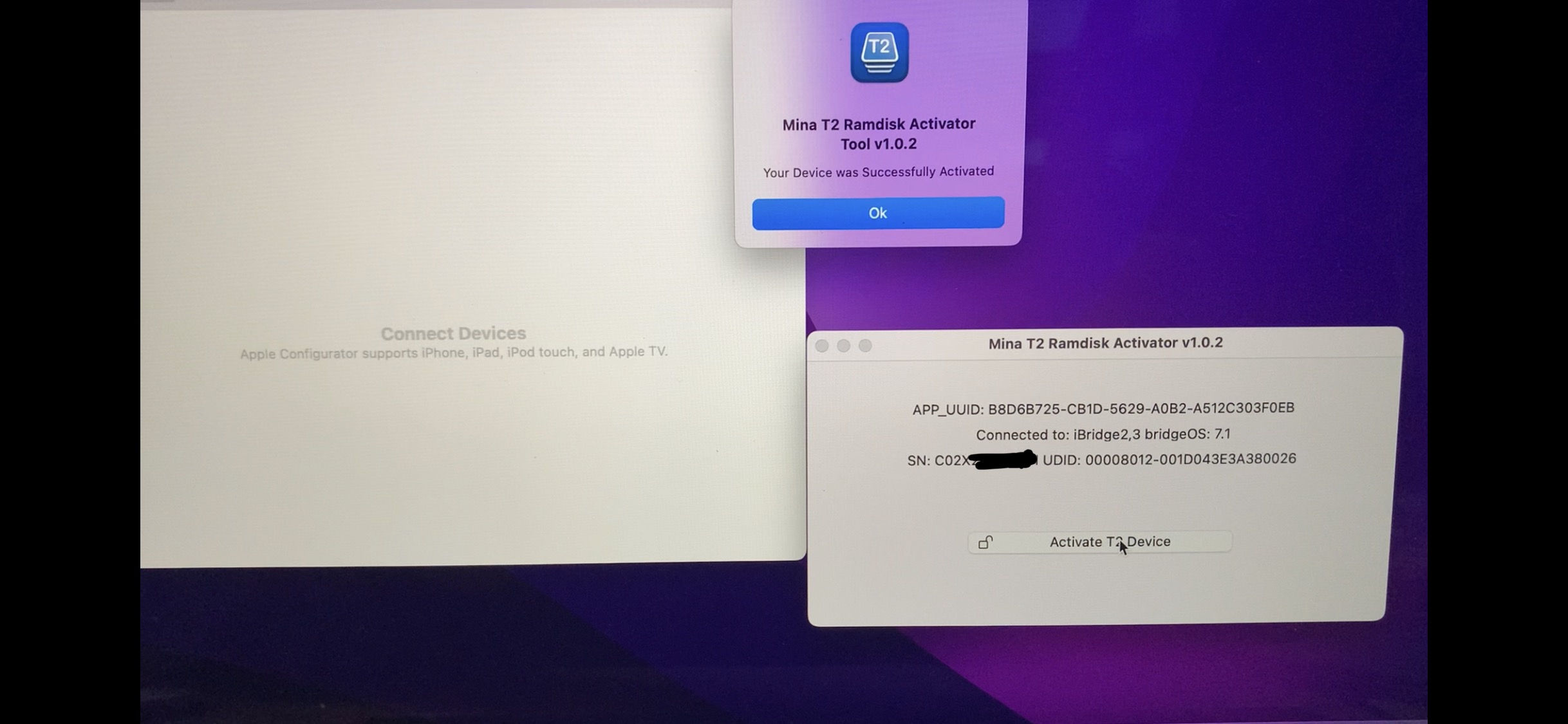

                                    By same author "Mina"
                                    but method is changed now.
                                    Now using RamDisk Method instead of jailbreak.

                                      Done Latest BridgeOS 7.1 Bypass.
