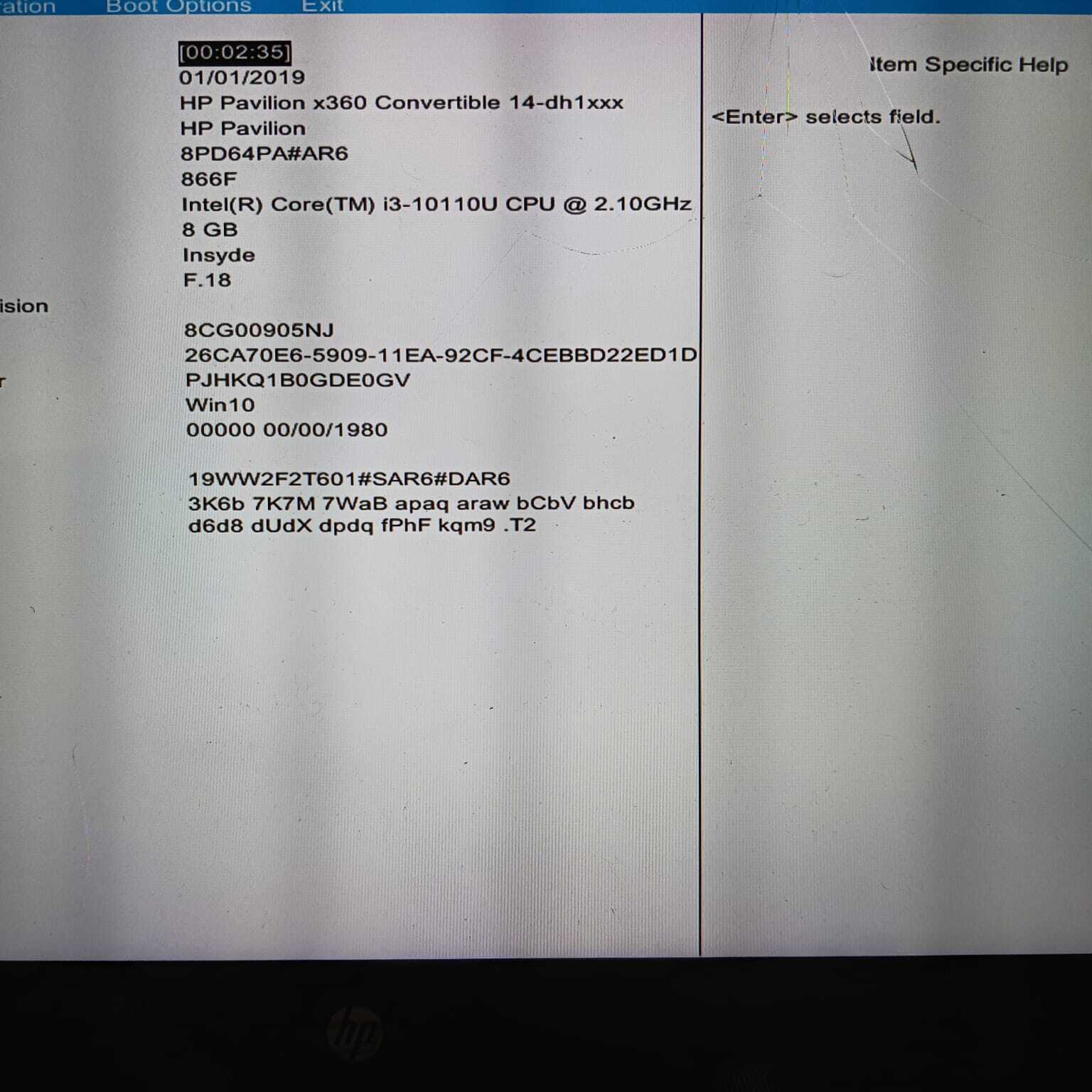

            • yuan22231
              • May 2022
              • 17

                          • jokophp
                            • Dec 2017
                            • 39
                            • indonesia
                            #53
                            is there something wrong with the bios that I edited? please advise sir..
                            • peste
                              • Dec 2016
                              • 13451
                              • ROMANIA
                              #54
                              Originally posted by jokophp
                              I have tried this file, the result is that the laptop cannot be turned on
                              The laptop comes with a screen case, no display
                              HP Pavilion x360 Convertible
                              Model14-dh1033TX
                              SN#8CG00905NJ
                              I include the original copy main+ec
                              bios extracted from the update from the HP website for HP Pavilion x360 - 14-dh1033tx
                              DMI + KEYWIN 380000 - 38103F​
                              • jokophp
                                • Dec 2017
                                • 39
                                • indonesia
                                #55
                                thank you sir, the file works with the original EC file.
