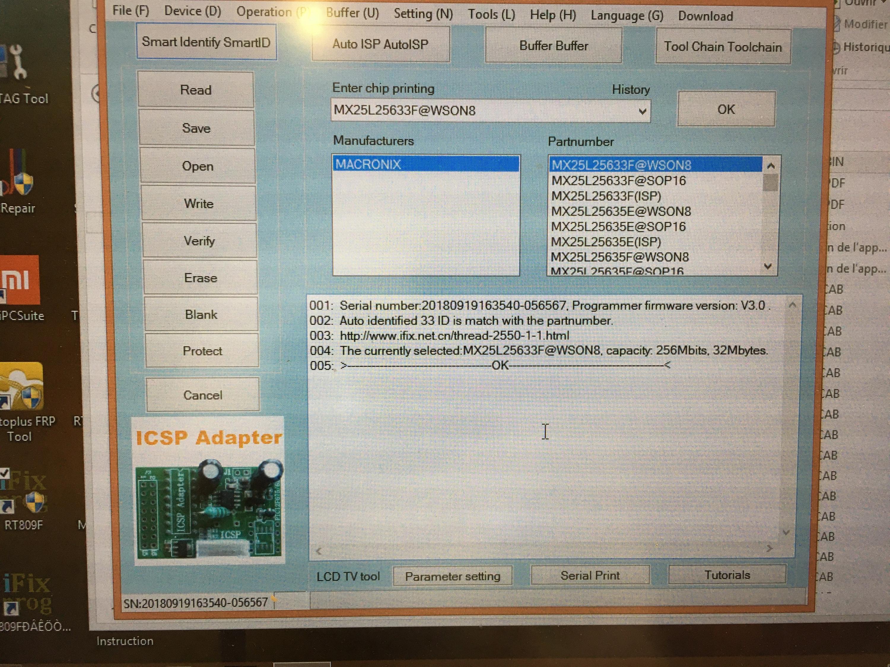

                      I just tried the tool to unlock the BIOS password for Probook 5670b. I read the chip with CH341 programmer and used the HP Unlock Tool. Erased and reprogrammed the chip with provided .bin file. Everything went very well without problems.
                      I did disconnect the bios battery, reconnected and powered on the machine but looks like BIOS is disappeared. F10 doesn't work.
                      Any ideas what could be probably wrong?
