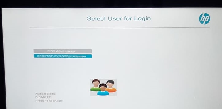

      Re: HP BIOS unlock tool
      Hello folks , hello rethoricalcheese
      i try to unlock this elitebook Revolve 810 G3 ( Bios Administrator ) but no success = No display ,only the fan goes high.
      Do you have any idea or a litlle help .
      thank you
        thank you
        try ... if it works enter the DMI information
          Ok , thank you my friend . i will let you know
