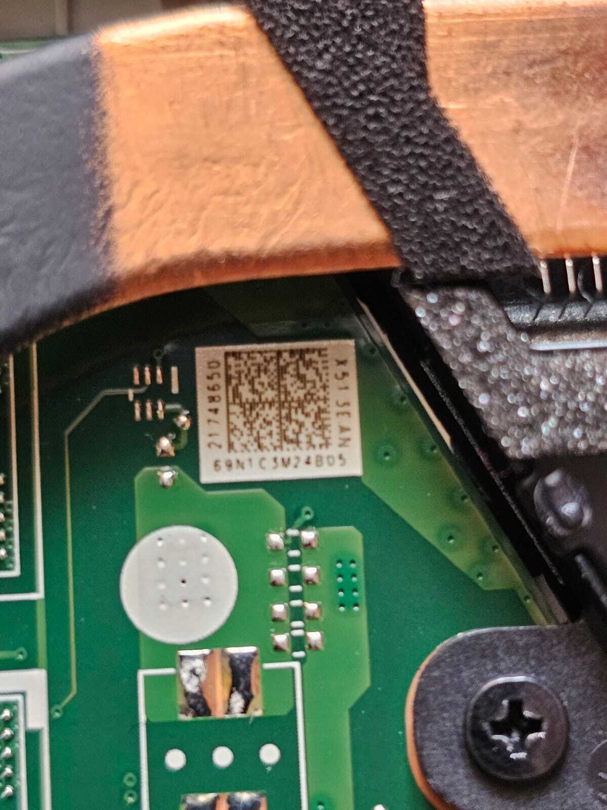

        #103
        Bios corrupt, cannot update with usb drive. Tested and got into bios with virgin bios. K513EA
        MB QR code decode: MA41NBCV00FH9SMB,MA41NBCV00FH9SMB,X513EAN,60NB0SG0-MB3021,532
        SN: MAN0CV20T100438

            Both of you want the X513EAN bios. Use the Asus F1 service bios from post 20, X513EANF1302.zip .Copy your DMI (serial number, windows key) from your backup to the new bios using the attached macro script, instructions are in the README text file.
            If you can use a hex editor these are the offsets: 660000 - 66FFFF .If you want to update from version 302 get the bios update from Asus support - https://www.asus.com/us/supportonly/...helpdesk_bios/
