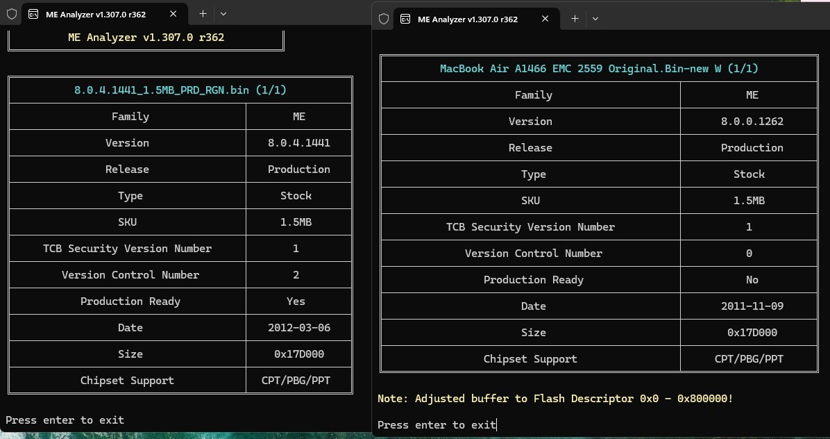

                        Dear buddies., can someone please clean this BIOS. I having problems editing this BIOS. I have no reason why, I think I have to reformat my HDD, too much junk. Kindly clean & update for me, thanks in advance. I have uploaded Original BIOS Bin file.
                        MacBook Air A1466
                        EMC 2559
                        S. No: C02J60BHF2FV
                        Logic Board # 820-3209-A

                          try,,
                          • mferna14
                            • Jun 2018
                            • 1020
                            Originally posted by peste
                            try,,
                            100% working.. Thank you very much. If you kindly check the photo, what wrong did I do, why did my "Intel CleanMe" program pick up the wrong version??? Right one is which I did & the LHS is the one which you edited.
