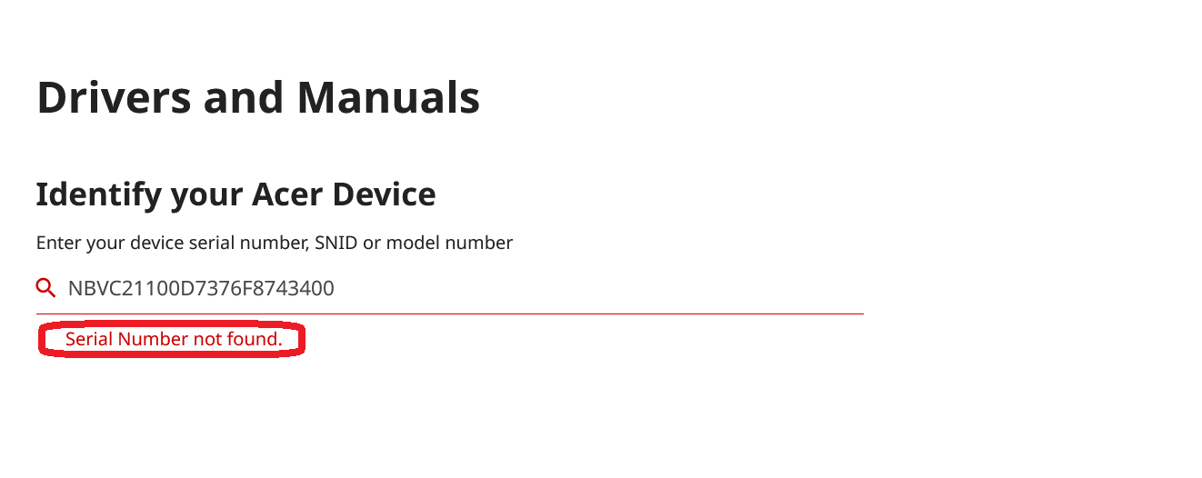

                • lint4u
                  • Nov 2013
                  • 126
                  • lint4u
                  Re: Acer TravelMate P648 LA-D301P help bios dump
                  Hello again
                  Same issue no display with fast fan spinning
                  i thing some one already change the bios because serial number is different
                  here the correct label for S/N : NBVC21100D7376F8743400
                  is it problem different S/N for the blank display ?
                  • Vesko356
                    VIP Moderator
                    • Aug 2018
                    • 4386
                    • Bulgaria 🇧🇬
                    Originally posted by lint4u
                    Hello again
                    This means in your case the problem is not bios related, because you can't find any better bios than this virgin file from the Acer support page for this model.
