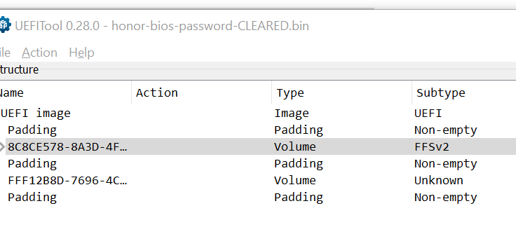

    I have attached the password protected one, can someone remove it or supply another that I can use? Based on Huawei's website I downloaded BIOS from there and trimmed top and bottom to match my one but it didn't work when flashed, it's also attached.

    I suspect some editing needs to be done around Offset 6CB048, I don't know what.

      I've made some changes to the locked file - but will try tomorrow. Let me know what you think.

        I redid the file using this guide:
        https://www.badcaps.net/forum/showthread.php?t=75292
        Based on HONOR_MagicBook_14_BIOS_1.35 file from their website. Hopefully this will work. Can someone correct me by the above link that I extracted the first major part which was about 2.93MB the bottom part is the NvRAM as reported by UEFI tool Alpha 58, but I didn't touch this.

          Both methods did not work. Any advise anyone?

                Hi Claudio, I purchased one off TaoBao website and it worked with missing model and unique info and serial match my bios. Can you merge them together to include this info? I'm sharing the file that works so all can benefit.

                    I'll try shortly, but could you please send a link or just briefly steps you carried out on UEFi tool? Thanks

                      Finally happy days.
