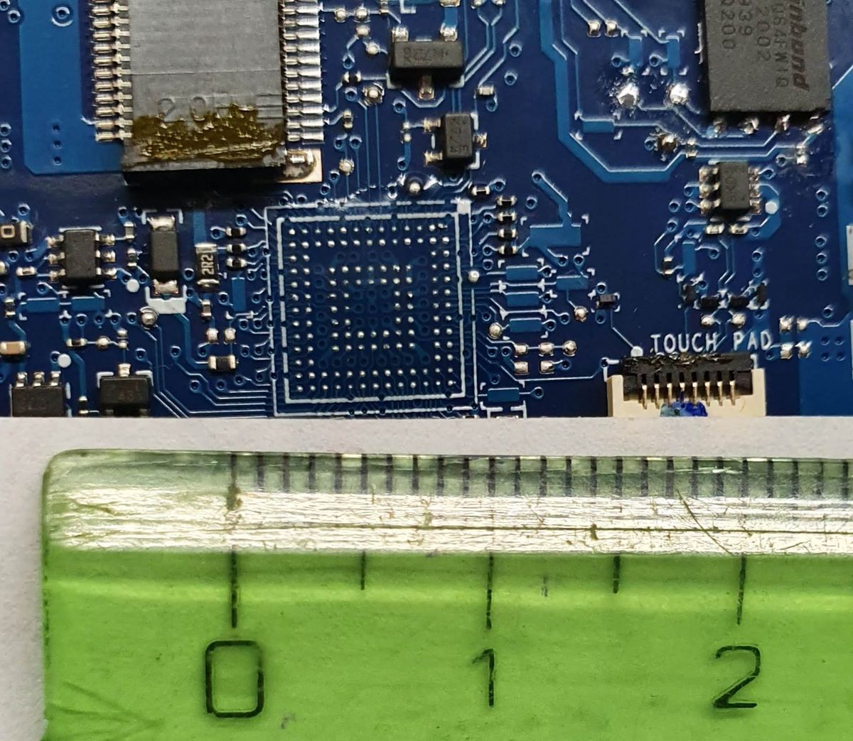

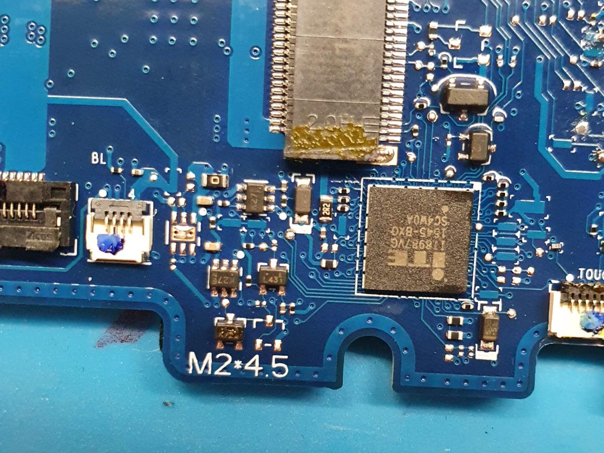

Hi all, having Huawei Honor Magicbook 14 2020 with Ryzen 5 3500U with no boot, no POST. Tried to reflash the BIOS, with no change. After power on it just flashes the white LED next to an USB-C port and keyboard backlight blinking as well. All power rails have correct readings, CPU starts heating and fan spinning later. I'm suspecting EC chip, ITE IT8987VG in BGA case. Any other suggestions what to check? Thanks.

Attaching original BIOS dump, no guarantee of a functionality! Based on a dump analysis, looks like it's BIOS version 1.16
Bios - https://www.badcaps.net/forum/showthread.php?t=101545

Hello guys I have a similar laptop Huawei with ec problem, its coming on and the IT8987VG is getting very hot and no display, so i bought the ec chip but I don't have the pinout for the chip so that I can program it because I have a similar machine with a good ec which I can copy the ec bios. So I need the pinout for IT8987VG if anyone can help. I have seen some schematics with the same chip but does not show the pins on the ic. ThanksComment
