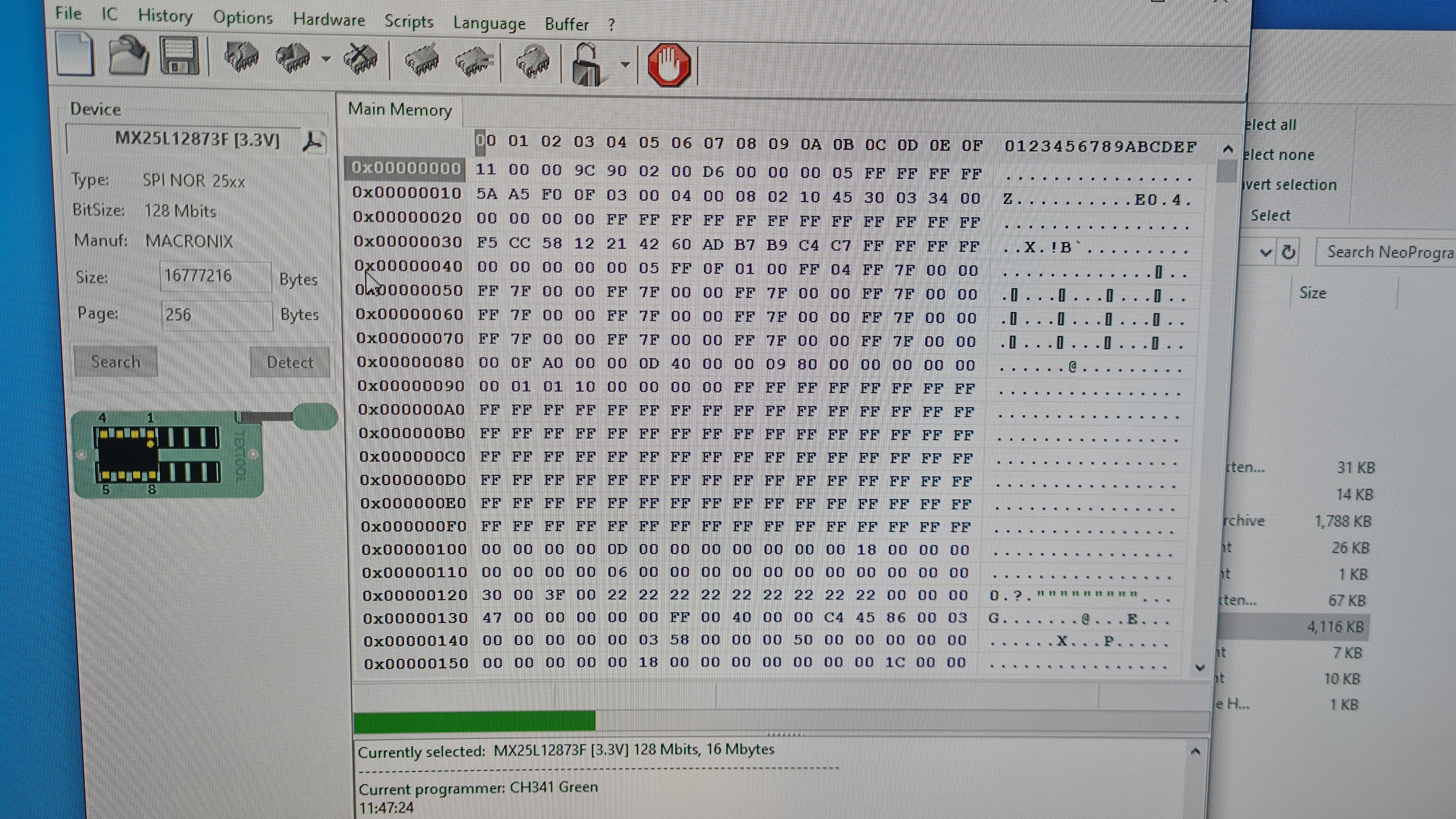

    I need to flash my laptop BIOS with ch341a programmer. I need the bin file (dump). The original file is an EXE file from Huawei.
    Anybody please have the bios file(bin)? the website of huawei gives only the exe only
    I managed to extract the exe but got only .bin: (attached)... which is not the real bios i think....

      post your bios dump and serial number.
      sn: C3JBB20821800202
      Thank you for replying sir/madam.

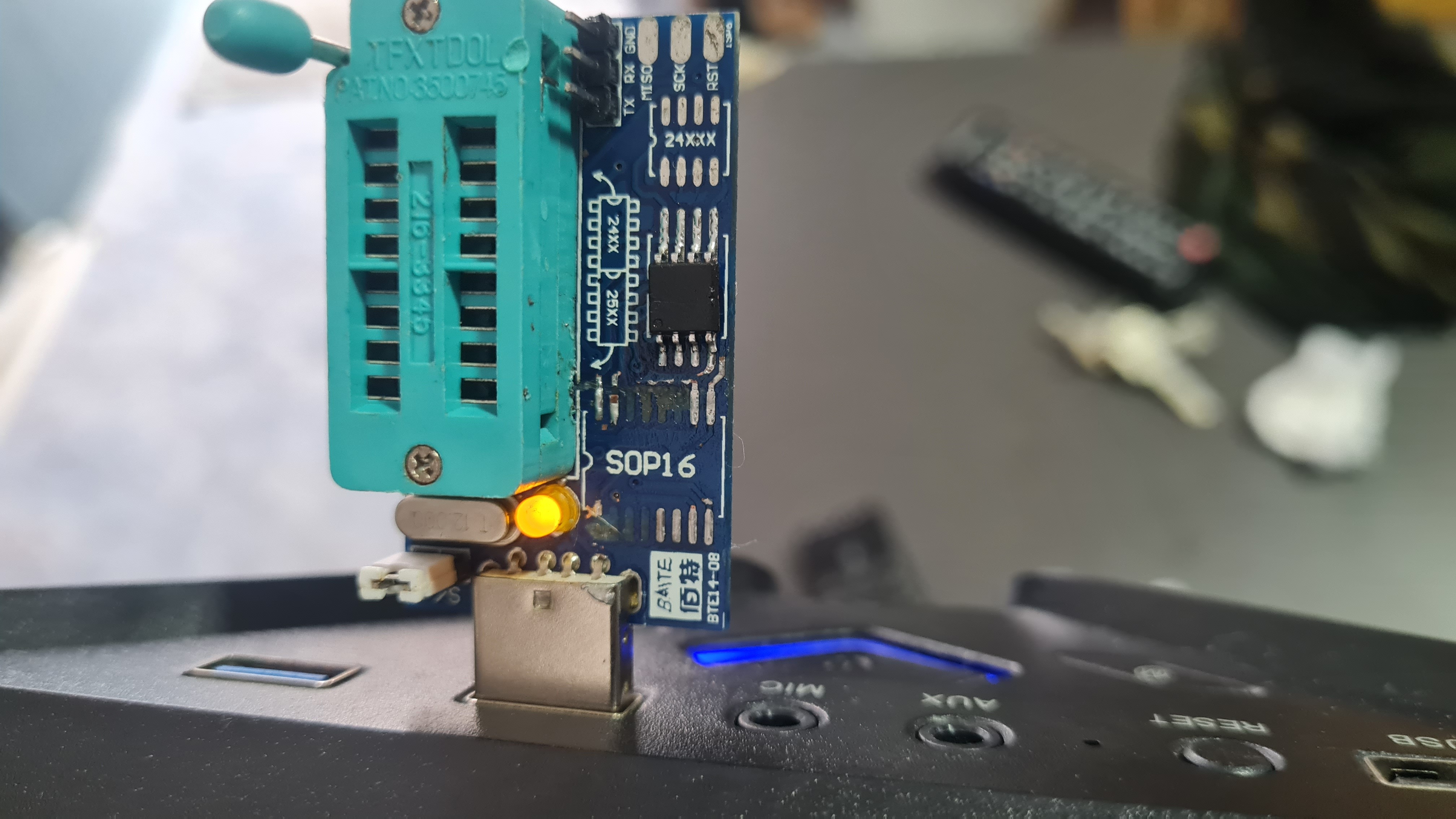

      Actually the bios was locked, that is password protected. Then i tried to dump ....but only 256KB...bin file.(then i knew it was the ch341a default dumping [FFFFFFFFFF everywhere....)...then i used ASPROGRAMMER .
      Cannot detect it when using the clip or the chip is not in the database list.
      What i am pointing out is ...atleast i get the genuine bios then.... i will desolder the chip MX25L12873G....and FLASH it without the clip....however the ASPROGRAMMER list has the "F" version of the chip (specs attached)
      EDIT: laptop charges (blinking white)......but does not power ON.

        you have to desolder bios chipset to write it.
          Thank you sir/ madam.
          I will do the necessary...and will keep you updated.
