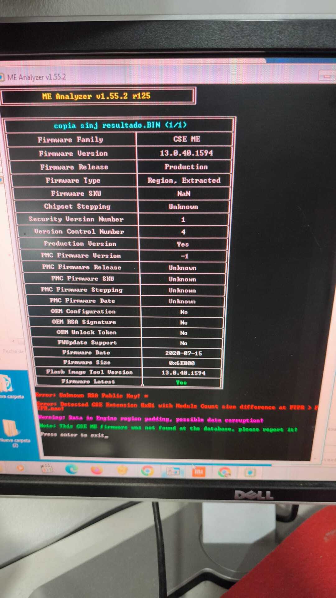

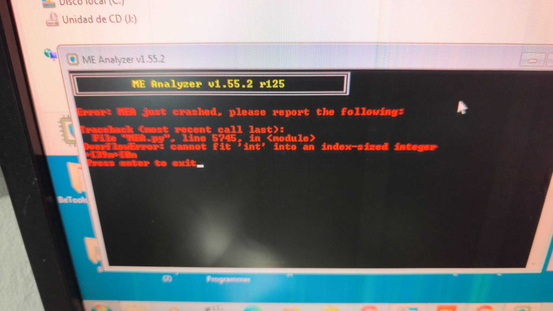

                          #72
                          Originally posted by SMDFlea
                          Backup the bios chip again, open it with ME Analyzer, if it says the File System State is Configured then the PCH hasn`t even read the bios chip, if it`s Initialised the bios has been read. You can try another chip, look carefully at your soldering and for missing parts, then keep checking hardware, get the schematic if it`s available and look at the power sequence.
                          This image is the one that appears when I execute the original file, so I don't know if it was copied correctly or if that bios was already damaged. Regarding the chip, normally the reprogrammer detects when the chip is bad and this is not the case.
                          Let's see if I make a copy of the one I had later and look at it with my analyzer to see what comes out.
                          I put in the second photo the result of the bios
                            • 21679
                            #73
                            Your ME Analyzer version is very old, update to a newer one.

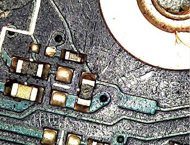

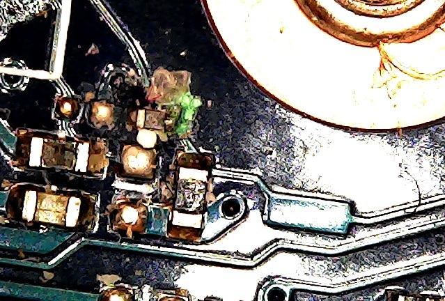

                                        Continuing reading the thread I wanted try the one of #33 and machine finally worked but was really instable and sometimes fan did not spin and machine was blocked with black screen. I sorted out that maybe this was a problem with defective onboard ram so I wanted to reprogram BIOS with the BIOS of # 77 No screen output - cap prob? At first it seems that this fixed the problem but while I was testing with Windows running it shut off for itself and I took a lot of tries to make it work again.
                                        I really didn't know what was going on because mainboard was in good status but while I was examinating I saw just near the CPU a sort of dirt. (see pictures before and next with microscope).
                                        I claned it carefully and next laptop started to works properly.
                                        So I reprogrammed BIOS with the last one of post #33 and next I updated it again via Windows so it update also the EC part.
                                        Finally with U1 Tool I was able to insert DMD.
