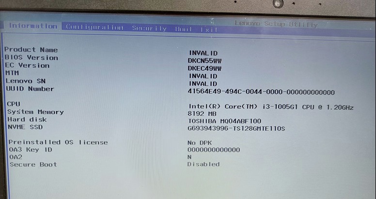

                                  #39
                                  hello
                                  Can someone please fix this bios,
                                  simptoms: no power
                                  i tried other bios from the forum works but random shutdowns
                                  model lenovo V16-IIL 82C5
                                  PF2960XN
                                  mother board: GS44D/GS54D NM-C711 REV 1.0
                                  Intel i3 onboard RAM
                                  Thank you

                                  • 21672
                                  #40
                                  Originally posted by nyknemesis
                                  hello
                                  simptoms: no power
                                  PF2960XN
                                  Thank you
                                  Try the bios at post 33 ,it is a virgin bios. If you can use a hex editor copy your DMI from your backup to the new bios using the offsets that peste has posted. If it doesn`t work try the RAM disabled bios by Stefan Steff above
