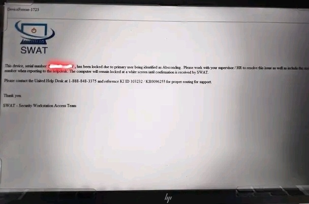

                            can i use tge tool to remove SWAT?

                              Swat?

                                yes, SWAT, mostly hp

                                  SWAT security locked, anti teft enabled

                                    Repeating the same word is of no help
                                    Give us a picture or something.

                                      here is rhe picture, image not mine.

                                        in this case you need to clean the bios and second chip unlock that would be success to unlocked
