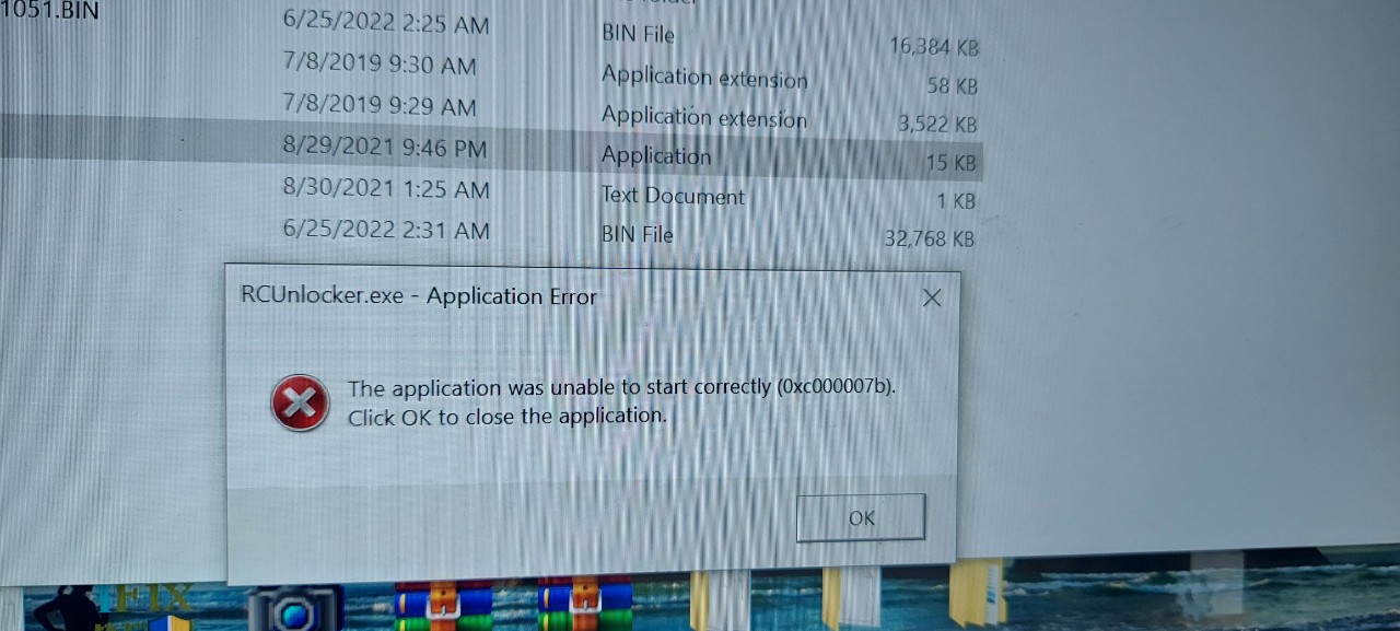

                                Re: RCUnlocker
                                RCUnlocker. not working. why? ( my laptop setup. window 10 64 bit)
                                show sms: Error 0xc00007b “Application was unable to start correctly”
                                every one help me!
                                thanks

                                  • 22157
                                  #436
                                  Re: RCUnlocker
                                  Usage: Drag and drop .bin file to .exe file.
                                  • clrscr

                                    #437
                                    Re: RCUnlocker
                                    yes, but tool not working >> show sms: Error 0xc00007b “Application was unable to start correctly”
                                    can you help me unlock!

                                      • 22157

                                        • 22157
                                        #439
                                        Re: RCUnlocker
                                        thanks!
                                        Search google for the error message "0xc00007b" ,theres a number of reasons why,such as youre tring to run the app on a 32bit OS, the .NET framework is corrupt or not latest version, and more results

                                          #440
                                          Re: RCUnlocker
                                          now it work, thanks!
