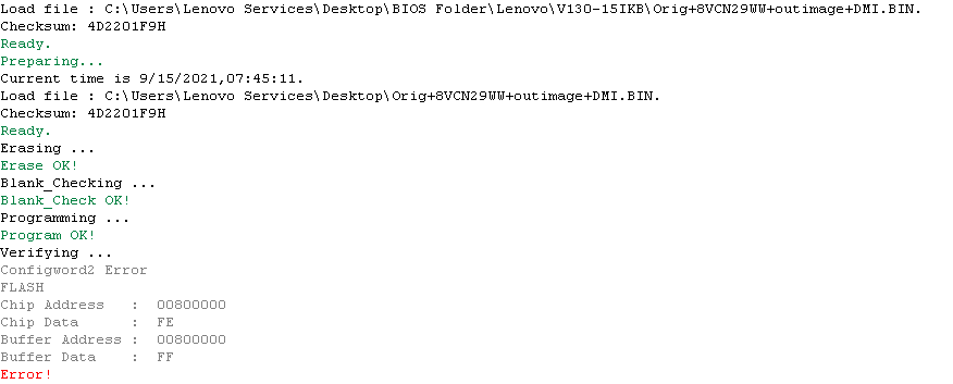

      Re: Lenovo bios V330-15IKB
      Originally posted by Vesko356
      How about answering all the questions?
      In short do it again, use verification, and so on. This dump should work, as you can see it's confirmed working.
      I got this error attached picture

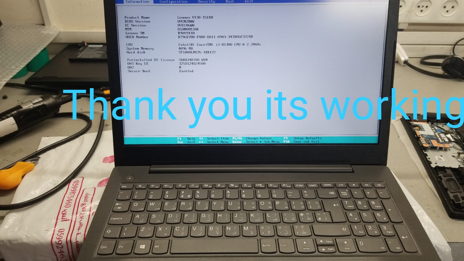

        Originally posted by SMDFlea
        try this older version .
        Thank You Bro,
        i try this its worked but no Display on Screen
          • 20304
          Use a different chip
          • huss584
            Hussein
            • Apr 2020
            • 225
            • Palestine
            Thank You Bro it's working
            Attached Picture

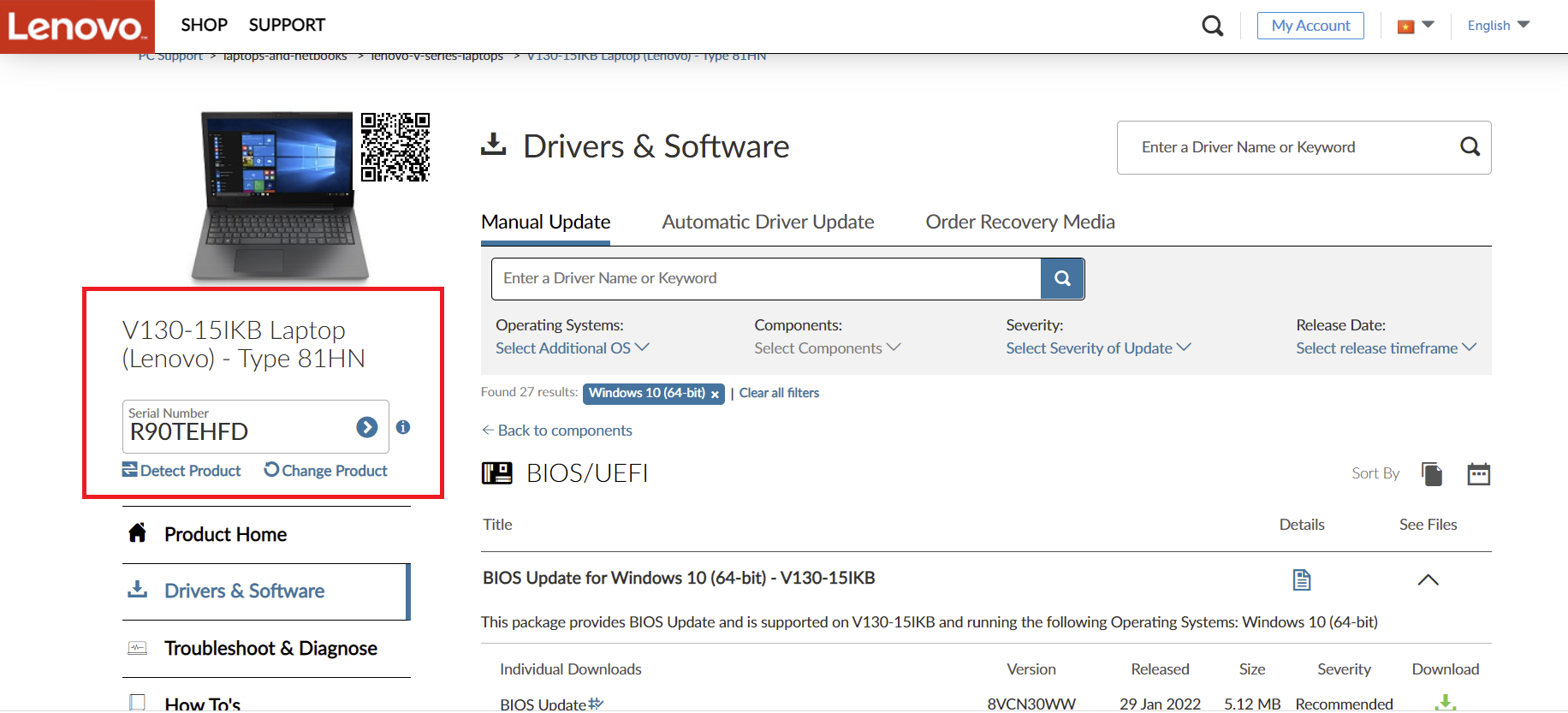

                            #33
                            Re: Lenovo V130-15IKB bios dump
                            Try this bios.
                            hi how are all ...... i have same laptop same problem i have flashed it with this bin the laptop turn on normally all is ok but when i make reboot i have no display can you help me please

                              #34
                              Before flashing someone else's device bios, do you backup your device's bios ?

                                #35
                                Originally posted by hoaca388
                                Before flashing someone else's device bios, do you back up your device's bios?
                                this is
                                • hoaca388
                                  Badcaps
                                  • Jan 2022
                                  • 11191
                                  • Viet Nam
                                  #36
                                  this is
                                  Your serial number ? OK, I had it.
