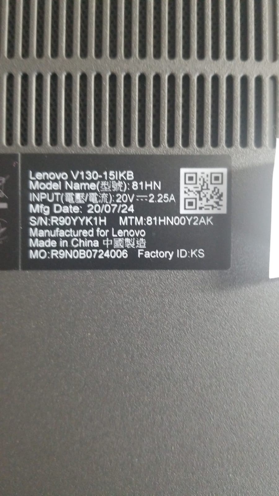

                                Is the serial number on the case R90YYK1H
                                • huss584
                                  Hussein
                                  • Apr 2020
                                  • 230
                                  • Palestine
                                  Re: Lenovo bios V330-15IKB
                                  Yes the SN:R90YYK1H

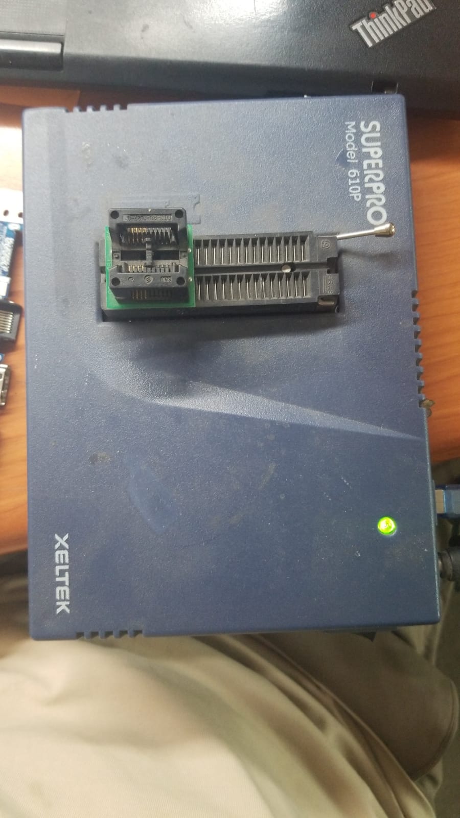

                                    What programmer do you use, also do you read /write the chip in circuit with the clip? Did you verified the chip content after programming?
                                    Become a Badcaps supporter
                                    Thanks to all supporters.​
                                    • huss584
                                      Hussein
                                      • Apr 2020
                                      • 230
                                      • Palestine
                                      SuperPro 610p
                                      • Vesko356
                                        VIP Moderator
                                        • Aug 2018
                                        • 4386
                                        • Bulgaria šŸ‡§šŸ‡¬
                                        Originally posted by huss584
                                        SuperPro 610p
                                        How about answering all the questions?
                                        In short do it again, use verification, and so on. This dump should work, as you can see it's confirmed working.
