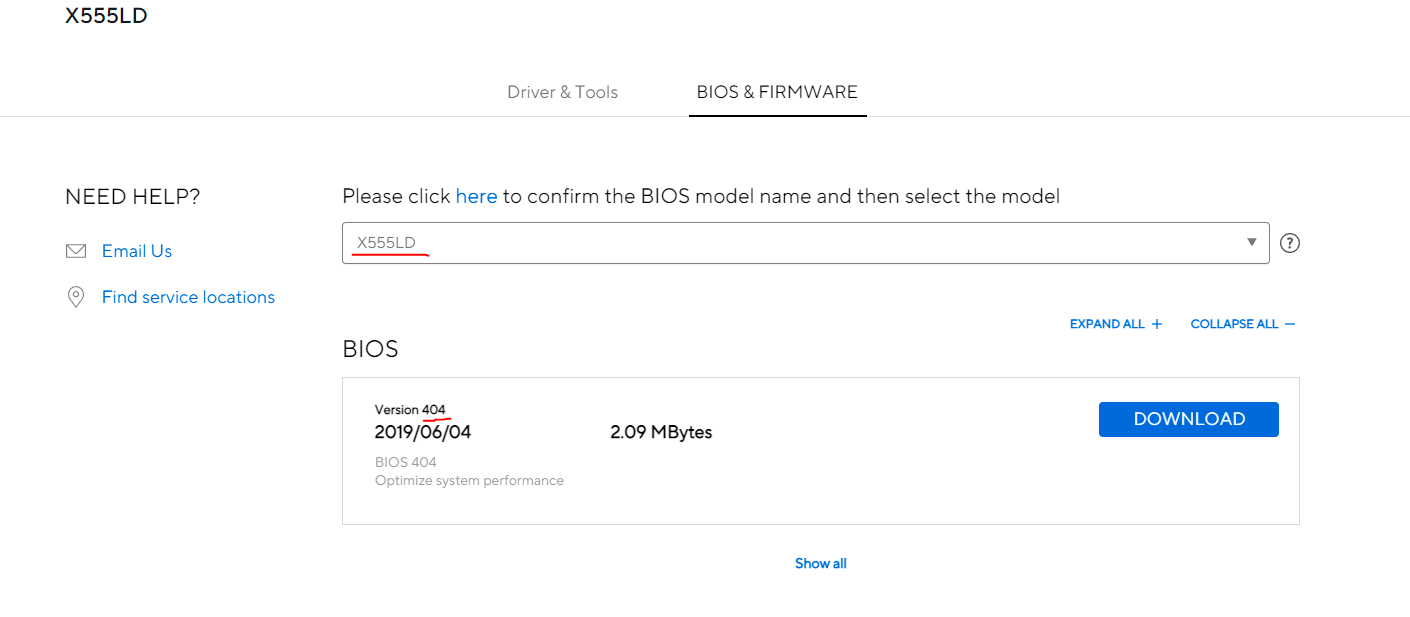

I think this ASUS X555LD motherboard has the most BIOS versions. Couple more BIOS versions also applicable for this motherboard are: X555LAB, X555LN, X555LNB, X555LD, X555LDB.

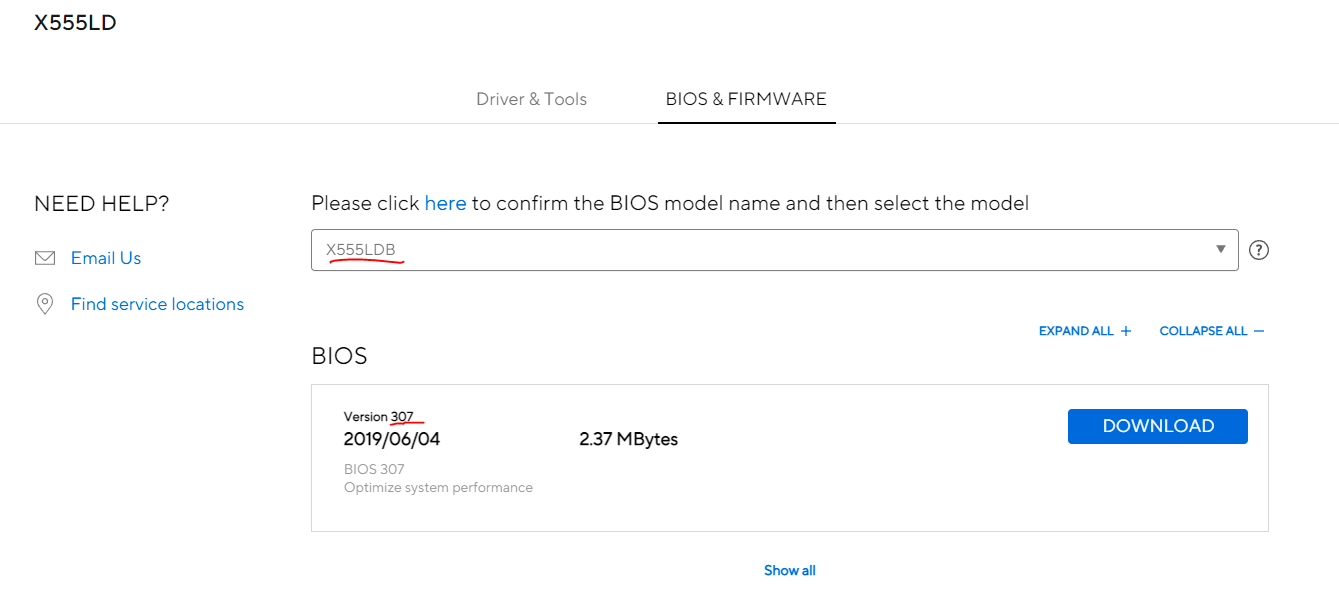

Next, now you know the correct version of the BIOS that goes into your motherboard, go to ASUS support website or search through Google if you don't see the specific model on ASUS website, and download BIOS for the notebook model written on the sticker. If it is written X555LA on the sticker than type X555LA and download BIOS that says X555LA.

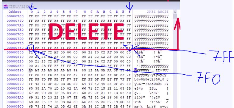

Now, you will have to use this great guide, again from Win-Raid forums, that is being constantly updated with new stuff. Follow D3. ME 7 - 10 & TXE 1 - 2 paragraph with a little bit of changes which I will tell you now. Skip the preparation of ME region because we already did that. Go all the way to the step 7, here is where we make one change. Unpack and copy previously downloaded BIOS from ASUS website to the FITC folder and also copy clean ME region file. Open the extracted ASUS file in HEX Editor and delete first 2KB of it. Almost on all downloaded ASUS BIOS files you need to delete first 2KB. You can also compare the 2 files in HEX editor and make the downloaded file from ASUS start exactly like BIOS Region.bin file.
Now you only have to remove original BIOS Region.bin file and ME Region.bin file from the folder and rename your files exactly like the ones you removed.
