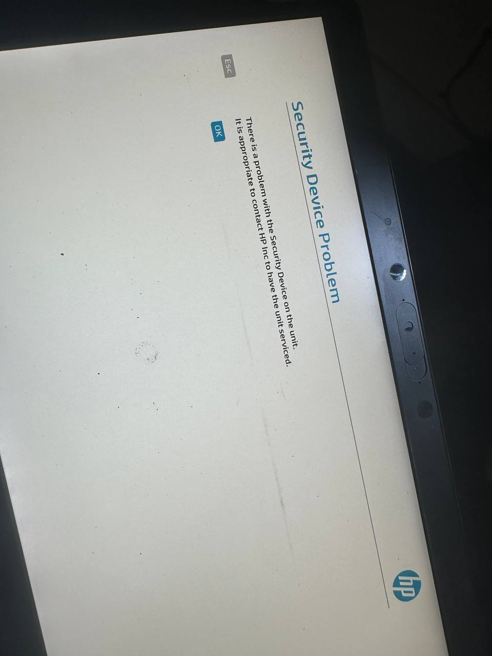

                                  hi please help me remove this security
                                  SN: 5CG905327Y

                                      send me file EC
