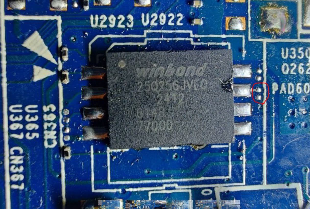

          #444
          Dear Blaze Tech and others
          I broke my W25Q256JV bios (phisically) from HP EliteBook 840 G5 6050a2945601-mb-a01
          May I ask for BIOS for serial number 5CG013DSCM ProdID 2FA66AV please?
          I tried adjust bios bymyself to change Serial Number with HEX but still I have issue CPU fan spins at maximum speed.

                                • Karol Wu
                                  • May 2025
                                  • 5
                                  • Poland
                                  #457
                                  For those who need a clean BIOS (no passwords, factory defaults, without DMI) for the HP EliteBook 840 G5 (6050A2945601-MB-A01):
                                  Since nobody here could help me, I turned to Wrong Chip on YouTube (link below). Here's my experience for others facing similar issues:
                                  1. These BIOS files work—I successfully flashed both by CH341A (modded from 5V for 3.3V!) by Neoprogrammer on Windows:
                                    • 32MB chip (W25Q256JVEIQ)
                                    • 16MB chip (W25Q128JVPQ)
                                  2. My W25Q256JVEIQ BIOS was corrupted (physical damagel). You can use my files, but they do NOT include DMI data (you have mine attached for serial 5CG013DSCM​)
                                  3. DMI Solution: Wrong Chip provided my DMI data, which I injected using the method shown in this video:
                                  4. Boot Failure? Another reason my laptop wouldn't turn on was accidentally removing the 22-ohm resistor. If your motherboard is unresponsive, double-check all resistors!

                                    #459
                                    2. My W25Q256JVEIQ BIOS was corrupted (physical damagel). You can use my files, but they do NOT include DMI data (you have mine attached for serial 5CG013DSCM)
                                    Click image for larger version  Name:	HP840G5.jpg Views:	52 Size:	156.9 KB ID:	3647994
                                    Reupload 2x missed packages to flash as new BIOS
                                    My DMI if you don't have yours you can try as above YouTube movie after start
                                    Serial Number: "5CG013DSCM" SKU Number: "2FA66AV"
                                    Board CT Number: "PGWHT00WBDH1KY"
                                    Product Name: "HP EliteBook 840 G5"
                                    BuildID: "17WWCSDT601#SABD#DABD"
                                    Feature Byte: "3X476J6S6b7B7H7M7Q7W7m7saBaEapaqauawbUbhcAdUdpdqfPfXhKhkjh.fm"
                                    MAC Address: "10-62-E5-56-A7-0D"
