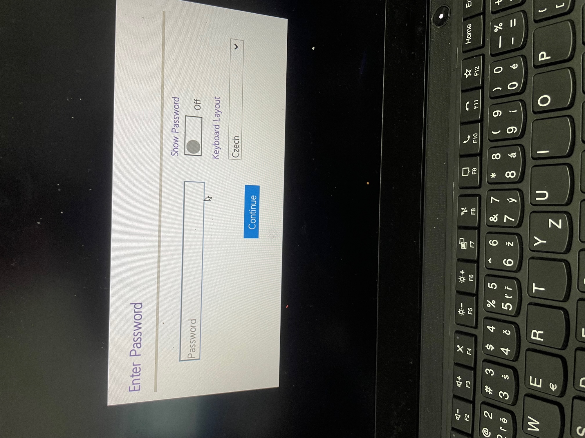

ThinkPad T14 Supervisor password
  • testinglaptops
    replied
    Originally posted by mtherana
    Can someone please help remove Supervisor password,
    I tried lenovo patcher ver 0.2 with no success on 3 of my backups i have installed also python 3.8 I drag the dump to the patcher but nothing gets generated
    Lenovo T14 Gen 1
    Model type : 20S1-S73B0B
    SN: PF-2PK27T
    Password in SIO. you need vertyanov successor or Svod 4 programmer.
    Leave a comment:
  • mtherana
    replied
    Can someone please help remove Supervisor password,
    I tried lenovo patcher ver 0.2 with no success on 3 of my backups i have installed also python 3.8 I drag the dump to the patcher but nothing gets generated
    Lenovo T14 Gen 1
    Model type : 20S1-S73B0B
    SN: PF-2PK27T​
    Leave a comment:
  • TigTex
    replied
    Originally posted by KABY
    Hello guys
    There some informations about lenovo thinkpad new generation laptop
    ​​​​​​I1st option is usual jtag
    2nd one is that you can modify bios bin in certain lines addresses and those modifications can delete the password
    I found this on the internet maybe it's possible maybe it's not
    If someone Can confirm that
    Modifying the bios is only possible on old models. This topic is for the T14 which requires MEC1663 JTAG and a programmer compatible with it
    Leave a comment:
  • KABY
    replied
    Hello guys
    There some informations about lenovo thinkpad new generation laptop
    ​​​​​​I1st option is usual jtag
    2nd one is that you can modify bios bin in certain lines addresses and those modifications can delete the password
    I found this on the internet maybe it's possible maybe it's not
    If someone Can confirm that
    Leave a comment:
  • ihameed64
    replied
    Originally posted by danito
    Can you help me with a JTAG connection diagram for T14 gen1 Intel CPU?
    This is the wrong thread. You have to look up MEC1663 JTAG Pinout in search.
    Leave a comment:
  • testinglaptops
    commented on 's reply
    I have rt809h but its not reading 1663, error is no chi detected, I tried all methods. does any extender for jtag to attach with rt809h? please full guide A t Z how to program 1663 with rt809h. thank you
  • danito
    replied
    Can you help me with a JTAG connection diagram for T14 gen1 Intel CPU?
    Last edited by danito; 12-15-2023, 06:47 AM.
    Leave a comment:
  • ihameed64
    replied
    Originally posted by simkard
    Re: ThinkPad T14 Supervisor password
    So just to sum it up and be sure that I've totally understood how these new models are built/working regarding the supervisor password removal :
    After reading/writing MEC16xx chip with a blank/empty dump, there are some things that needs to be reconfigured.
    Technically, from my understanding, MEC16xx chip contains these informations (nothing else to declare ?) :
    • Machine type
    • Model Type
    • Country code
    • S/N / Serial Number
    • BIOS/Supervisor password
    • Computrace informations maybe ?
    While using the Lenovo HMD (Hardware Maintenance Diskette) v1.90, there are ways to fulfill these informations using option 20 or C0 and typing this sequency : 1STTTTMMMMCCSSSSSSSS which is composed of :
    • TTTT > Machine type
    • MMMM > Model Type
    • CC > Country code
    • SSSSSSSS > S/N / Serial Number
    So chronologically, steps would be :
    1. Solder wires on JTAG pins (close to the MEC16xx chip on the motherboard)
    2. Write an free from password dump of a MEC16xx chip
    3. Boot on the Lenovo HMD (hopefully no BIOS errors will be preventing from booting on an USB stick at that time)
    4. Use the option "20" or "C0" to fulfill the informations into the MEC16xx chip memory
    5. That's it ?
    Am I correct ?
    Question Simkard ---> If the serial number and/or the model type &/or machine type are in the ballpark (i.e. from a T-14 Gen 1) but not the exact one for the machine being fixed, what happens then? Would it affect things like the proper functioning of the power button for example?? I have a case where a T-14S Gen1 machine is functioning properly in every way after a Supervisor Password delete utilizing a Vertyanov Successor programmer but the serial number, model number and machine type numbers are wrong. The physical power button does not work. Also, the shutdown function in W10 Pro does not work but sleep does as well as restart. I am able to use the Microsoft Update function (was able to load and update W10 pro through various update iterations no problem) so that means the machine does completely shutdown but doesn't remain shut. I have already removed Fast Restart from Windows. Can you provide any help whether tinkering with the EC has somehow now disabled the power button?
    Leave a comment:
  • ordinateur
    replied
    Re: ThinkPad T14 Supervisor password
    Will have to look in the RT809H forums as there I see that even RT809 can write these EC or chips or what are these, otherwise I don't believe that just SVOD or Vertyanov can handle these chips and RT809H no.
    But the worst thing is that the forums are in Chinese and I am not managing to even register on there, but I am just translating the sites with Google....
    Leave a comment:
  • zomi
    replied
    Re: ThinkPad T14 Supervisor password
    no resistors for ite are needed
    Just make sure you line up cable properly
    Sorry forgot to add all done with vertyanov.
    Last edited by SMDFlea; 10-06-2023, 04:44 AM. Reason: Merged 3 seperate posts
    Leave a comment:
    replied
    Re: ThinkPad T14 Supervisor password
    Originally posted by ordinateur
    Yes , sorry, but I saw that my board doesn't fit in coolshrimps tutorial as it has MEC chips, but this board of mine has ITE chips and seems that it can be done via KBC connector only, and the R/W resistor which I am not knowing the position of that resistor.
    I don`t think you have to move any resistors for the ITE chip, don`t know for sure never worked on one of these.
    Leave a comment:
  • ordinateur
    replied
    Re: ThinkPad T14 Supervisor password
    Yes , sorry, but I saw that my board doesn't fit in coolshrimps tutorial as it has MEC chips, but this board of mine has ITE chips and seems that it can be done via KBC connector only, and the R/W resistor which I am not knowing the position of that resistor.
    Leave a comment:
    replied
    Re: ThinkPad T14 Supervisor password
    Originally posted by ordinateur
    Can you send JTAG pinouts please or can I use KBC connector? I have RT809H and want to try it...
    My motherboard is this in picture, anybody know pinouts for JTAG or can I use KBC connector with RT809H?
    Laptop model is T14 GEN1 with Ryzen processor
    You`ve already asked in the T14s thread.......
    Read the rules...........
    You MUST NOT:
    • Hijack threads unrelated to your request
    • Post a request in multiple threads
    • Post a request multiple times
    • Post in foreign (non-English) languages
    • Share private contact information
    • Offer payment of any kind whatsoever
    • Bump your thread or post more than once every 48 hours. If you do so
      you will receive an infraction
    • Post "clean me", "clear bios", "clean bios", "bios need", "clear me" or other such terms
    Leave a comment:
  • ordinateur
    replied
    Re: ThinkPad T14 Supervisor password
    Originally posted by 69d0b913
    After a lot of persistence I was able to remove the bios password from T14! I believe that few here know how to do it and no one shares it, I understand that certain types of information are not shared and are sold! But I persistently come to inform you that the (Thinkpad T14 1st 20S1) was unlocked by an RT809H the only programmer I have. Here are photos in the attachment, now all that remains is to reverse the bios information, but I had taken a photo first of all.
    Can you send JTAG pinouts please or can I use KBC connector? I have RT809H and want to try it...
    My motherboard is this in picture, anybody know pinouts for JTAG or can I use KBC connector with RT809H?
    Laptop model is T14 GEN1 with Ryzen processor
    Last edited by ordinateur; 10-04-2023, 09:16 AM.
    Leave a comment:
  • ordinateur
    replied
    Re: ThinkPad T14 Supervisor password
    Originally posted by Tech_57
    Hello
    where to buy good hardware RT809H?
    I bought mine at Aliexpress full set with more than 50 parts. Very satisfied with this product
    Last edited by ordinateur; 10-01-2023, 04:47 AM.
    Leave a comment:
  • ordinateur
    replied
    Re: ThinkPad T14 Supervisor password
    Originally posted by santoslao
    Has anyone read the EC IT8300 chip, from thinkpad T14 AMD, using RT809? Mine is giving an error and even with everything right, would there be any other modification on the board that I do to make the reading? I don't have vertyanov and I don't have svod.
    Hi bro ,
    Can you tell me what is that Black cable staying above the PCB board near the GND writing? or it was just accidentally put there?
    I have the same parts (received with RT809H) that I want to try with RT809H and KBC to remove the password from Lenovo Thinkpad T14 Gen1 model
    Also can you tell us the position of the R/W resistor on this model of laptop?
    THanks
    Leave a comment:
  • gsm4all
    replied
    ThinkPad T14 Gen2 pass
    Hello, i have one T14 GEN2 with bios password
    HT4B0/HP4B0/HT5B1/HP5B1/HT4B2
    NM-D353 Rev: 1.0
    readed with ch341a 2 chips
    i have also Vision programmer /vertyanov/
    who can help me to unlock it?
    tnx
    or anobody with jtag pinout for MEC1503-EA2 on this board?
    Last edited by gsm4all; 08-31-2023, 03:31 AM.
    Leave a comment:
  • santoslao
    replied
    Re: ThinkPad T14 Supervisor password
    Originally posted by ajbernasko
    RT809H worked for me for T14 Gen 2 via JTAG, but unfortunately secure boot is grayed out in bios. Please can someone help with the bios molding ? I'll post my back if needed
    hello friend, Could you post pictures or schematic of the jtag in this model?
    Leave a comment:
  • santoslao
    replied
    Re: ThinkPad T14 Supervisor password
    Originally posted by karem adel
    Please help
    NM-C931
    T14 I5/10
    need patch
    Patch is not possible on 32mb models, this model's bios password is in MEC1663
    Leave a comment:
  • karem adel
    replied
    Re: ThinkPad T14 Supervisor password
    Please help
    NM-C931
    T14 I5/10
    need patch
    Leave a comment:
  • badzymandiaz
    Thinkpad P14s Gen 4, BIOS Supervisor Password
    by badzymandiaz
    I have a laptop that was purchased second-hand, and I am able to boot Windows on and extract the BIOS dump (ONLY the BIOS region, I was unable to dump anything else due to an FCERR I received trying to dump the other regions) and use normally. However, because the BIOS is locked with a supervisor password, I am unable to use anything else except for Windows, and it has also disabled some hardware features of the laptop itself, such as the fingerprinting module, etc. that I really do wish to use.
    I have been digging around for nearly 2 weeks trying to find any mention of the same model...
    09-28-2025, 10:49 AM
  • Andreasandreou
    Lenovo Thinkpad T14s GEN 4 Supervisor Password Bypass
    by Andreasandreou
    Hello, I have Lenovo Thinkpad T14s GEN 4 serial number GM-0FK2ER laptop. It was brought to me by a customer to reinstall windows. The problem is it is locked with a superviser password. Can anyone please give instructions on how to reset the bios or bypass the supervisor password? Thank you.
    09-02-2025, 09:45 AM
  • vijayppatel017
    Lenovo Thinkpad X13 Gen 6 BIOS Supervisor Password Remove
    by vijayppatel017
    i have Lenovo Thinkpad X13 gen 6. with supervisor password enable. anyone know how to remove it. as i am starting this thing first time so dont know. but i am good in solder.
    10-12-2025, 09:04 AM
  • Badpatch02
    Thinkpad X380 Yoga supervisor password removal + Intel ME removal question
    by Badpatch02
    Hi all, I'm new here, a few words about myself: CS student, interested in hardware stuff too - tinkering my whole life but with practically no experience when it comes to firmware "hacking".
    So I have this X380 Yoga with a supervisor password in place and before doing anything stupid I figured I'd rather ask.
    I plan on using the tool from this thread: https://www.badcaps.net/forum/troubl...password-remov...
    11-30-2024, 05:22 AM
  • AppleLover123
    Lenovo Yoga X380 22LH Supervisor Password removal
    by AppleLover123
    Hey guys,
    have a laptop here that has a supervisor Password (dump in Attachements).
    Before i write the Serial NR.etc i wanted to say that strangely after flashing with 3 different Bios dumps and one from lenovos site
    the laptop works but everytime it wants me to type a supervisor password i never set.
    I thought the supervisor password is stuck in the ec bios but no it isn't either because after replacing the ec chip from one of another board it still has the supervisor password.
    Anyway i wanted to ask what of the two chips is the ec bios because on the left...
    04-17-2025, 03:42 PM
