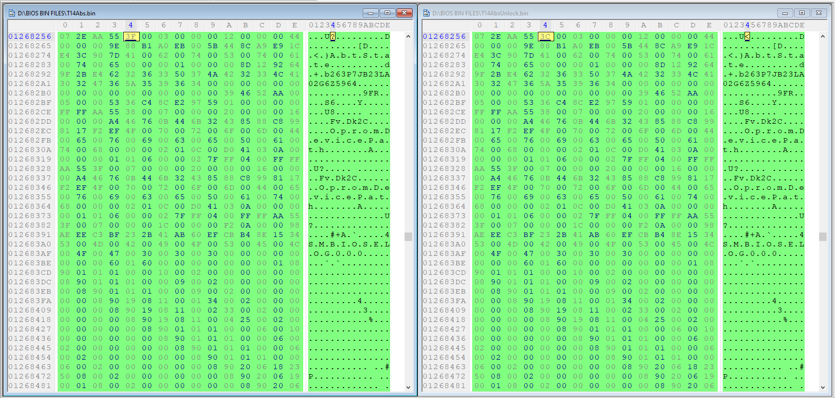

    Hello, Found how to remove abtstate on the laptop by checking on the p53 post that was shared. Here is what i changed to remove that.
    Thanks for the helpful posts!

      Originally posted by Carrie Takamiya
      Hello, Can somebody help me remove Absolute Persistence from this bios.
      Lenovo Thinkpad T14 Gen1 i7
      Serial Number: PF-22ABKR
      Type Number: 20S0-002VUS
      Motherboard Number: GT4A0/GT5A1/GP4A0/GT4A2 NM-C931 REV: 1
      Thanks in advance!
      Click image for larger version  Name:	image.png Views:	0 Size:	8.9 KB ID:	3579326
      not sure that the PC will restart with this generation.
      you have to try
      edit : I didn't see that you responded to the post yourself​
          It also worked on T14 gen 1 AMD NM-C801.
          Thanks!
