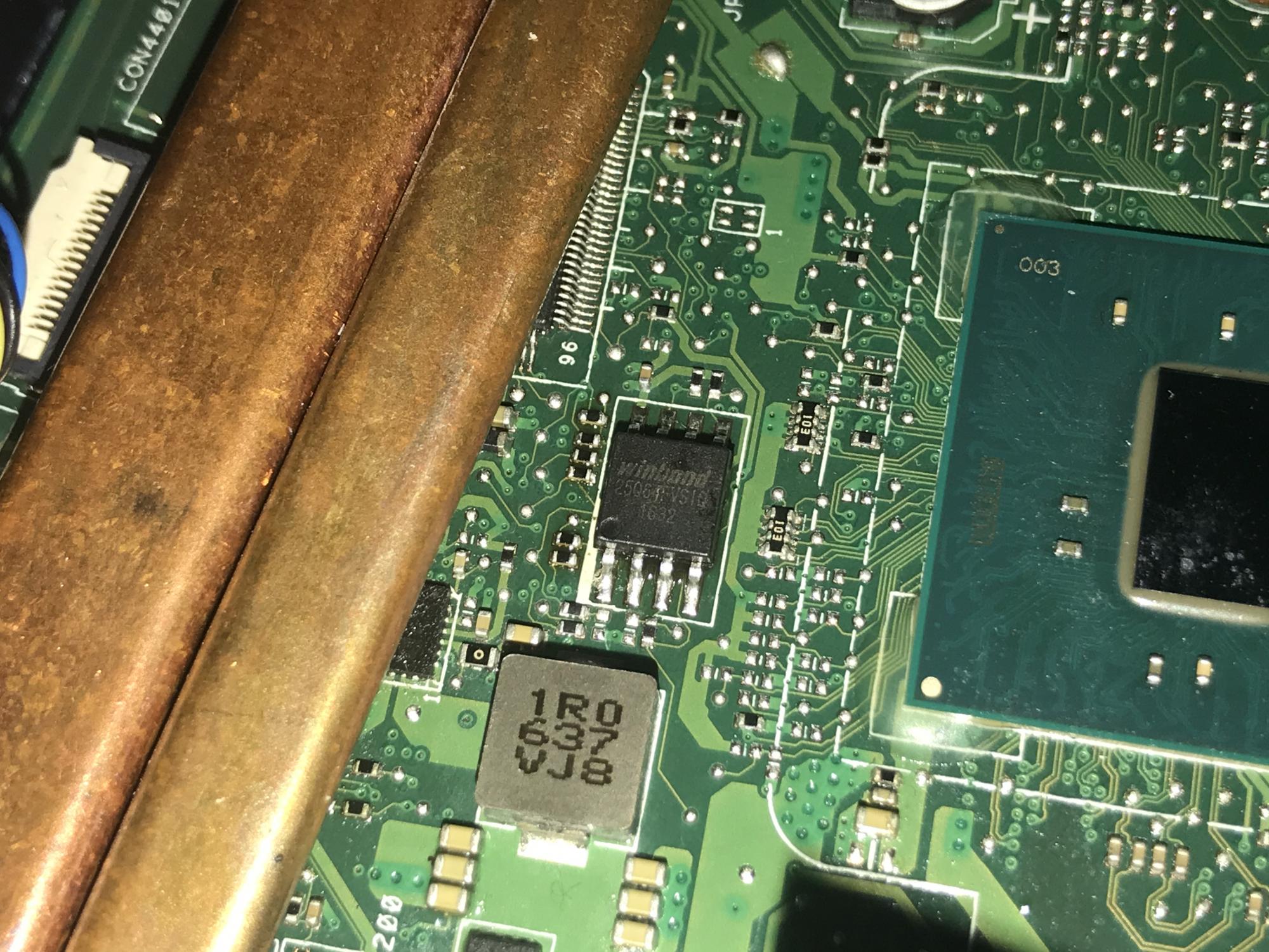

    help me ...i need bios GL553 rev 2.0, this my bios whit no display
  • digitalpc
    • Jun 2016
    • 305
    • .DLL
    Bios dump Asus GL553VW rev 2.0
    Hi Can, anyone help with bios for this model Bios
    GL553VW rev 2.0
    Problem is no display, I was trying to clean bios because late screen, but after that no display at all with 2 files.
    I try some bios posted here in forum not working anyone.

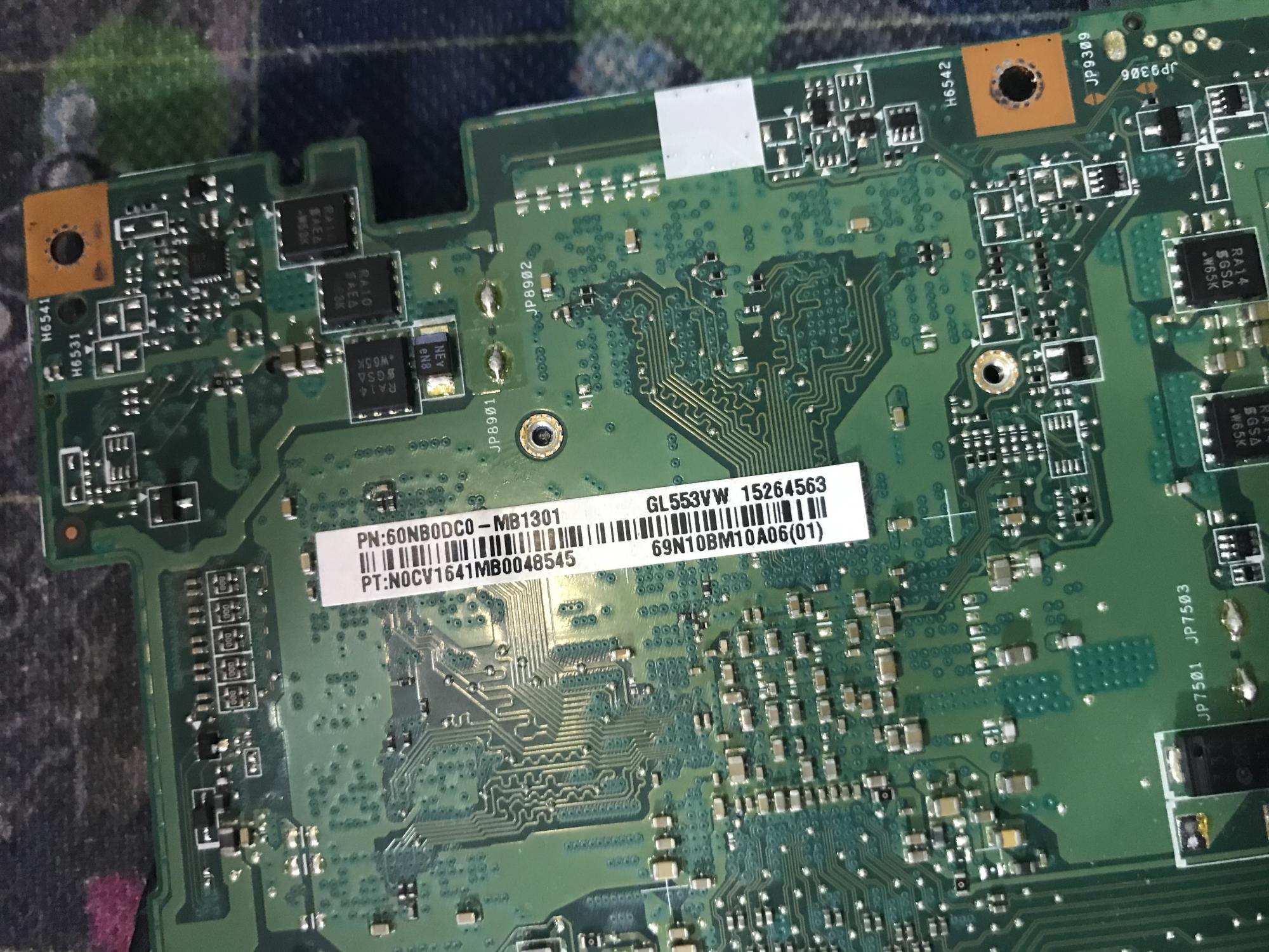

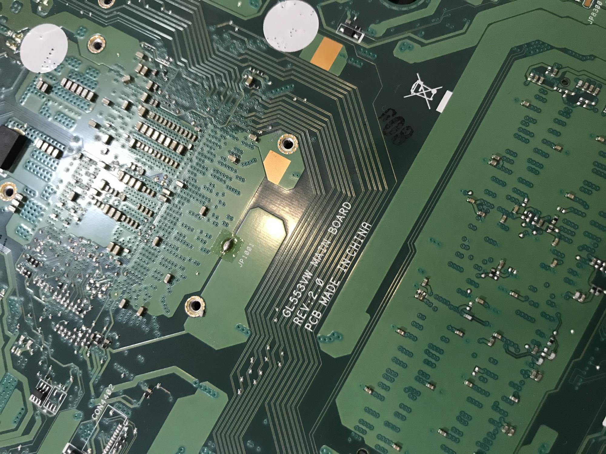

      Re: Bios dump Asus GL553VW rev 2.0
      Here is model based in motherboard sticker
        try this one .
          Originally posted by SMDFlea
          try this one .
          Working now I have display, but laptop turn off trying to install windows, or botting windows
          I try different hdd
                You probably have one/both failing CPU large capacitor or a failed Phase Mosfet. (usually the 2nd, middle one)
                You can confirm this by loading a command line linux from an usb in a "knoppix acpi=offsafe" mode, then: (this will allow only one thread on cpu to load)
                1. start a cpu load test. (it will be perform on 1 thread and 100% load fine)
                2. then start knoppix linux command line with normal mode and starting a cpu load test up to 8 times (8 CPU core thread).
                At one point you probably have an instant shutdown.
                (Usualy about 4 or 6)
