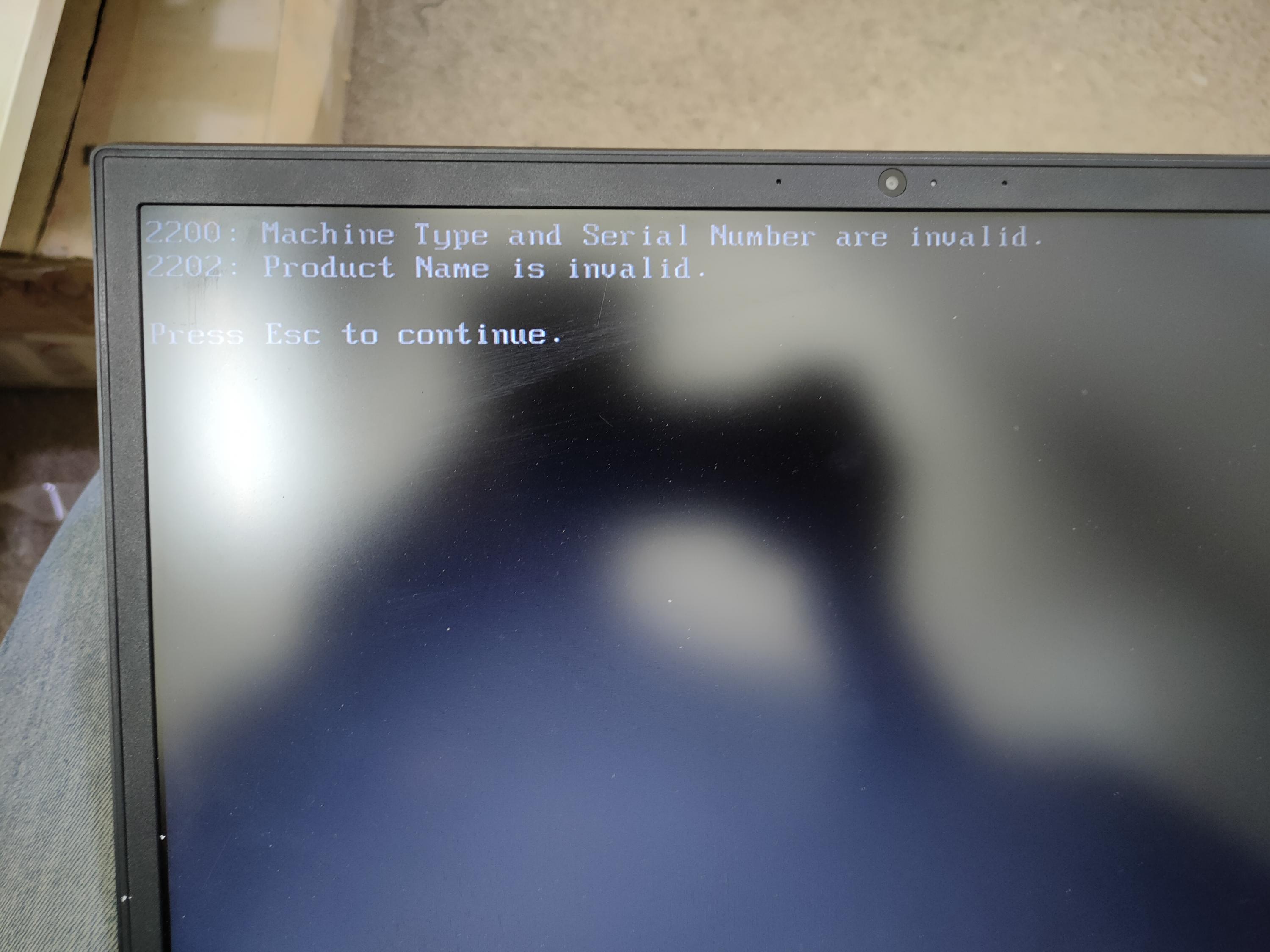

                        Hi, do you have a solution with this one? I have done (bad) flash on my e590 and it stopped(Waited 1 hour but never finished the flash). I turned the laptop off and now I have the 0285 (TCG error) sound. With CH341 black and NeoProgrammer V2.2.0.8 I dumped my bios, tried to flash another bios from internet (no success) and returned to my original bad bios dump.. Please can you help?...

                          What is your machine type ? ThinkPad E590 (Machine types: 20NB, 20NC) ?

                            Thank you for the quick reply! It is 20NB-005HGE
                            MB:
                            FE490/FE590/FE480 NM-B911
                            Rev:2.0
                            2019-01-17
                            Vendor:HSB

                                This is it!!!! It worked!!! THANK YOU VERY VERY VERY MUTCH!!!!!!!!!!!!
                                I tried so many thins for days and didn't worked. If it is not to much to ask, can you teach me a little if this happen in the future, what can i do to do it myself? Tank you once again!!!

                                  I have consulted how to do it from many video sources on youtube in both Vietnamese and foreign languages, so I don't know where the instructions are. The keyword I set is: “How to extract bios .bin file from .exe file". Also learn about decimal, binary and hexadecimal strings.
