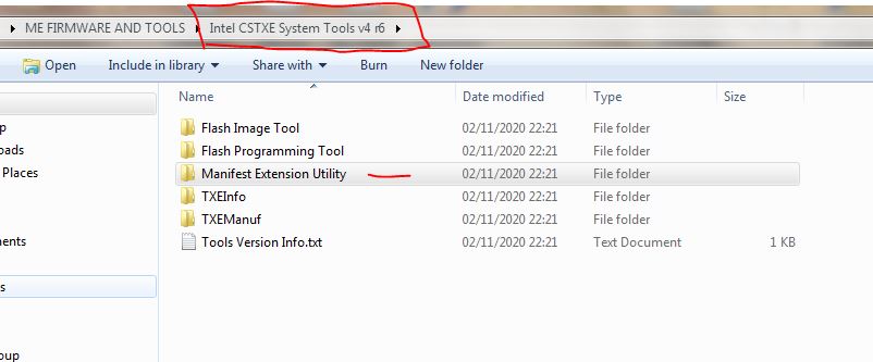

                                      Re: EPK50 LA-G073P Bios dump need
                                      Thank you for the ec
                                      Error 7: [SMIP Controller] Invalid Manifest Extension Utility path. Manifest Extension Utility path set to: ''
                                      Error 6: [SMIP Controller] Failed to sign SMIP data.
                                      Error 37: [Ifwi Actions] Failed to build SMIP data.
                                      Error 19: [Ifwi Actions] Failed to prepare OEM SMIP data.
                                      Error 12: [Ifwi Actions] Failed to prepare one or more IFWI components.
                                      Error 15: Failed to build.
                                      Failed to build!
                                          Failed to build!
                                          Platform Protection -> Platform Integrity ,it has an OEM public key hash .
                                          https://winraid.level1techs.com/t/gu...lization/31277
                                          D4. CSME 11 - 15 & CSTXE 3 - 4 .Follow step #7 carefully,you will need to install openssl to generate a key,and do a little hex editing.Its quite hard to do this until you get used to it.
                                          The Manifest Extension meu.exe is included in the System Tools folder
