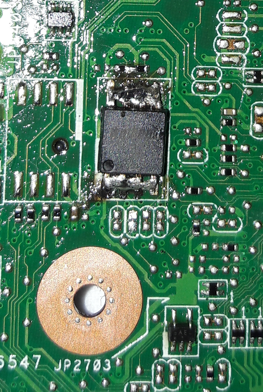

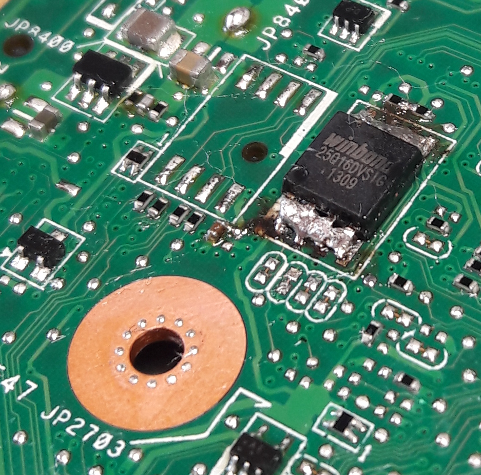

                          • hoaca388
                            Badcaps
                            • Jan 2022
                            • 12406
                            Originally posted by markus24
                            thanks, I used the .bin from hardware1 and soldered the chip back to the board. Does it look alright or should I resolder it again? I'm not sure how it's supposed to look like as it's my first time doing this
                            What's the hell going on ? What am I seeing ? The chip pins must be insulated from each other.
                            ​https://www.badcaps.net/donate

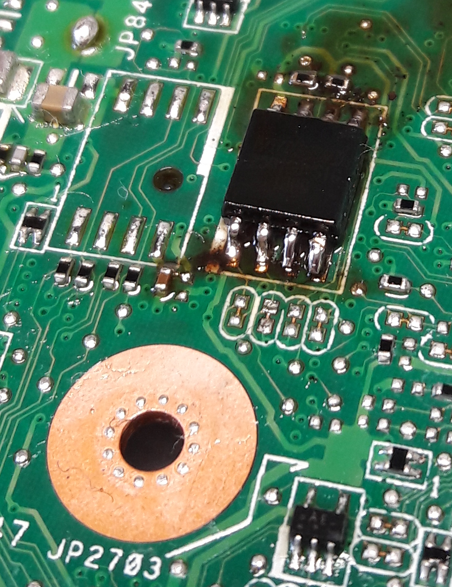

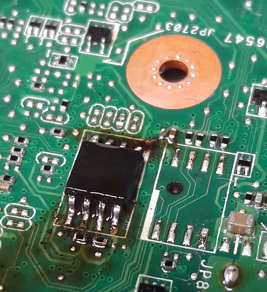

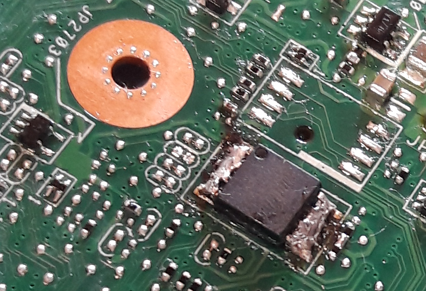

                            • markus24
                              • Jul 2024
                              • 6
                              As I said it's the first time I do this. I tried again, does this look okay?

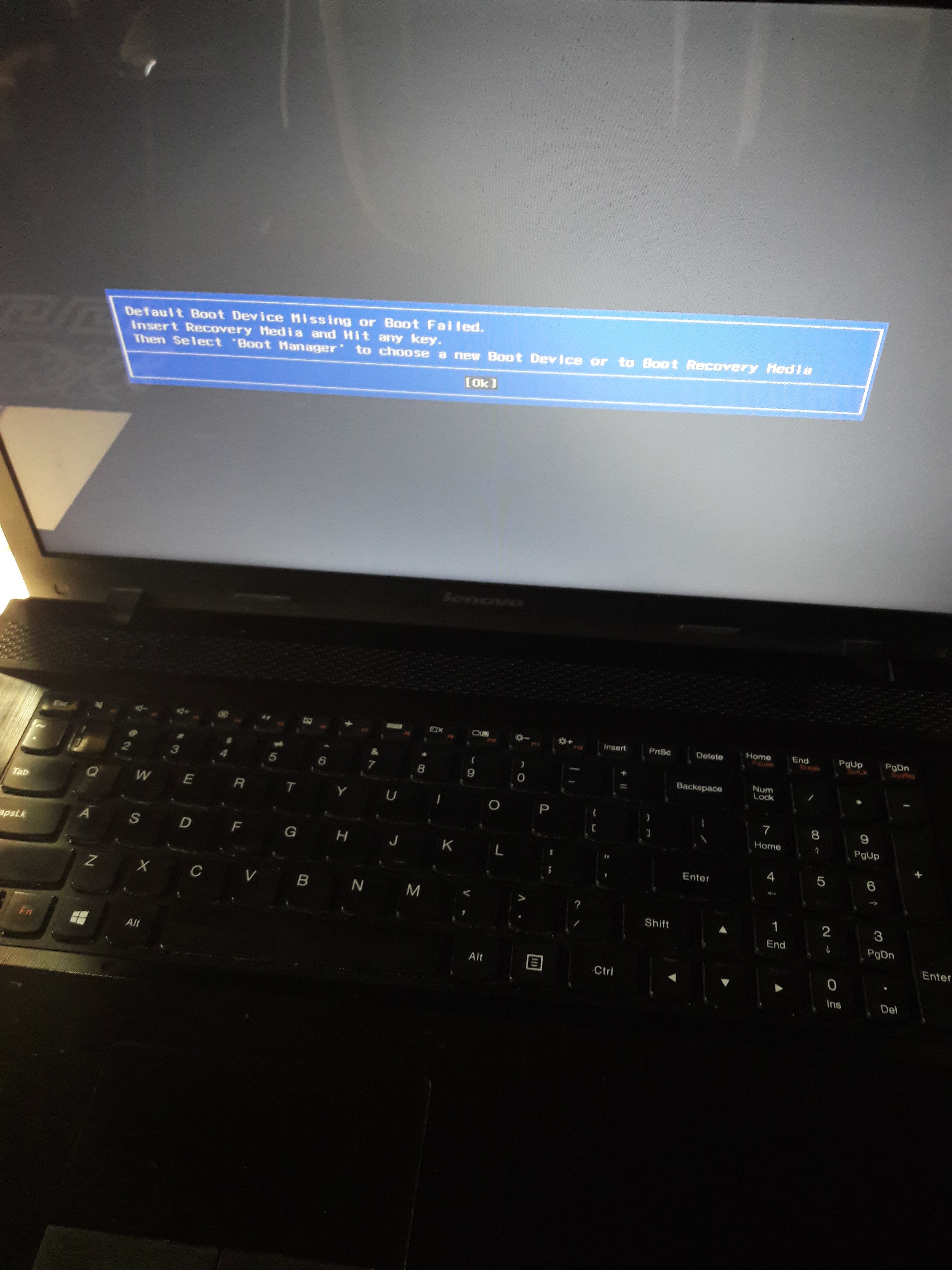

                              • markus24
                                • Jul 2024
                                • 6
                                I got the laptop to work again!, for future reference:
                                I desoldered the W25Q16DV chip and used the CH341A programmer to flash the 2 MB .bin onto it provided by SMDFlea from post #5.
                                Then I resoldered the chip back to the mainboard and thanks to the input of hoaca388 I cleaned up the solder as you can see in post #15.
                                After that I connected the CH341A programmer with the W25Q32FV chip and flashed the 4 MB .bin onto it provided by SMDFlea from post #5.
                                I put the laptop back together and it worked again
                                I installed linux mint after I took the attached picture x)
                                Thanks to SMDFlea, peste and hoaca388 for the help!
