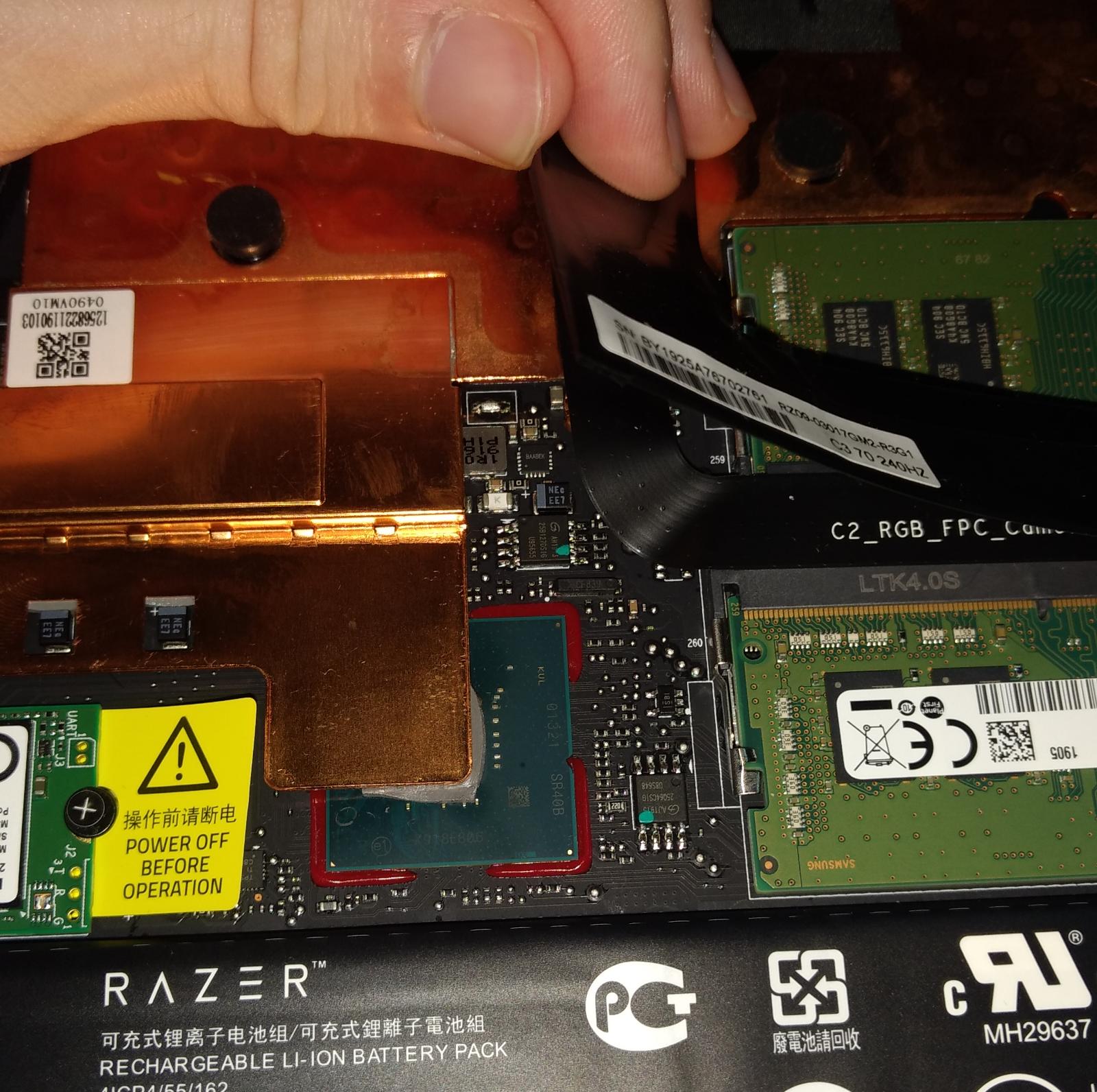

    Hi i need help whit one think,
    While updating the BIOS, windows crashed, the pc does not turn on, only the keyboard turns on the light and the screen does nothing. I guess if I restore the bios it will work, I have bought a CH341a programmer, but the problem is I can't find the bios chip on the board.
    The pc is a RZ09-03017GM2 (razer blade 15)
    Where is the bios chip ? whit this programmer i can recover my pc ??
    I bought the pc 10 days ago, I'm desperate
    Even if you don't know where it is, does anyone know what the chip is like?
    Thanks !!

    next to PCH right side 6 legs IC if you bought the PC 10 days ago you should have the guarantee , to flash bios you need a tool do you have the skills to do it ?

      Thanks, I bought the used pc, not brand new, dont have guarantee...
      for that reason I need to fix it myself or the pc will be useless
      I need to know that there is any option, I have bought the CH341a programmer because I think it may be worth it, but I don't understand much about this
      If you could help me, I would really appreciate it
      EDIT:a photo of what I think is the PCH

        That is the bios chip,the one with the small bit of paint GD25B127. If your CH341A is the black pcb version it might need modifying. Check if its output is 5V ,if so then do the 3.3V mod - https://www.chucknemeth.com/usb-devi.../3v-ch341a-mod ,there are youtube videos too and lots of other info about the mod if you search.
        Did you get a sop8 clip with the programmer ? ,are you planning on using that or desoldering the chip ?.You can use a clip but your results may vary in getting a good read /write.

          Thanks!! Yes my ch341a is black pcb exactly this model https://www.amazon.es/gp/aw/d/B07RKX...b_b_prod_image
          Yes the programmer have a sop8 clip, i prefer use a clip for this, because if will be necesary i desoldering it
          I need one more thing, what is the program i will need for reprogram bios??

            The CH341A software doesn`t support the GD25B127 ,use NeoProgrammer or AsProgrammer instead,although they don`t support it either you can choose GD25Q128 manually to read/write, and Neo/ASP is more stable software .Its recommended that you make 2 backups,check them with a hex editor to make sure theyre both the same, if not then atach the charger to the laptop then try again.If you can`t get 2 good backups then desolder the chip. The latest bios version is attached. Good luck
            https://www.badcaps.net/forum/showpo...04&postcount=7 NeoProgrammer
            https://www.badcaps.net/forum/showpo...6&postcount=10 AsProgrammer

              incredible, really, very grateful, tomorrow the programmer comes to me by amazon and I start with it, carefully and doing my best !
              When I'm done I'll write the result here, sure that's good
              I will use the AsProgrammer

                fixed up!!! This morning the programmer arrived, I made the mod, I verified the 3.3v, carefully I put the clamp, read the bios, made a copy, programmed the new bios and it is already working!
                Thank you very much for the help and advice, you are very great !!
