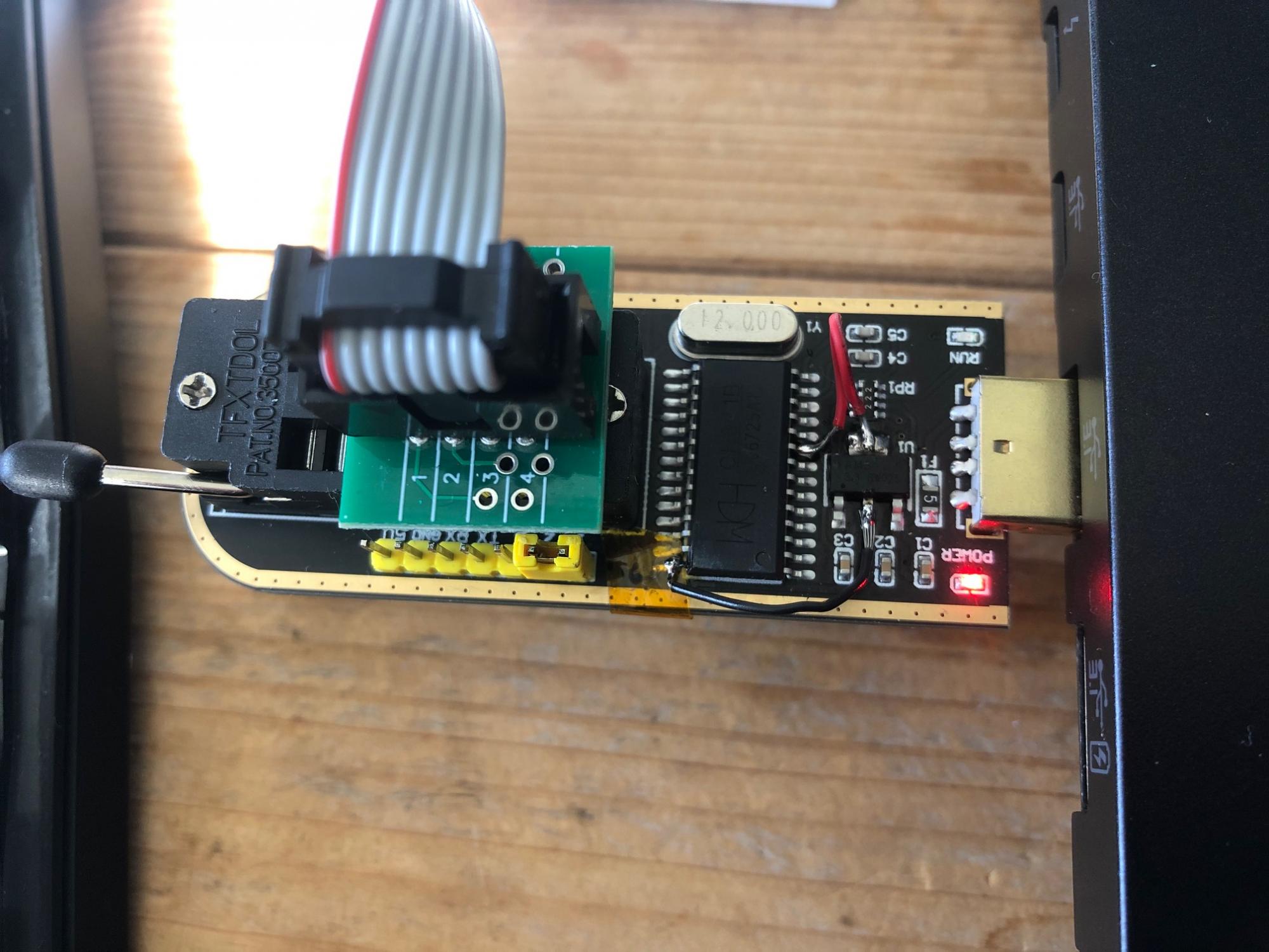

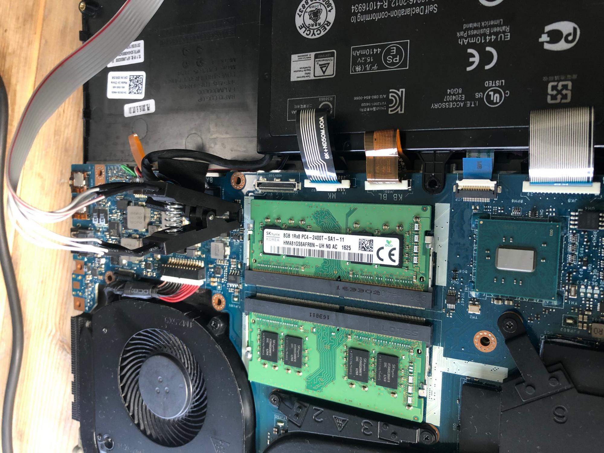

        Re: alienware 15 r3 La-D751p bios fix
        Originally posted by SMDFlea
        Desolder it if you can,its the most reliable way. You have some adapters for it ? . Do you have the ch341a black edition,can you check the voltage and make sure it hasn`t got 5V on pin 28.You may need to modify it so it only uses 3.3V https://www.chucknemeth.com/usb-devi.../3v-ch341a-mod .Its possible to flash the EC with the ch341a you`ll need to solder wires to the JEC connector.
        ive done the mod, i read 3volts on all pins but still i cant read the EC chip for some reason.
        foto to mod:
        Im not 100% sure this is the IC chip, can u confirm ?
        Foto to connection EC:
        if i plug programmer into usb and quickly press read id. it reads id, but on reading nothing. writing nothing
        battery is disconnected / power plug disconnected/ motherboard battery disconnected
        Thanks!

          Check the part number on top of the chip, then do a google search with that part number to make sure it is a bios chip. Look in the schematic as well,search for SPI .
            Thanks for ur answer once again, i have got the schematic
            But if i press ctrl+f and type SPI. i can only find the 128mbit ( 25b128cs1g )
            i cant seem to find the EC in the schematics ?
            if i check the other chips under the microscope i can see 2 chips with 80,
            25q80csig.
            (https://datasheet4u.com/share_search...Word=25Q80cSIG)
            and on another location at the motherboard 25q80dvsig.
            ( https://www.datasheetq.com/datasheet...ond/25Q80DVSIG )
            the one where i tried to read and flash is the 25q80csig.
              • 22278
              25q80csig.
              The GD25B128C is the bios chip. Notice the Mb ,the capital M means Mega,and the lower case b means bits. Divide 128 by 8 to get 16.Its 16MB ,with a capital B for bytes, MegaBytes.
              https://cdn.badcaps-static.com/pdfs/...75588d6e59.pdf
              GD25B128C 128Mb 2.7V-3.6V 128Mb = 16MB .Bits and bytes are all confusing.
                haha alright i might have figured it out 25q80dvsig is the one i can read and write. i saved the original and flashed the 1.8 now on it including bios 1.8 on the bios chip. il test now and report back
                  • 22278
                  See post #18 posted a few moments before yours. If you made a backup of 25q80dvsig flash it back and leave it well alone.The bios chip in the schematic doesn`t always match with the part number on the board,U4 is the bios chip W25Q128FVSIQ in the schematic.
                  The 25q80 chips are for the thunderbolt firmware and gpu bios .

                    yes but i was looking for the EC chip. i believe i found it 25q80dvsig
                      alright done, flashed back original. than where shud i flash the EC to ? also on the bios chip ?

                        with just the bios flash the laptop gives 2 red lights, 1 blue.

                          I said at post #11 the EC can only be flashed through the JEC connector. Whatever you just flashed i hope you made a backup, flash the backup back onto it and leave it alone.Just flash the 16MB bios to the 128 16MB bios chip the GD25B128CSIG

                            alright thanks , thats clear now. no EC flashing for me.
