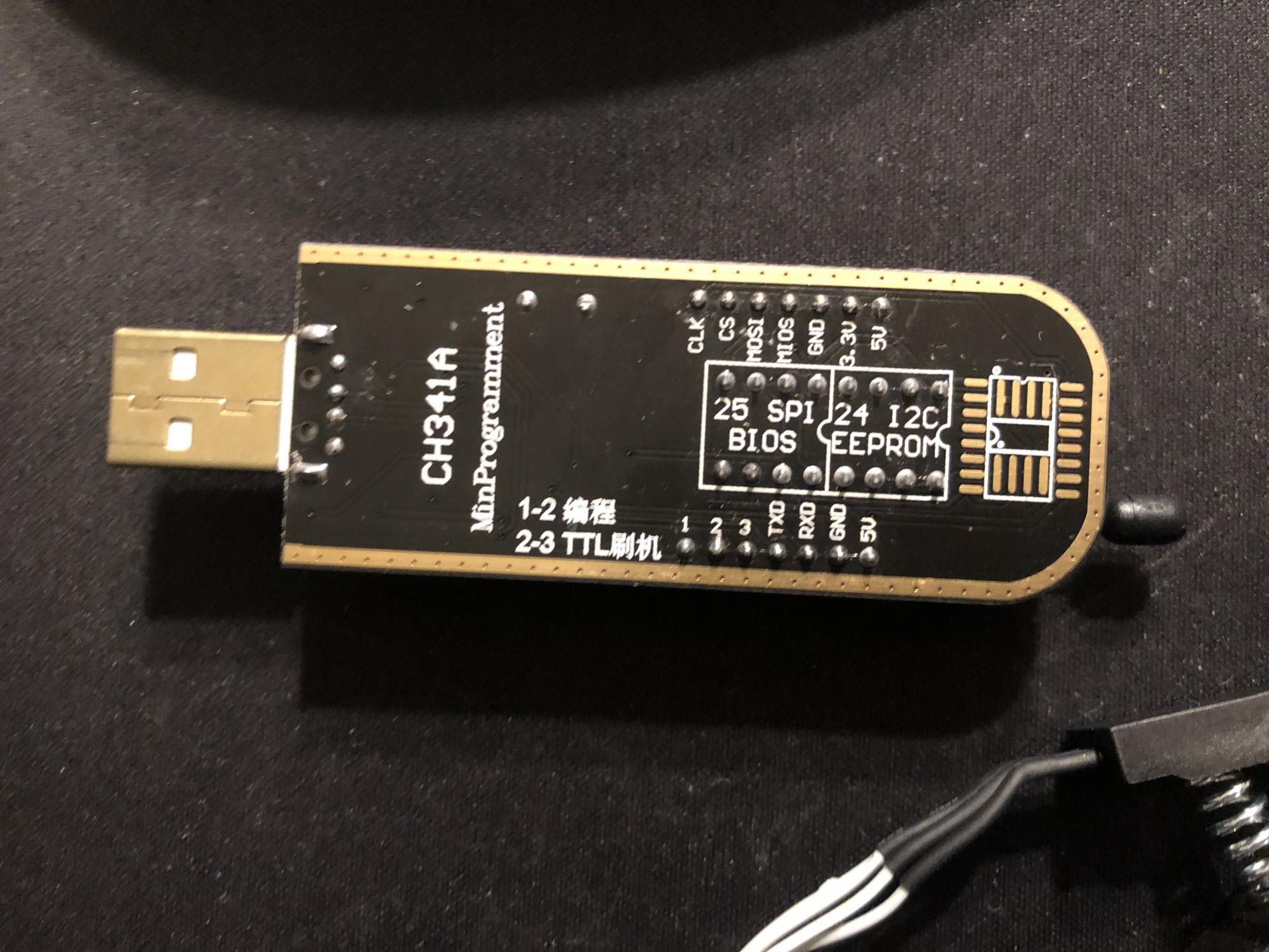

                  alienware 15 r3 La-D751p bios fix
                  Hi guys i need a bios fix!
                  Thanks in advance for helping!

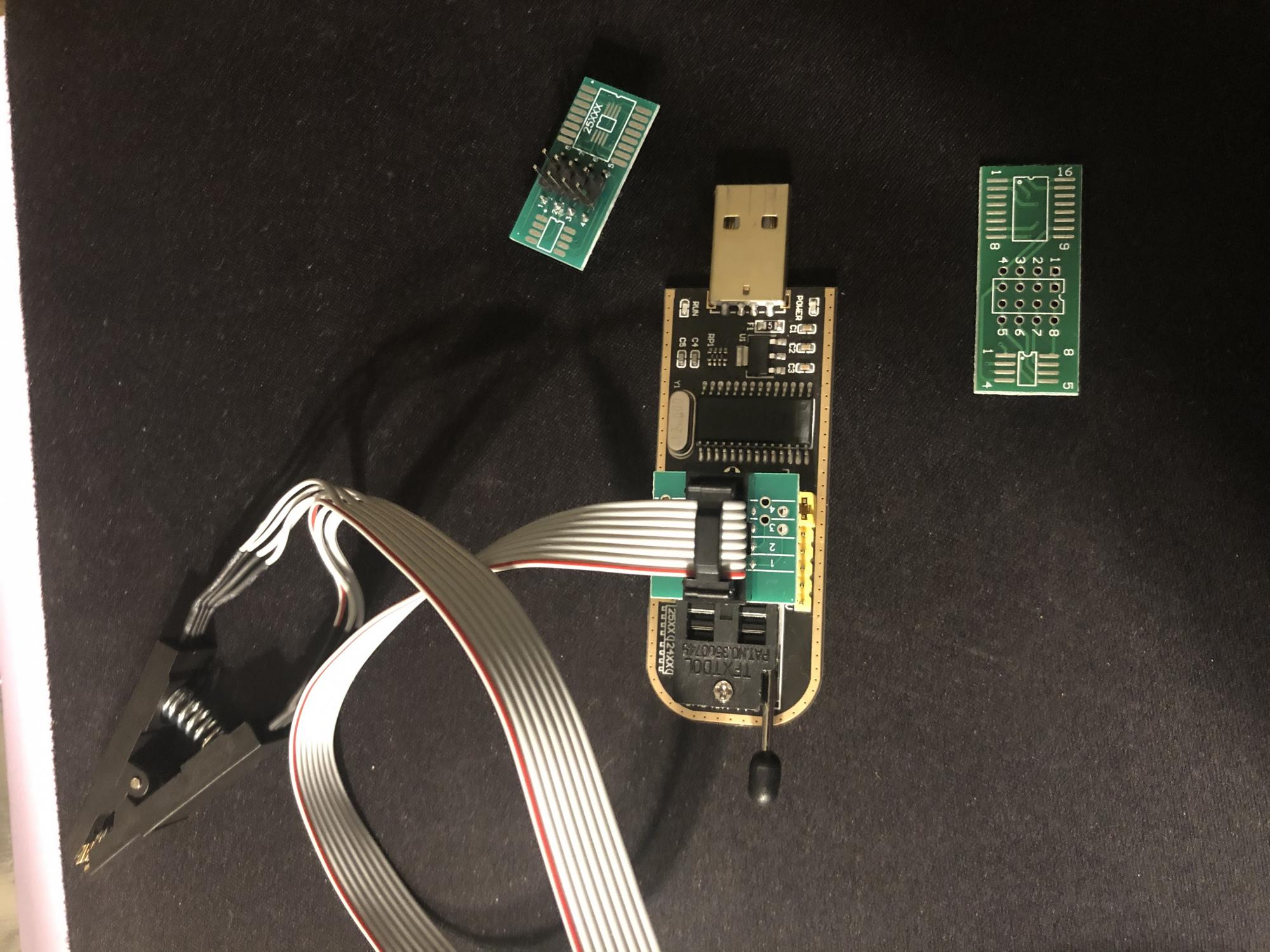

                        • Pfudaniel
                          • Feb 2021
                          • 91
                          • Netherlands
                          Re: alienware 15 r3 La-D751p bios fix
                          Originally posted by SMDFlea
                          Try these.Flash the EC as well if you have a programmer for it.
                          thanks ! yes i got ch341a programmer, this is fine for it yes ?
                          please check my post in laptops, can u point me out wich is the EC to flash ?

                              • 22077
                              Originally posted by Pfudaniel
                              i flashed bios, also give 2 red 1 blue light.
                              not sure how to flash EC. I connected the ch341a programmer and chip is recognized but on reading it just gives F only. not sure i shoud write in that case..
                              Use NeoProgrammer or ASProgrammer software
                              https://www.badcaps.net/forum/showpo...04&postcount=7 NeoProgrammer
                              https://www.badcaps.net/forum/showpo...6&postcount=10 AsProgrammer
                              • Pfudaniel
                                • Feb 2021
                                • 91
                                • Netherlands
                                yes i use ASprogrammer
                                  • 22077
                                  Try NeoProgrammer. Are you using a clip or have you desoldered the chip
                                  • Pfudaniel
                                    • Feb 2021
                                    • 91
                                    • Netherlands
                                    with neopgrammer same, i can identify chip but not read or write. im using clip, the clip working fine on the bios chip. can u confirm EC chip is UE2. foto is on my topic from laptops forum.
                                      • 22077
                                      Desolder it if you can,its the most reliable way. You have some adapters for it ? . Do you have the ch341a black edition,can you check the voltage and make sure it hasn`t got 5V on pin 28.You may need to modify it so it only uses 3.3V https://www.chucknemeth.com/usb-devi.../3v-ch341a-mod .Its possible to flash the EC with the ch341a you`ll need to solder wires to the JEC connector.
                                      • Pfudaniel
                                        • Feb 2021
                                        • 91
                                        • Netherlands
                                        Yes i can desolder no problem, thanks il look into that link. Yes its black edition i think. Attached foto, this is included adapter?
