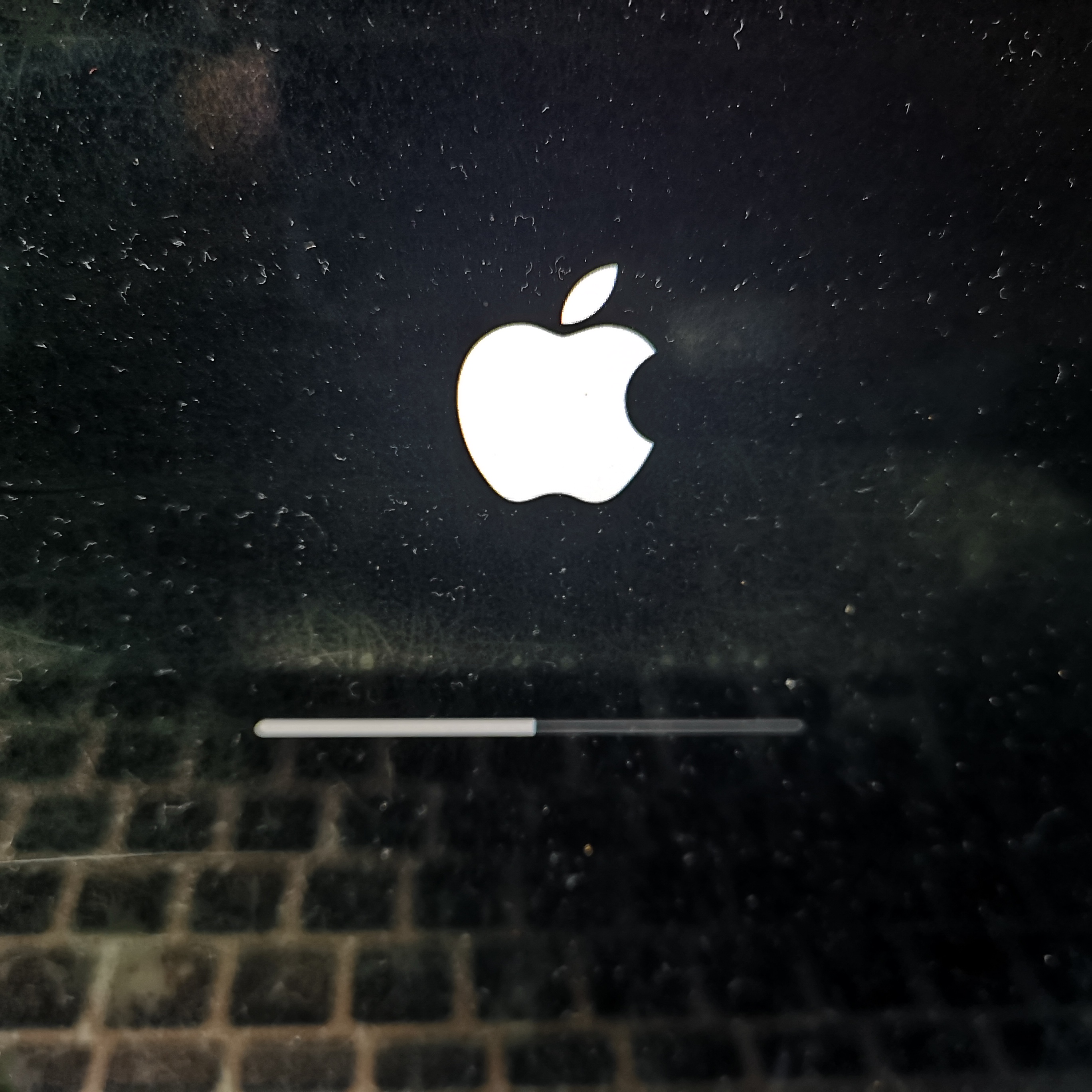

    Hi.I'm attending to install OS on this mac ,which stuck on logo whit installation
    bar.After 5-10 min. goes in sleep mode.Starting after any pressed button but
    nothing on this screen.
    I've written another bios which i clean via Apple EFI patcher.
    I've tried from external hard and from internet both same.
    SSD is working ,i install it on another MAC .Here is my original bin.
    Can i have a help to solve the issue please.
    Thank you.

      Thank you for your answer.With this file is same.Stuck at middle.In 10 min screen goes off ,fans still spinning ,usb drive led is ON and nothing on the screen.10 min more goes off complete.

          Thank you for your answer.With this dump file getting slow cheam coming too late ,fans spins with max speed and nothing on the screen.Probably could be hardware issue but i don't have any clue what can be.

                It came with this problem.It wasn't water damaged or any repairs on it.I did
                ME region clean fallowing your instructions on the youtube video.
                When i'm checking my original dump how as you mentioned on flashimage tool i have some error and yelow marked row "BOOT GUARD PROFILE CONFIGURATION " is unknown maybe this is not normal to be.I'm sending pictures of the errors.Thank you.

                            Same no any changes.Thank you.

                                  Same .Thank you .Applesupport.com/-5101f from internet
                                  and half installation from external hard.

                                    came across this one the problem is the SMC balls being detached on the ME bootstrap circuit. not enabling ME in the BIOS. check ME Bootstrap also.
