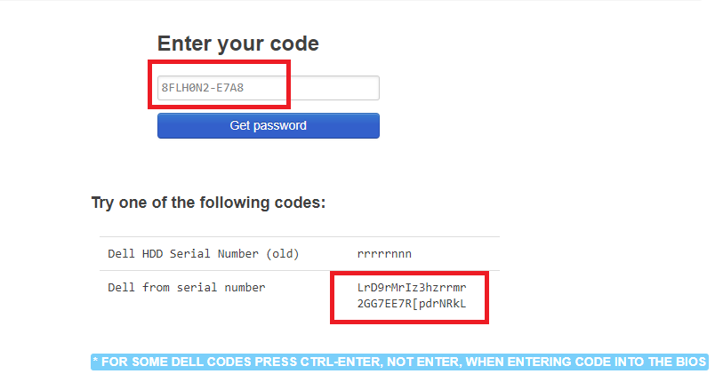

    Originally posted by hoaca388
    Click image for larger version  Name:	2025-04-05 16_24_49-BIOS Master Password Generator for Laptops.png Views:	0 Size:	19.3 KB ID:	3608230
    Unfortunately, these passwords do not work.

      Originally posted by olegzum
      Dell Precision 5520, LA-E331p rev 2.0, S/T: 8FLH0N2
      password prompt code: 8FLH0N2-E7A8
      #99
      • olegzum
        • Apr 2018
        • 8
        • Ukraine
        #103
        Dear lapfix, thank you very much for your help. The password has been removed. You are a better specialist than me. I periodically encounter the need to remove the password. Can you tell me where I can read how you do it - remove the password from the BIOS dump

          #104
          Easy..compare th 2 bios and you will find the way.
          save it and do the same with other suffix
