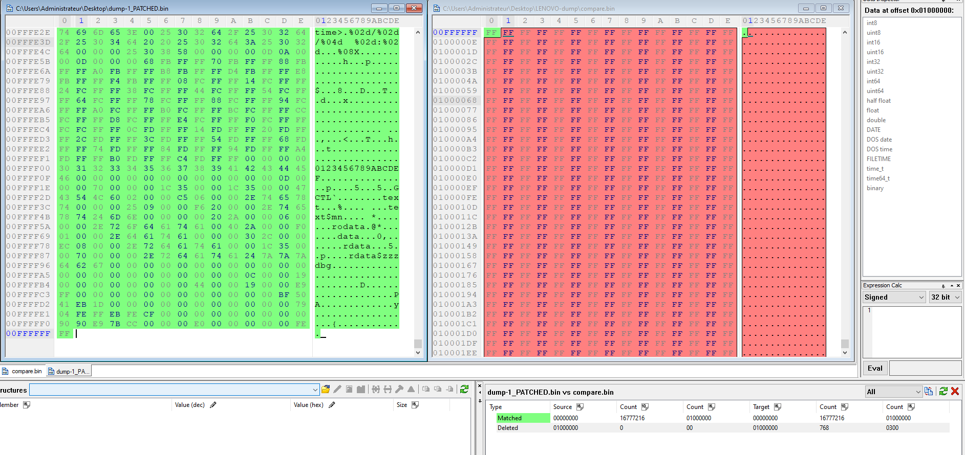

                    • zak53
                      • May 2018
                      • 18
                      • Z
                      #30
                      Re: THINKPAD L390 password
                      Hello guys, i patched the bios dump, but no success melody with black screen can someone please help me

                            • zak53
                              • May 2018
                              • 18
                              • Z
                              #34
                              Originally posted by onizzbox
                              @zak53
                              Yes, it is possible to unlock it using my Autopatch. Post the BIOS with 32Mb
                              there is two chips BIOS 1 W25Q128JV, and BIOS 2 25q80dvsig
                              here is the dump of the BIOS 1 W25Q128JV

                                • zak53
                                  • May 2018

                                  i flashed the chip, but when i compare the patched dump with the programmed one it's not the same there is a deleted part as you can see in the screenshot
                                  I removed the chip from the mother board and i use XGPRO TL866ll PLUS

                                    • zak53
                                      • May 2018
                                      • 18
                                      • Z
                                      #38
                                      Originally posted by Bsolution
                                      this is patched
                                      Yes, i don't know why the file is not the same after the flash
                                      • zak53
                                        • May 2018
                                        • 18
                                        • Z
                                        #39
                                        I managed to flash the patched dump with a good compare, but still the same melody with black screen
                                        When i put back the original dump the laptop work fine, but with password
