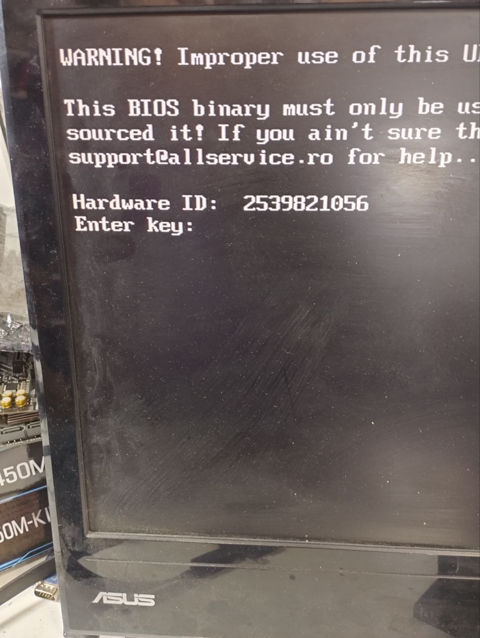

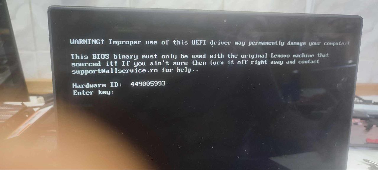

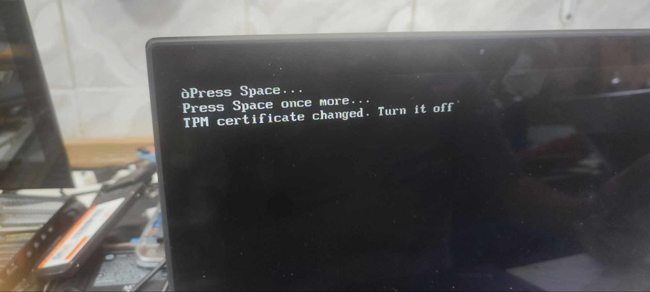

                      Sure, do it and follow the sequence to remove the password:
                      • Boot the machine
                      • Press ENTER/F1/etc. to enter BIOS settings
                      • Enter any character when asked for Supervisor Password
                      • Press enter when it shows Hardware ID
                      • Press space bar 2x when asked
                      • Turn off machine
                      • Restore original BIOS
                      • Reset BIOS settings to factory default

                          You are a blessing to badcaps... It work perfectly..
                          thank you so so much from my heart..
                          i sincerely appreciate.. A BIG THANK YOUUUU
                          You're welcome, enjoy your unlocked laptop.

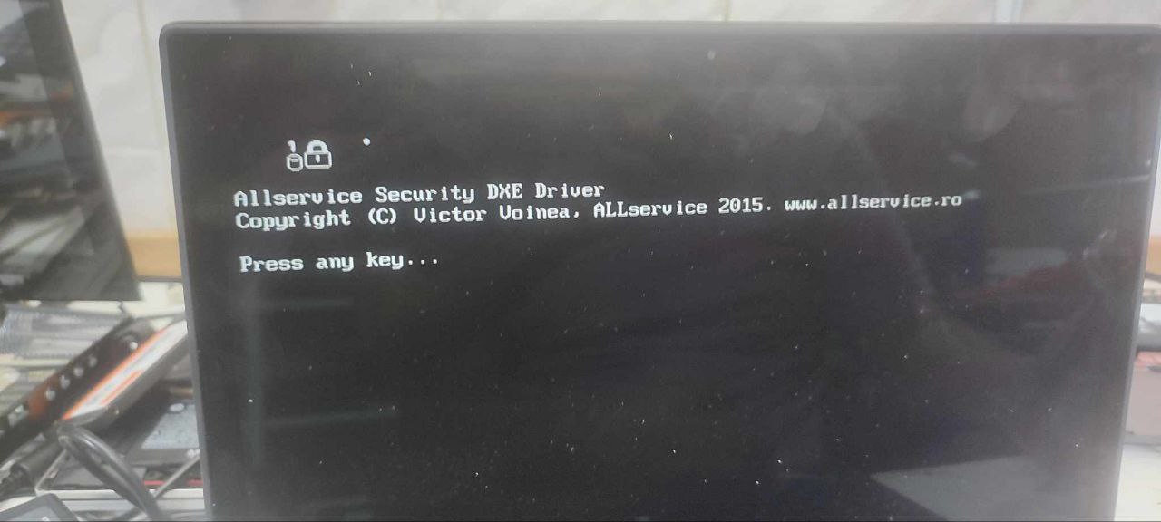

                              • Boot the machine
                              • Turn off machine

                                #135
                                Re: THINKPAD L390 password
                                Originally posted by Vesko356
                                after Restore original BIOS the password remained
                                  You must follow shown sequence to remove the password, did you do it exactly as described?

                                      #138
                                      Yes, I did it step by step
                                      Most probably you make a mistake at some of the steps. Start over, take a screenshot of each step to see what's happening.

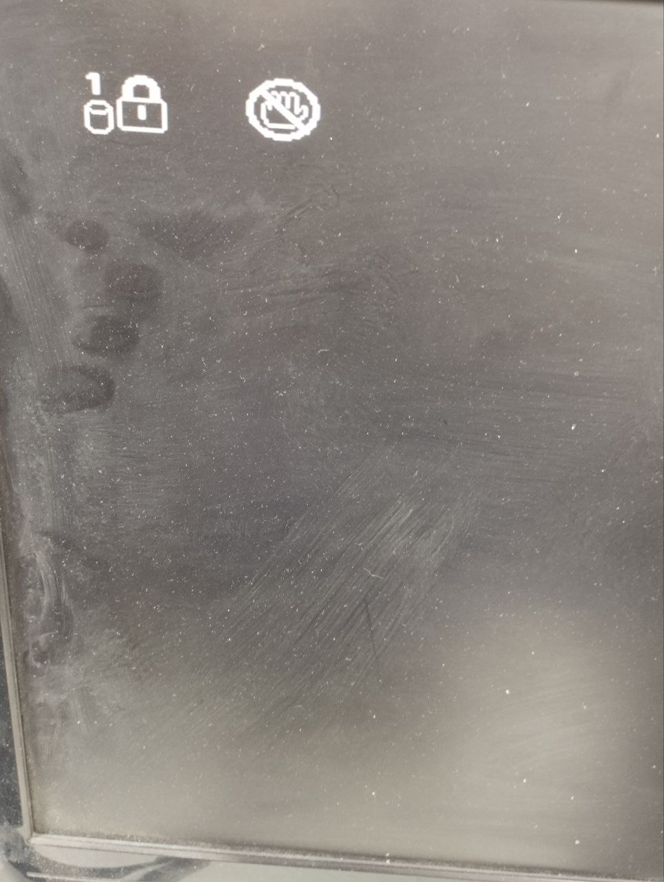

                                          #140
                                          Hello, like the second picture, it is an HDD password and not an SV password.
                                          https://superuser.com/questions/1480...known-password
