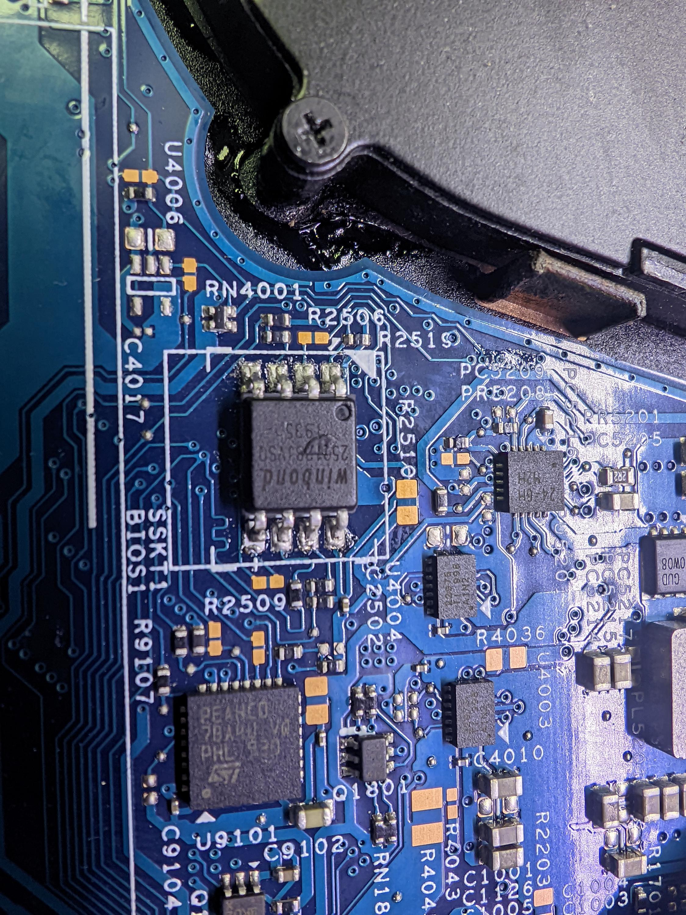

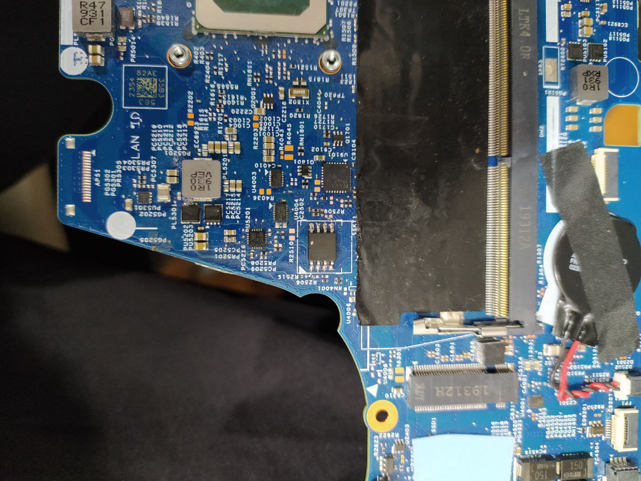

                  THNKS, I think that I lost one of the resistors around the bios chip if anyone can confirm that

                    I haven't read your post before I went on the same path as you have you found any solution ???
                      picture from bios

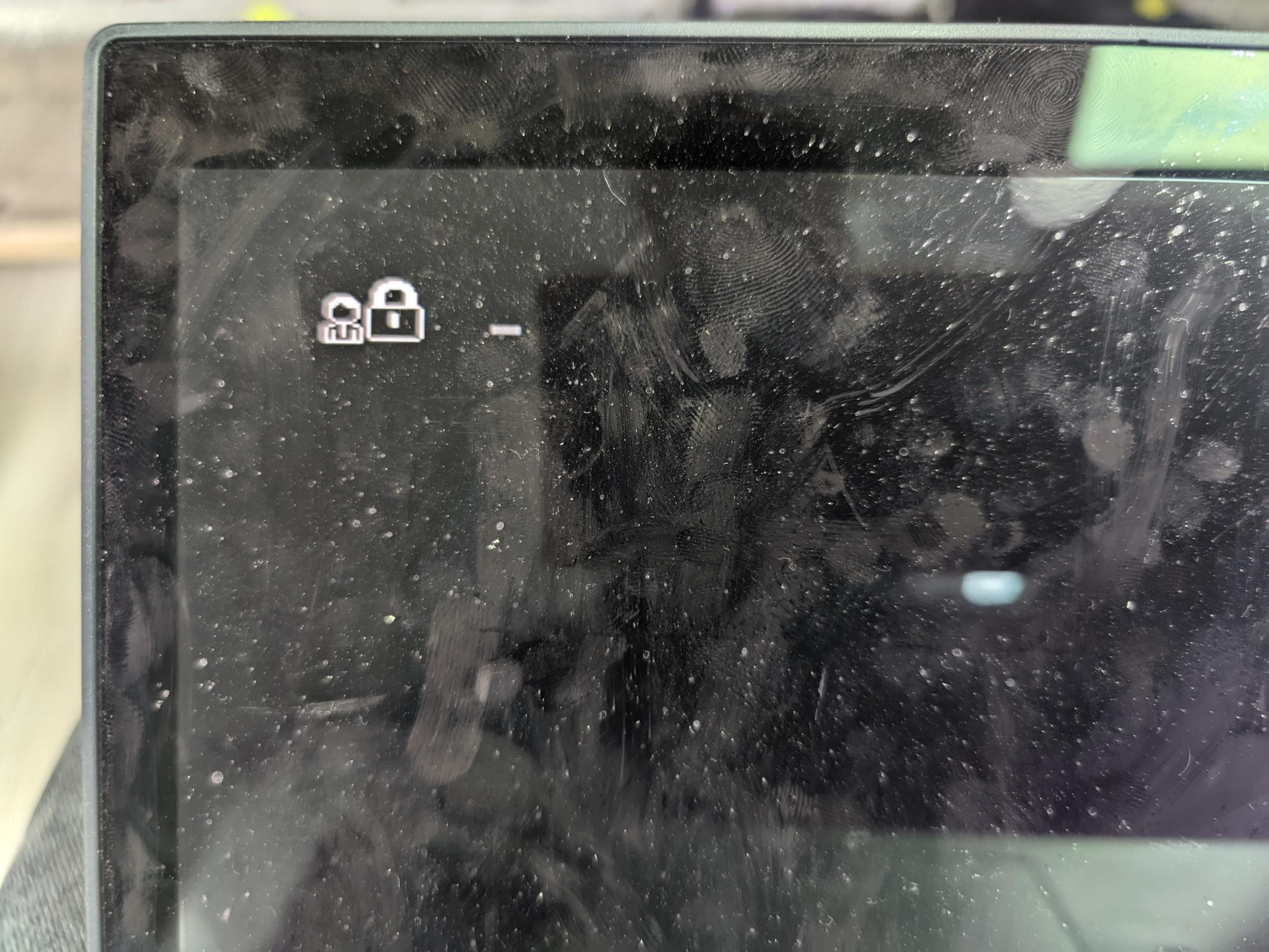

                                you must learn how to use patch file
                                [ HOW TO USE THE PATCH ]
                                STEP 1: Flash and replace current BIOS with the generated patch file
                                STEP 2: Boot the machine
                                STEP 3: Press ENTER/F1/etc. to enter BIOS settings
                                STEP 4: Enter any character when asked for Supervisor Password
                                STEP 5: Press enter when it shows Hardware ID
                                STEP 6: Press space bar 2x when asked
                                STEP 7: Turn off machine
                                STEP 8: Restore original BIOS
                                STEP 9: Reset BIOS settings to factory default

                                  I use autopatch to generate patched bios but my laptop just makes beep sound "011028" and screen stays black without startup. So I flashed original bios back, then my laptop starts booting with password lock. Could help me how to patch my bios file for remove password?

                                    Never mind. I figured it out and unlock the supervisor password. In my case, autopatcher just replaces 2 dxe in bios but it doesn't patch evsa region. So I copied EfiSystemNvDataFvGuid part from dycc's patched file and pasted to my autopatcher patched bios on HeX editor. Then I flashed and rebooted, then Success!!! Thank you so much for your great job. You guys are genius!!!
