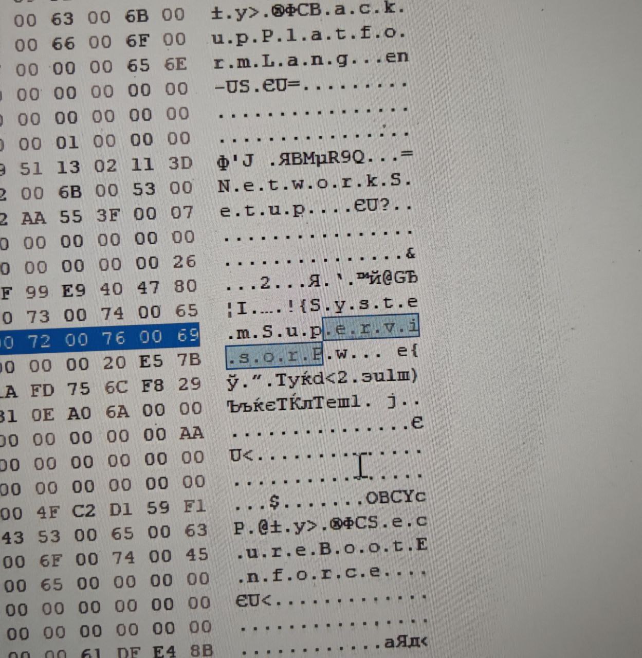

    it seems to work with this method, but i have an ñ before aU and i´m not able to input this character with the us keyboard
    so i´m still locked out. any ideas how to fix this or flash a bios version with the password removed?
    Post a picture of the screen with the S.y.s.t.e.m.S.u.p.e.r.v.i.s.o.r.P.w code

      Re: Xiaomi Mi Notebook Pro 15.6 [BIOS password / BIOS dump]
      i just fixed it with a downgrade to the XMAKB5R0P0906 version where u can edit the platform.ini file and force a password reset by setting some flags

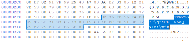

                  Guys, could you please help me with decoding BIOS password?
                  I've created dump with FTWP64 but can't decode the password
                  I have no idea about correct symbols, hope you can help
                  HEX Code: D2 76 FB 56 FA BD 95 45 5C 71 93 65 43 80 15 60 4E FC E0 51 0E 12 25 B2 75 B3 5C E6 5E 83
                  "Decoded" text: ТvыVъЅ•E\q“eCЂ`NьаQ%Іuі\ж^ѓ
                  BIOS backup attached
                  Thanks in advance

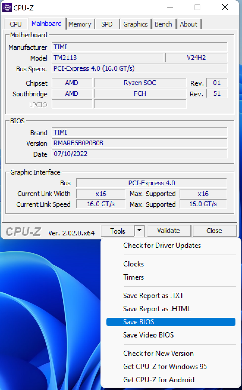

                    I disabled BIOS "SECURE BOOT" required by Ventoy to install OS, then I just F10 exit BIOS. I dID NOT enable any BIOS password nor tamper other settings, just straight exit BIOS. Now the BIOS ask me BIOS password which I didn't setup in the first place. (I still can normally boot into Windows, just CANNOT enter BIOS anymore).
                    To make matter worse now I also couldn't boot from USB flash drive (which usually present when press F12). Now when press F12 the ONLY boot option available is boot from INTERNAL SSD.
                    I've tried following methods to extract BIOS file to no avail:
                    - FPTW64.exe
                    - Universal BIOS Backup ToolKit 2.0
                    by chance I saw on CPU-Z got "Save BIOS" feature (see attached image), thus I attached it here hopefully it is the BIOS file needed.
                    Anyone can help me clear the BIOS password?
                      Your text file runs down to 10000h, which corresponds to 64KB, it is way too small to be a complete BIOS bin, should be something like 8,192KB or 16,384KB.
                      First time I have seen a bios as a text. You should see something like 7FFFF0 or FFFFF0 at the last line.
                      Please try again.
