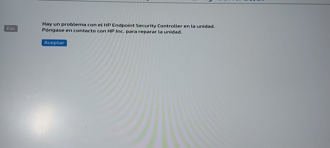

    Re: Need unlock HP ProBook 640 G5 8TH
    could you help me unlock this bios
        Originally posted by peste
        try..
        the backup copy was bad with that one it doesn't turn on I got this one but an error message appears attached to the image of the error to see if you can help me solve it thanks
          Enter the bios and restore the security settings to defaults and restart the laptop
            I already did it but it's still the same the message is not removed
              can someone help me to remove this error
                Flash both files. In the first boot, you have to go into bios setting for disable all the security options ( go back default setting ) , then you have to manually restore the MPM information such as serial number, product number...
                If you are having trouble recovering your MPM information, try contacting @Rediii and ask for his help.( https://www.badcaps.net/forum/showthread.php?t=103074 )
                  but that is from elitebook 840 g7 mine is probook 640 g5
                      it did not turn on if you checked the 16mb one what happens is that the backup was saved wrong
                        I put this and it worked but the hard drive is not detected
                          This is the EC file. If it worked for you, read the bios file again and post it here. But is your device 840-G7 or 640-G5?
                            It is the one you published in publication # 27 mine is probook 640 g5
                              Please read the current bios on your device and post it here.
                              There seems to be some confusion about the model.
