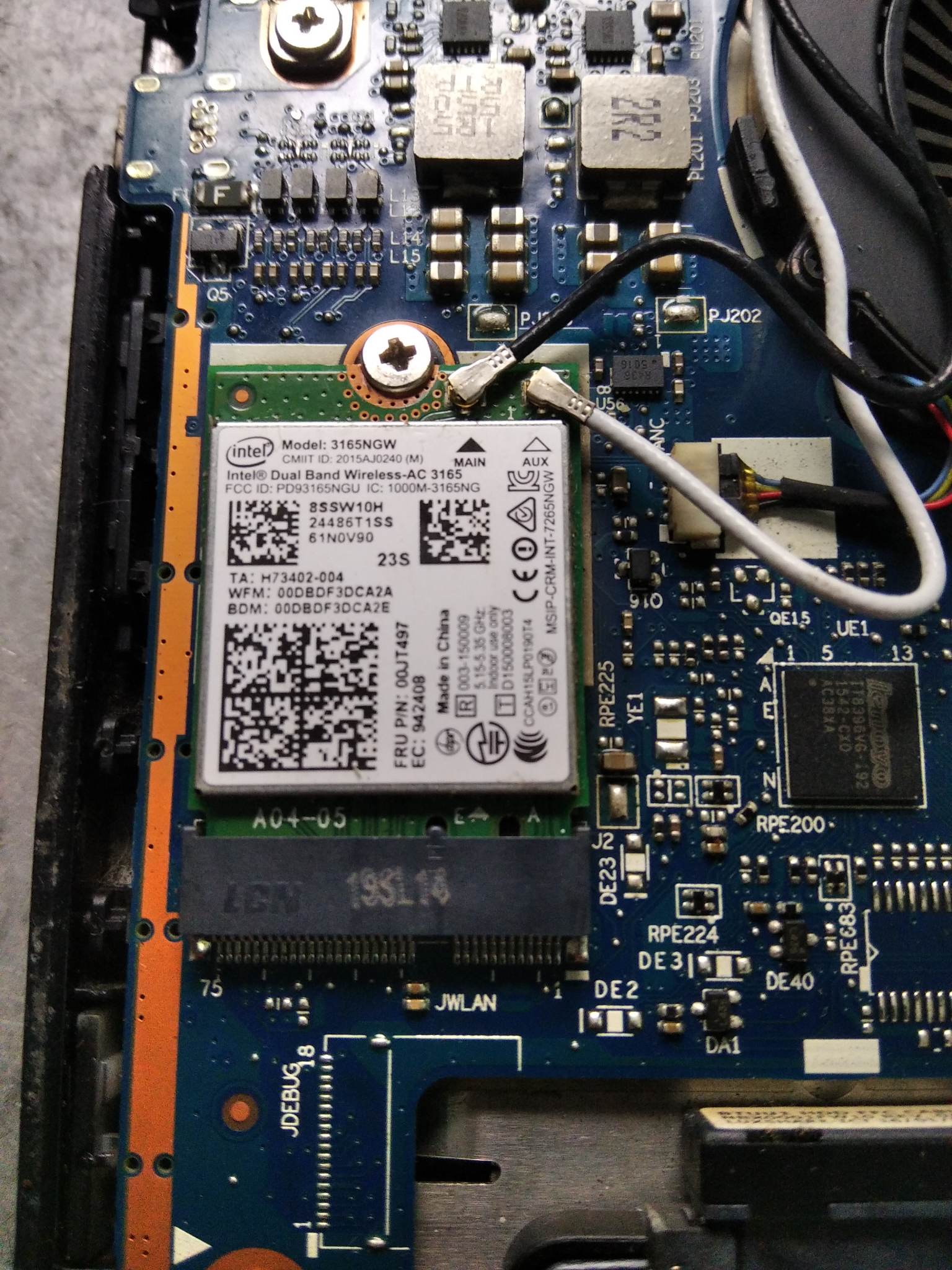

                  Re: Need Bios Dump Lenovo Yoga 700-14ISK
                  Problem with Lenovo Yoga 700-14. 4 beeps after starting, no display, I uploaded from the forum, the picture is not detecting the wifi network card, I uploaded for lenovo srtons and still no wifi card, please no one help, best regards
                    post the full name and model and serial number
                      model yoga 700-14isk i7 6500u gt940m problem wifi , Regards
                          after uploading the bios from the forum, I have this sn PF0F1R45 sticker on the housing is worn off
                            Is it the original wifi card or has it been changed.Will the laptop boot without it
                            • andrzej1122
                              • Jul 2018
                              • 10
                              • Polska
                              #34
                              Yes it boots without it, intel 3165NGW card
                              • andrzej1122
                                • Jul 2018
                                • 10
                                • Polska
                                #35
                                the AC3160 network card is also not detected,bluetooth ok
                                  • 22293

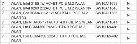

                                  #36
                                  The bios has a whitelist which only allows certain cards. See the picture for the FRU part numbers,you can find them in the hardware maintenance manual.
                                  Try the attached bios. If the card is the genuine one and it still doesn`t work after flashing the bios you have some other hardware issue.
                                    my original
                                      my original
                                      Its a genuine card as it has the FRU on it.Even so,the card could be bad.There is nothing wrong with the bios,if you want more help with hardware post a new thread here -> https://www.badcaps.net/forum/forumdisplay.php?f=23

                                        #39
                                        Thank you, it's ok. Regards
