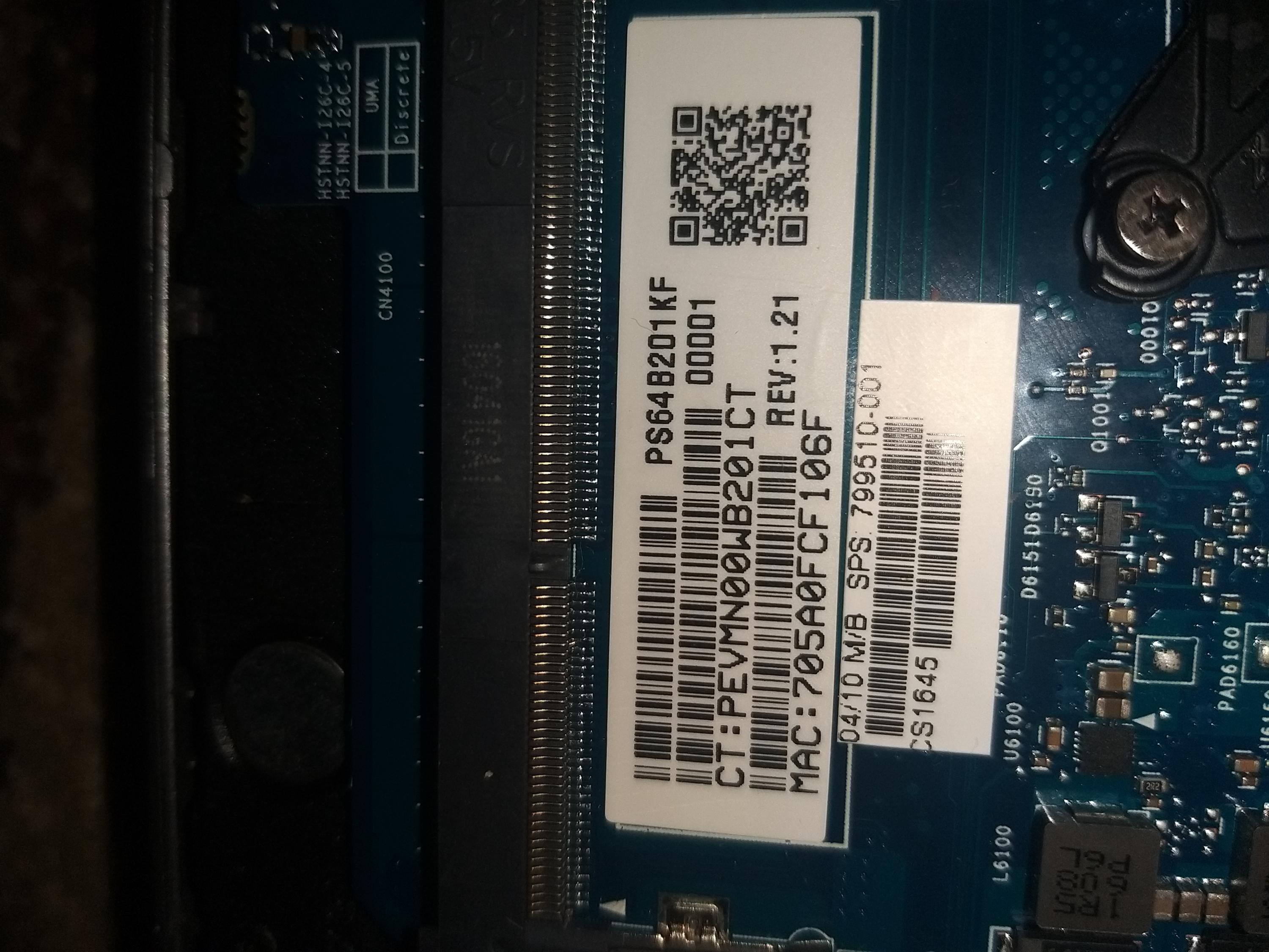

      what model of motherboard does the laptop have ??

        This is picture
        is this enough?

          Re: 840 G2 Machine Is Not In Committed State
          Originally posted by tinto
          This is pic
          the model is written on the white paint plate.
            6050a2637901-mb-a02

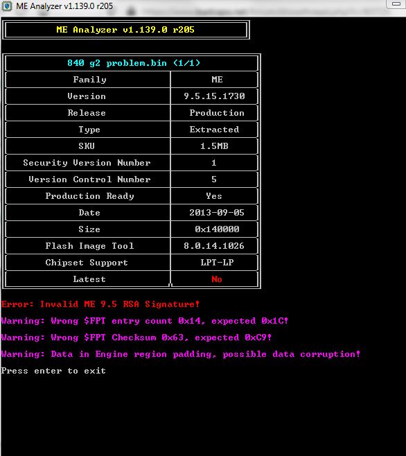

                • 22012

                No it wasn`t a virgin bios.The error was corrupt ME firmware.It has 1.5MB consumer FW as well. All the other dumps here have corporate FW,whether or not AMT is commited or not, so i assume someone has tried to clean the ME FW with "Easy Clean" or something and used the wrong FW .
                  SMDFlea
                  I don't have virgin bios file ,i don't have nothing...
                  I have laptop without bios chip, and i use NEW bios chip,program some 840 G2 dump file from forum, and solder
                  I try
                  And laptop is power on,show picture,work fine,but it writes Machine Is Not In Committed State
                    SMDFlea
                    I try
                    I know that,i have read the whole thread.I`m pointing out that the dump you tried has corrupt ME firmware,hence the error message you have.
                    EDIT: You`ve asked for an 840 G2 bios before - https://www.badcaps.net/forum/showthread.php?t=90182 ,you could have used that bios with clean ME firmware

                          Yes i just checked,the bios had bid L71 .Rather than correct the title and edit the posts it was easier to delete the whole thread, just so members don`t download it anymore, thinking its an 840 G2 bios.... ,if you can post a link to the corrupt bios you tried i`ll delete that post/thread as well.
                          Try the bios posted by @peste at post # 7
